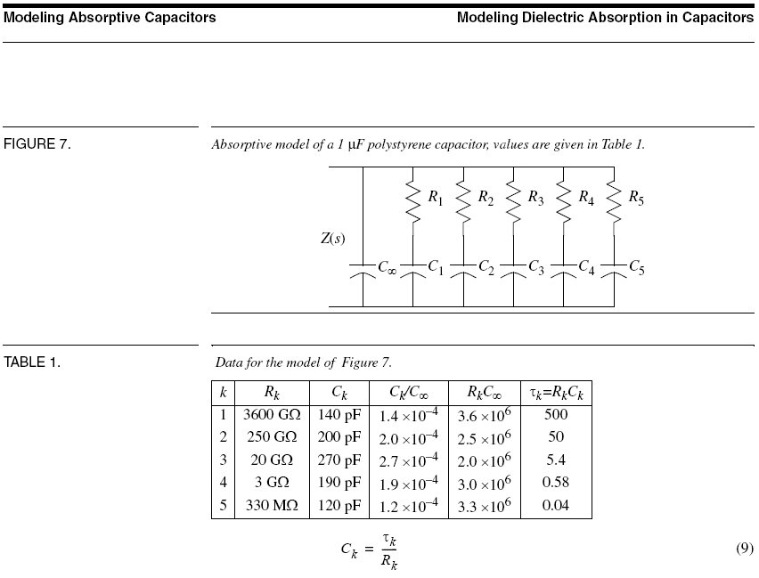

http://www.designers-guide.org/Modeling/da.pdf

point out that dielectric adsorption has a very successful linear model that doesn’t affect audio signals (sub ppm linear freq response variations vs the "pure C" model in most continuous filter applications)
no good theory linking da with distortion - do you have the ability to measure even polystyrene distortions?
a big issue is water, water is polar, has huge dielectric constant and everything absorbs water, papers/fabrics of organic fibers adsorb multiple percent - water even diffuses through oil impregnants - you'll need to vacuum bake to dry and then hermetically seal any of your experiments to avoid absorbed water dominating the dielectric effects as you try to go lower

Right. DA has been made into a huge Bogey Man, and it is in certain applications such as sample and hold circuits. But I haven't seen anyone demonstrate that it affects analogue audio signals in any appreciable way.
I'm beginning to think it's the case of the Bogey Man that wasn't there.

The National article by Bob Pease does in fact say the soakage (DA) can be a detriment to AC coupled amplifiers.
Steve Bench also has some convincing tests on his website... with REAL data. Paper in oil showed the best results... hmmmmm.
I agree that much more "non-ear" testing needs to be done; but this looks real.

Based on polarization/dielectric constant considerations for minimization of dielectric absorption, the best films for audio applications are teflon and polypropylene. Runners up would be polyethylene and polystyrene, based on these considerations alone. Throughout this discussion, I have assumed that dielectric absorption and the dielectric constant are directly correlated.
Apparently, when polarizability factors predominate, the time constant for relaxation of the field induced dipole is critical. Otherwise, one would expect polypropylene to have a lower dielectric absorption than polystyrene, which is not the observed result. This can be reasoned by re-examining what is being polarized by the field in each. In the case of the polystyrene, the pi-electrons in the aromatic rings (which have been modeled, in the past, as a "free electron gas") can orient electronically, with less mechanical change in the polymer structure. Hence, it can relax faster. In contrast, the polarization of polypropylene involves more mechanical change of the structure, and hence a slower relaxation rate.
From Anatech's first link in thread. Discussing PS vs PP in particular.

Which is interesting given that paper in oil caps are far far worse than film caps when it comes to DA.
