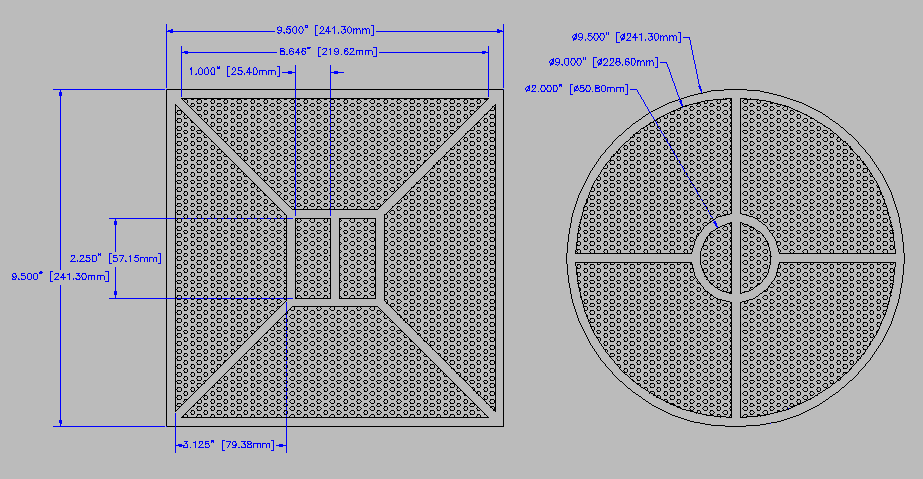

I was just fantasizing an ESL panel shaped round where the treble comes from the centre and the bass from around it (bit like an ESL-63).
Hi, v-bro. How about something like the attached drawing? Tapered perforated stators with center tweeter sections.
But than, how would one divide the frequencies in such a design well?
For a first try, I'd run the four large sections in parallel, both small sections in parallel, and a single resistor between the paralleled large and small sections.

While I was working on the drawing in the last post, I was thinking about using six separate perforated sections for each stator, which I hope helps explain the paralleling of the sections. It's relatively difficult to build the insulators to carry the sections, though.
An easier way would be to use double sided tape to section a single piece of perf as shown above and run the whole ESL full-range. You won't have electrical control of the sections' rolloffs this way, but the mechanical rollofs will still be there.
Maybe a blend of the two ideas? One large piece of perf with the center cut out for a smaller piece of perf and double sided tape to form the sections?

strikes me as the most practicle way of building such a segmented stator. While more work than a perf version the wire wound version keeps everthing as small as possible on a single substrate. A good example of this is the Dutch fellow who wound a 63 style stator.
A perf fabrication looks good on a drawing but as soon as you trie to fit it all together and try to maintain some sort of physical integrity it falls apart in my view. Just my 2 cents. Regards.
Main question in this, would it be possible to have lower frequencies gradually decrease towards the centre?
It works the other way round: The center ring of the 63 plays fullrange, the outer rings receive a signal in which high frequencies are filtered out. The additional top and bottom panels play only bass.
Signal to the outer rings is also delayed in time which is vital to create the wide dispersion pattern of the 63. It won't work very well with simple resistors for filtering (although this will give better dispersion, it will compromise impulse response). Delay lines are the solution.
To get it right you need to take everything into account that connects to the delay line, transformer, panel capacitances, parasatic capacoitances between the panels etc etc. It took Peter Walker 18 years 😉
For instance, exchanging the transformer in the esl63 for something different will likely completely ruin the dispersion pattern.
It's all explained in detail in the various publications of Peter Walker, you'll find them with a bit of googlin'
