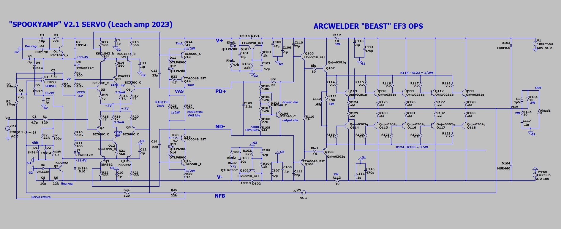

Just build the Wolverine EF-4 output stage , add a "spooky" leach amp input stage - same amp.
Titan is 4 pair MJL21193/94 pair with a Leach symmetrical IPS/VAS.
Wolverine 4 pair Sanken MT-200 would kill the Titan.
Below - "modern titan" will do 2 PPM @ 500W. Driver stages don't need to be paralleled as they are 125W TO-3P's.

Hi ostripper,
this schematic looks very interesting project... could you pls share few more information?
