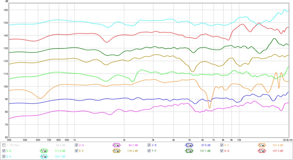

It's but a distant memory, but I did test a close relative, the P830983 Nd magnet, aluminum cone driver in Round 3 of my subjective blind test.
Here is frequency response of all drivers tested in that round and the 830985 is the Green curve labeled "D". The Visaton B80 was the clear winner in this round, but the P830983 actually came in second - so it cannot be called a bad drier. Looking at the curve it is quite flat - typical of well-received likeable drivers. There may be some ringing or "tizzzz" typical of aluminum cone drivers except for SB65WBAC25-4 and FR58EX don't have issues due to good damping of membrane. Note that these 2.5in full range drivers cannot produce bass so best used with a woofer in a FAST as done here. Results of Poll on Post #176.

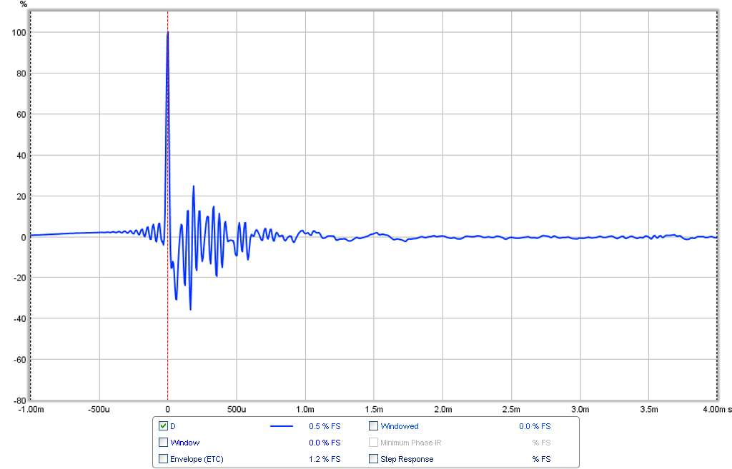

Here is measured impulse response of P830983, notice the ringing - but overall, not a bad response.

Recesssing them is not good. That lip causes an interference dip in the signal and may make it sound like it has a cup over it. MDF is "dead" and perhaps you may need to utiliE the back wave to get some liveliness. Try open baffle. Add a high pass at 500Hz or so and use a woofer below. Those things should help. But measuring with a mic and REW to ensure proper implementation ration can be crucial.
If using them sealed, make sure you add lots of stuffing to absorb back wave. Don't bother porting them you won't get any significant bass.
