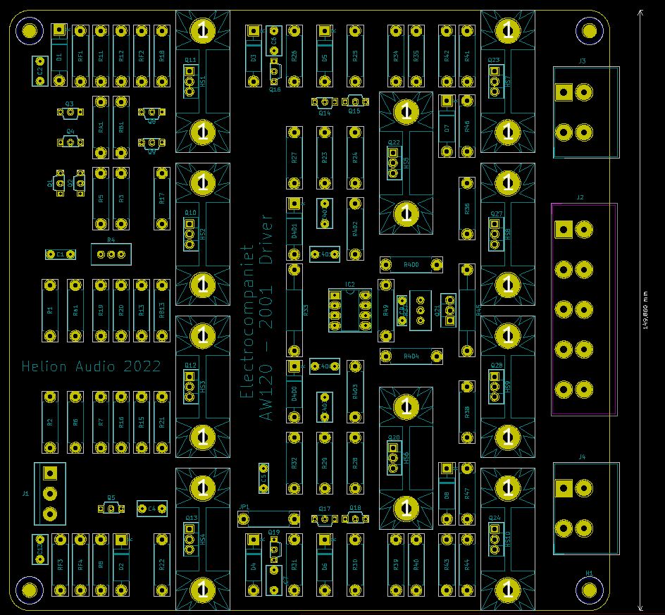

I recently made an AW120 clone PCB in KiCAD. The board excludes the output TR, since I wanted these on a separate PCB. But they may as well be hard wired to the heatsink. Unfortunately there was an error on the schematic I made which is reflected in the PCB. The error is encircled in the KiCAD schematic below - the C8 and R48 did not make it to the PCB. Anyway, I eclose the files if anyone can use them. Both the uncorrected and corrected schematics are in the KiCAD project folder.
