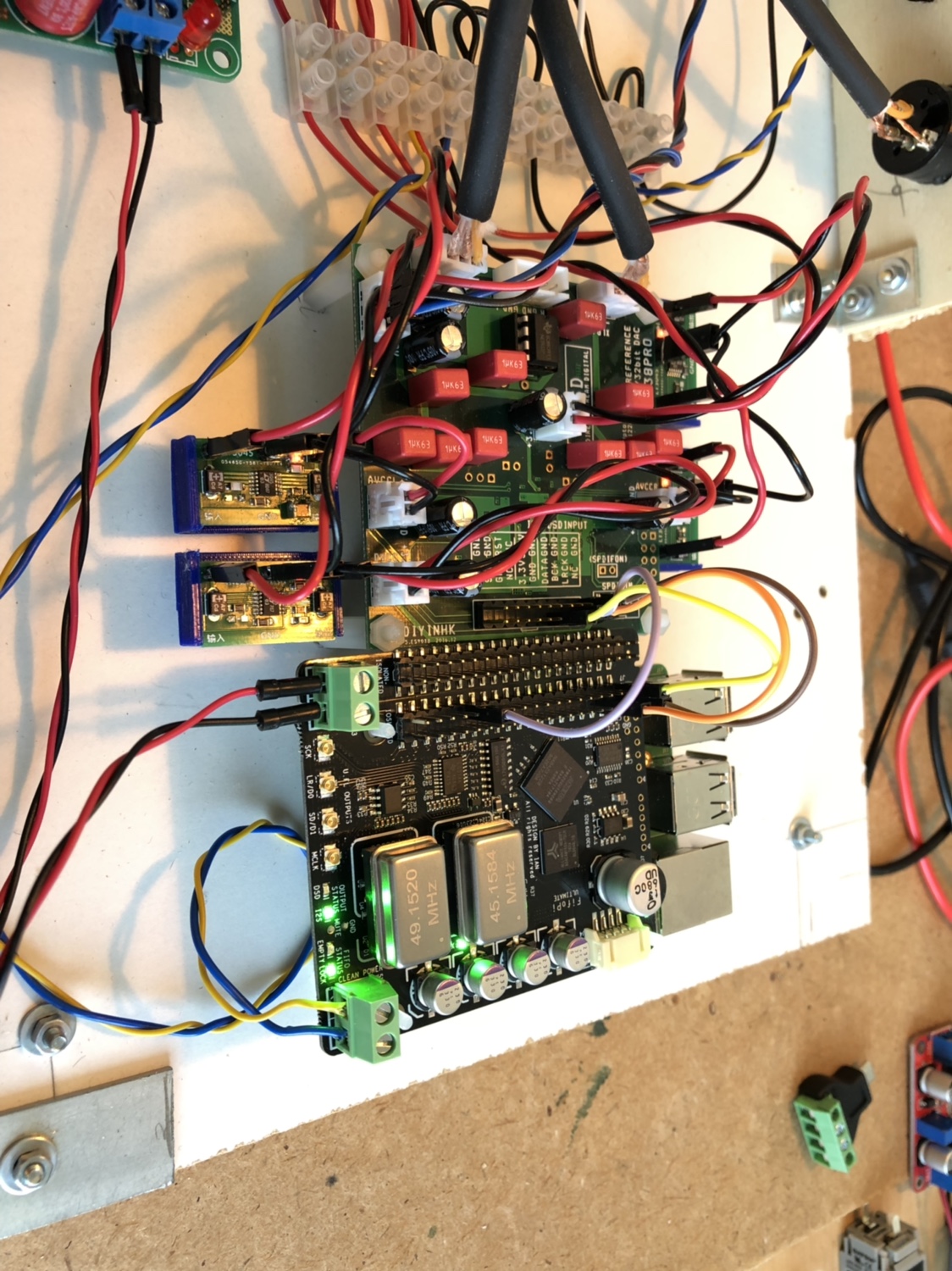

I have AK4137 (pi version) working with ES9038Q2M without problem. So I think your boards may work too.
I suggest to try I2S to AK4137 directly from pi. And don't forget to change pi alsa driver for slave cards (like hifiberry).

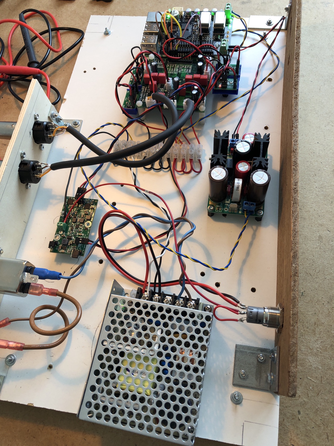

Hi Uchu007, my DAC is a work in progress and it will probably be for a while... 🙂 I like the sound very much! Like you I used LT3042/3045 regulators for every power connection. I still plan to add upsampling and of course build it into a neat cabinet. For now I first want to complete building the BPBP pre-amp.
Have you tried spdif connection ? And if so, under what circumstances ?

No, I haven't tried feeding this dac with SPDIF. I use I2S. However I did at some point consider using SPDIF. At that time I found the following info:
- My understanding is that coaxial SPDIF in-/outputs always work at 0.4Vpp to 0.6Vpp level.
- Inside circuits SPDIF uses TTL level. More info at epanorama.net/S/PDIF Interface
- I found this converter. I converts to 5V TTL though, not the 3.3V that the DAC seems to require, but perhaps both would work.
Hope this helps.
Hope this helps.

Sorry, completely overlooked this post. Answering your questions:
- I don’t have the XMOS board, so can’t tell you anything about that.
- I haven’t tried to access the registry yet; next level... 🙂
- indeed there are no pops or clicks. It locks on seamlessly.
- one thing to note: there is a DC offset on the balanced output that causes a “thud” at shutdown. That annoyed me a bit at first, when I had the DAC connected directly to my power amp. But now I have the BPBP preamp in between, which adequately corrects the offset. All in all I am pretty happy with this DAC.

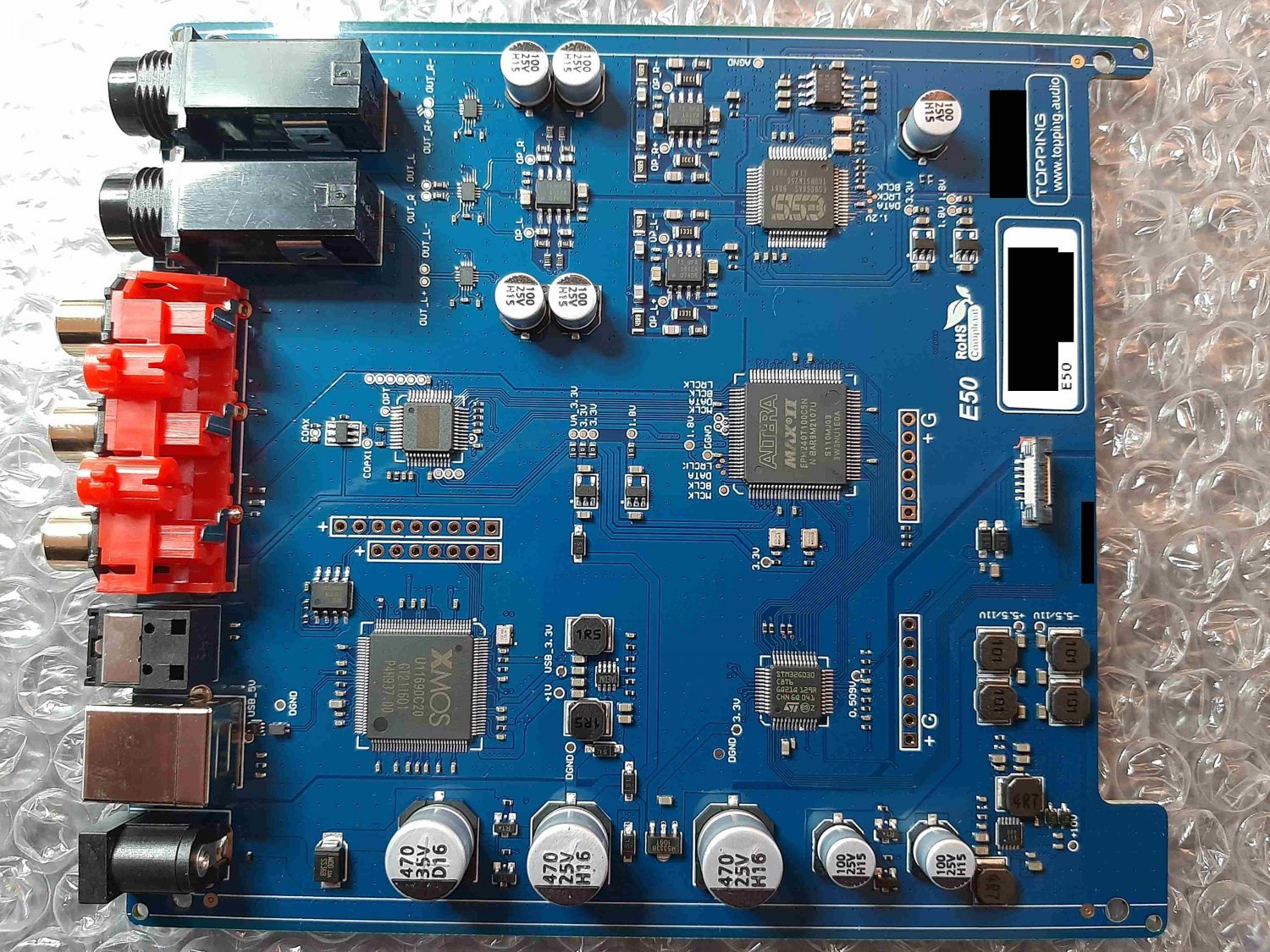

i just got a topping e50 as base to upgrade, it sounds good, but is too trebly whatever 5v barrel enclosure input psu i use and whatever opamp i use as filter/buffer (i use balanced output to own external buffer/filter). it uses es9068as and it has opa1612 for , i assume, avcc buffer. I can't find the pinout for that ESS chip though. would you have any recommendation for that? amybe add a ~1000uf capacitor before the opa1612 buffer? I bought it used so i may just swap the dac for another kind.
Hi pidesd,
Looks like it has multiple SMPS inside. Anyway, I doubt its simply a matter of FR that makes it sound the way it does. Thus, efforts to adjust FR probably aren't going to exactly compensate for whatever it is you are hearing. You could try playing with FR by using a player app that allows you to adjust some kind of EQ and then use that to see if you think you can make it sound better that way.
From the pic, looks like it also has ferrites on the clocks' power, etc. Even has multiple different clocks around the board, which, if so, would suggest one or more ASRC stages.
Its like, for a $200 dac, what should you expect in this day and age? There is too much stuff to fix; in my view it almost would take a redesign to address everything I don't like.
So if it were me I would probably sell it and build a diy dac. Miro 1862, one of the Abraxalito dacs, or if you want to higher end, maybe a Marcelvdg RTZ dac with Cestrian clock board, and Iancanada clocks, etc. The latter would cost more when all is said and done, but I think you would probably be happy with the investment.

Ok.... thanks for the suggestions.
i may try to add capacitors and see if it changes anything. Otherwise i would keep my topping d10s. This one sounds ''righ't' out of the box and got better wth every upgrade, which i guess should be a good prerequisite before modding.
if i go the complete diy route, i would like not to spend too much, because there is always the chance of something going wrong, plus import taxes and duty. I was thinking about an xmos+ak4493 board from DIYINHK....do you have any experience with these? I bought an SMSL su-1 before the e50, in hope for an upgrade, which it was in part, great detail and bass, except that one too had a bit too hot treble for my taste, and decided to return it. Maybe i'll get one used to see if it can be ''fixed'', because otherwise i think it is really high bang for buck.
Otherwise i could wait for a used e70....supposedly it sounds more ''dark'' up top than average.
