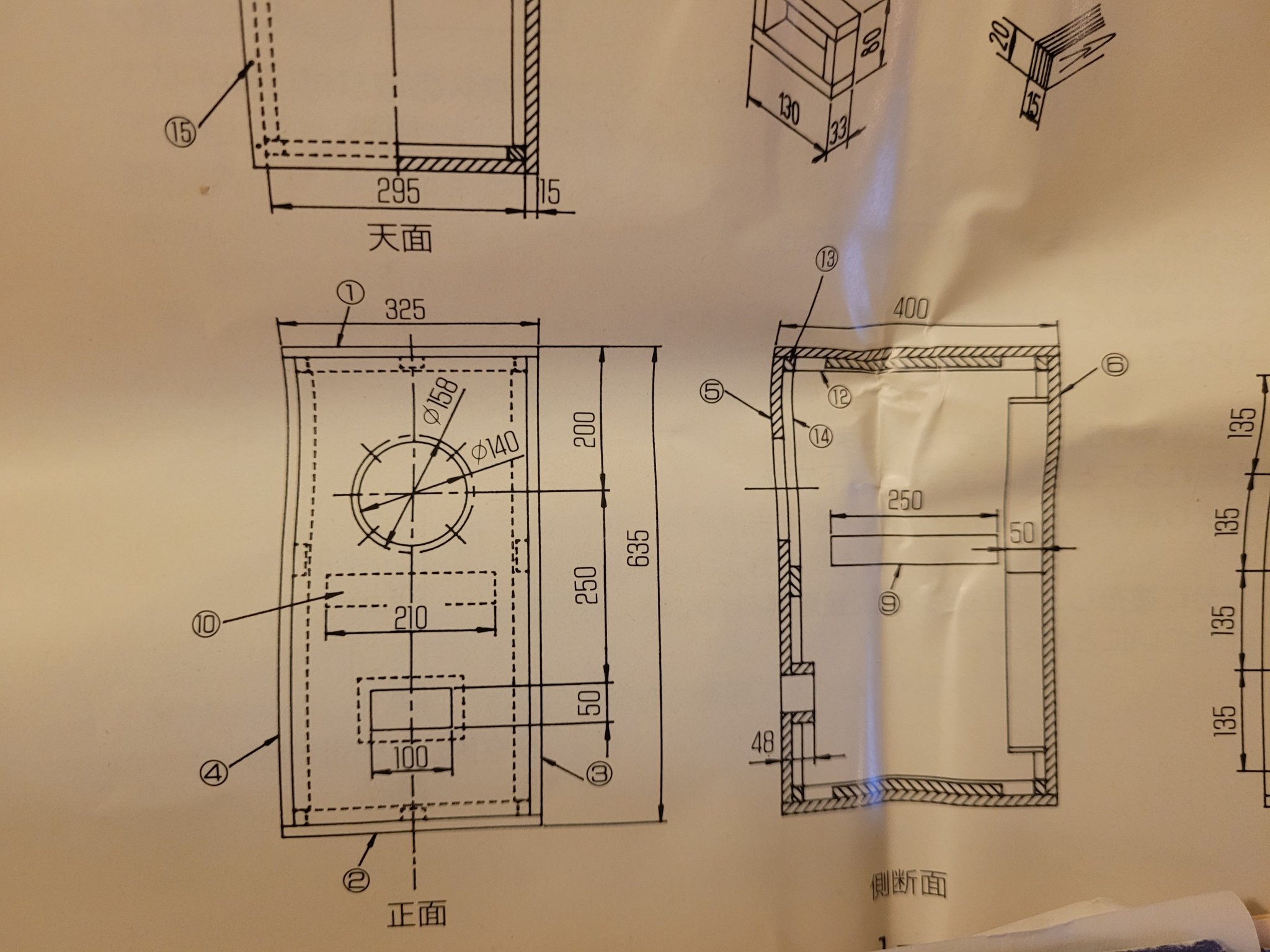

So I wonder if that is something like the one given in the documentation that accompanied the drivers (see below). I guess no need for me to reinvent the wheel if that works well with them. I was mostly just curious as to why a driver with a Qts>1 would work in a bass reflex. From what you wrote, it seems these are not really BR's. Just boxes with holes in them and that don't really follow the math that describes how a BR enclosure works.

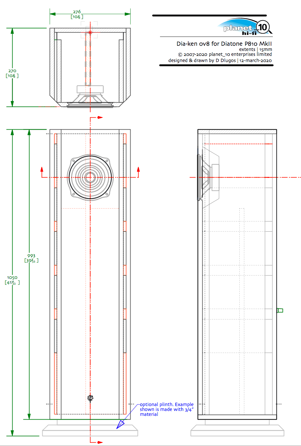

There seem to be a lot of Diatone clones. The Qt of the set you got make them harder to use. But do keep in mind that given what you measured them with the resultant number you get is actually higher than “reality”.
I did a monster miniOnken for (i guess) a different clone, it had easier to use T/S
dave
Worked well for the Japanese taste at the time, possibly modernized a little. A fellow on China's bbs.hifidiy.net has posted many semi-pro audioclips of his beloved MB -- both ends still rolled-off some, though not as much as my alnico clone did. He always seemed reluctant to show or describe his diy "small cab", but I can try to ask....

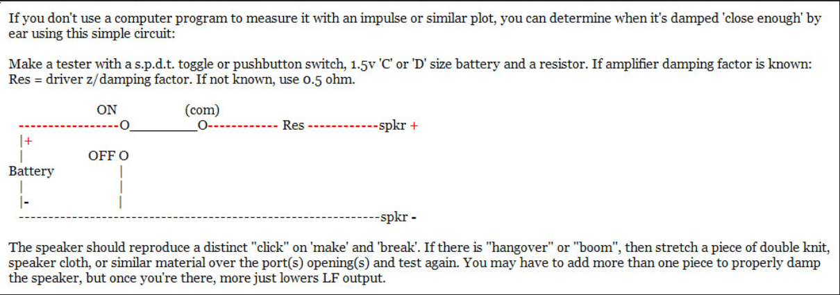

Depends on ones expectations. 😉 Did a lot of high Qt BRs way back when based on the pioneer's conclusion that for BR, Vas/1.44 was the proper balance when tuned to (Fs). Made the box out of lossy materials, thin panels or corrugated cardboard to 'absorb' some of its high Qt 'ringing'. Tuning was always a baffle thickness slot the width of the driver cutout and damping consisted of critically damping the vent.
HIFI? Obviously not; entertaining, yes, in that they were a step up from the typical consumer AM/FM radio, mono TVs, inexpensive record players of the times.
If wanting a bit more HIFI, then use proper box construction, insulation and use some form of EQ to flatten its mid-bass peaking.
