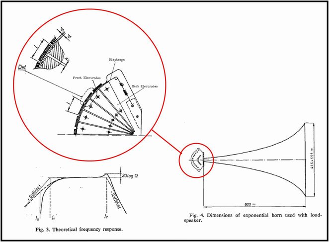

Attachment 1) shows the general arrangement of Merhaut’s horn loaded ESL along with the expected frequency response. Note that there is no high-Q resonance at the lower bandwidth limit like we experience with a dipole ESL. This is because of the horn loading. Paraphrasing from the paper…”the acoustic impedance at the throat of the horn is a purely real specific impedance of co*po…the prismatic waveguide loaded with this impedance at the input will have the same specific impedance at the output…” So, the ESL has a purely resistive air load on the diaphragm over the working frequency range of the horn.

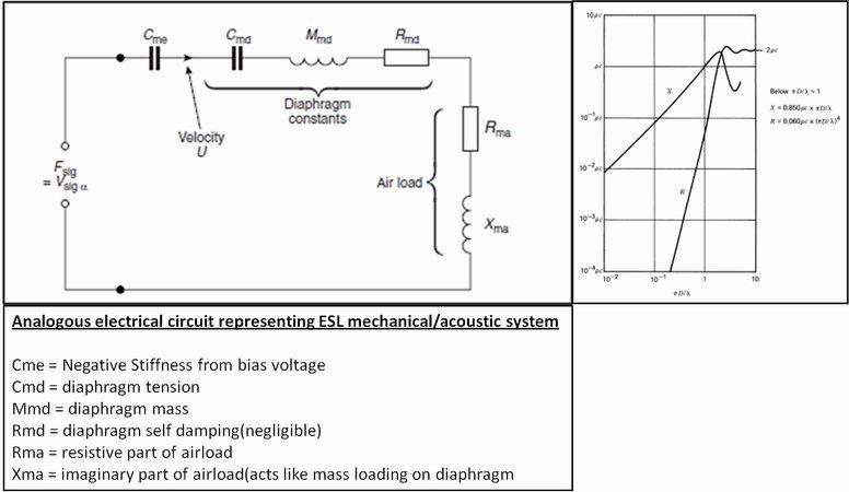

Attachment 2) shows the analogous circuit for a dipole ESL. Note that the airload changes with frequency. At high frequencies, Rma = 2*po*c0 dominates and the load is mainly resistive, just like the horn case. But, at low frequencies, Xma dominates and the airload is mainly reactive which acts like a mass loading on the diaphragm. The actual mass of the airload depends on the shape and size of the diaphragm as well as the amount of baffling around the diaphragm.
Note that Cme is the negative compliance term both Merhaut and Baxandall derive based on bias voltage. Cmd is the compliance due to the mechanical tension of the diaphragm.
Remember, compliance = (1/stiffness)
A side note: the high frequency roll off of ESL constructed with Mylar diaphragms thicker than 6um starts at the frequency where the mass of the diaphragm Mmd is equal in magnitude to the high frequency airload, Rma.
Merhaut’s Formula for F3 of a horn loaded ESL
This formula is not calculating the resonant frequency of the diaphragm. Rather, it is calculating the -3dB lower bandwidth point where the total compliance Cmt = 1/(1/Cmd – 1/Cme) is equal in magnitude to Rma, the resistive airload. The general form of the equation is:
Fs = (constant)* (1/(Cmt*Rma)
Note that this is only valid if F3 is within the working bandwidth of the horn. If it is lower than the cutoff frequency of the horn, the airload will not be resistive and the formula will not yield valid results.
Formula for Fs of dipole ESL
For dipole ESLs, the fundamental resonant frequency is that frequency where the total compliance Cmt = 1/(1/Cmd – 1/Cme) is equal in magnitude to the reactive airload (Xma). The general form of the equation is:
Fs = (constant)*sqrt(1/(Cmt*Xma)) ===> (constant)*sqrt(stiffness / mass)

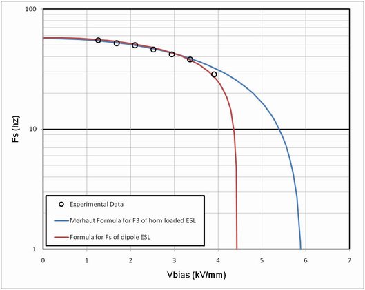

Surprisingly, as Jonas already showed, with properly chosen Cmd, Rma, and Xma both of these equations can provide reasonable curve fits to the experimental data posted at the beginning of this thread. Attachment 3) shows the comparison of both formulas with the data. Of course the values for Cmd required to achieve curve fits to the data are different for the two formulas.
I did add one more data point(close to 4kV/mm bias) to the data set. I didn't include it in the original set of points because there was considerable ionization in the gap. Keep in mind that the resulting current flow would have dropped some of the bias voltage across the insulation. So, most likely the actual bias voltage on the diaphragm is somewhat less than the plotted value I measured.
