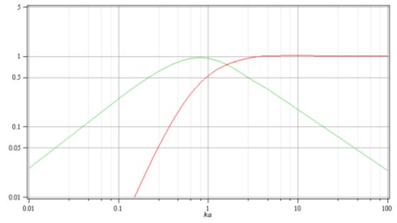

Hi CharlieM
You are close to correct with your guess. There are two distinct parts to the effect you describe.
First, when the membrane moves, it compresses the air causing an acoustic wave to spread out from the points where compression occurs - this is what we hear as sound. The air movement is in the same direction as the movement of the membrane and energy is radiated away from the speaker.
Secondly, there is a kind of sloshing (a technical term 😀) of the air around the membrane - much the same as the sloshing effect around a spoon when you stir your coffee. In this case, there is no compression of the air (so no sound), no energy loss.
The first effect corresponds to the radiation resistance of the ESL. It is the dominant part of the radiation impedance at high frequencies. The radiation resistance is constant at high frequencies, but falls away very quickly at low frequencies (depends on the area of the membrane)
The second effect corresponds to the imaginary part of the radiation impedance (analogous to inductance) and gives the membrane its apparent mass - think about the airmass trapped in a bedsheet when it's shaken. This effect happens at the lowest frequencies only and dies off at higher frequencies, so it has a constant air mass at low frequencies but it gets less as the frequency increases.
The combination of the two means that at high frequencies, the Q of the system (Q= Mass/Resistance, analogous to L/R is an electrical system) is very small (grossly over damped), while at very low frequencies, it is underdamped - hence the membrane resonance and need for additional damping.
See attached Figure - Vertical axis is impedance, horizontal axis is frequency (scaled by size of speaker).
Green curve is imaginary part of the impedance - rises in proportion to f at low frequencies = constant mass in this region.
Red curve is the resistance, which rises as f^3 at low frequencies and is constant at high frequencies.
ESLs mostly operate in the region where the resistance is constant. The curves for conventional loudspeakers are similar, but they operate at low frequencies where the radiation resistance is negligible.
