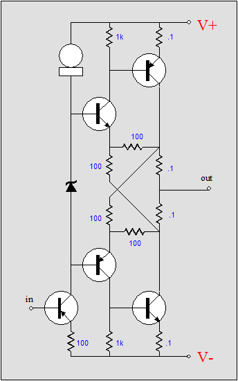

Forgive me in advance if I am incorrect?
But, merely having opposite polarity transistors connected to opposite power supply rails does not make a cross-coupled buffer... perhaps in that few second look at the schematic I missed something crucial.
Doesn't make it a bad circuit though...

bear said:Forgive me in advance if I am incorrect?
_-_-bear
I have no idea what you are trying to get at. 🙂
It's a typical diamond buffer output stage.
Cheers!
Russ
Wherein the x-coupling involves feedback from the output stage back to the input stage via the "cross coupling"... the whole thing following its collective tail, that being a unity gain buffer. Perhaps this isn't the same thing as the "diamond buffer" idea. Or perhaps this sort of thing has been discredited measurement wise, or in terms of listening? Not to worry, I am easily distracted and confused! 😀

That's a complementary feedback pair... I know it well. 🙂
I have used it. Just not here.

...what about without the two 100 ohm resistors that are between the two upper transistors and the bottom two transistors... the horizontal ones, and assume the outputs to be flipped, as is the stage before, emitter to the output... of course that is a differnt circuit, but it is the idea I'm aiming at...
_-_-bear
