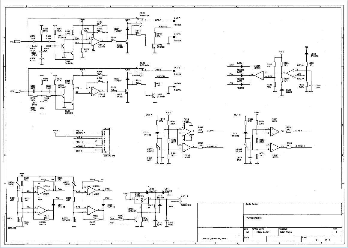

diagram for Magnum-sa12 professional amplifier - SENIA Music echiv 1200 MachAudio
Helo,guys !
Do anybody has diagram for Magnum-sa12 professional amplifier - SENIA Music echivalent 1200 MachAudio - MJL 1302A / MJL3281A
Thks in advance

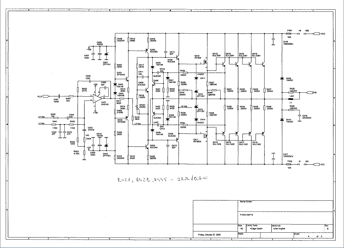

pictures with the inside of this amplifier ...

Thanks a lot, seems to be the correct one !...
Due low resolution of image, I can not see Q401, Q402 - MJE ...
If somehow you have the secondary page in better res I'll be grateful if you'll forward to me.
As it is, anyway, will be a great help ! Thks again

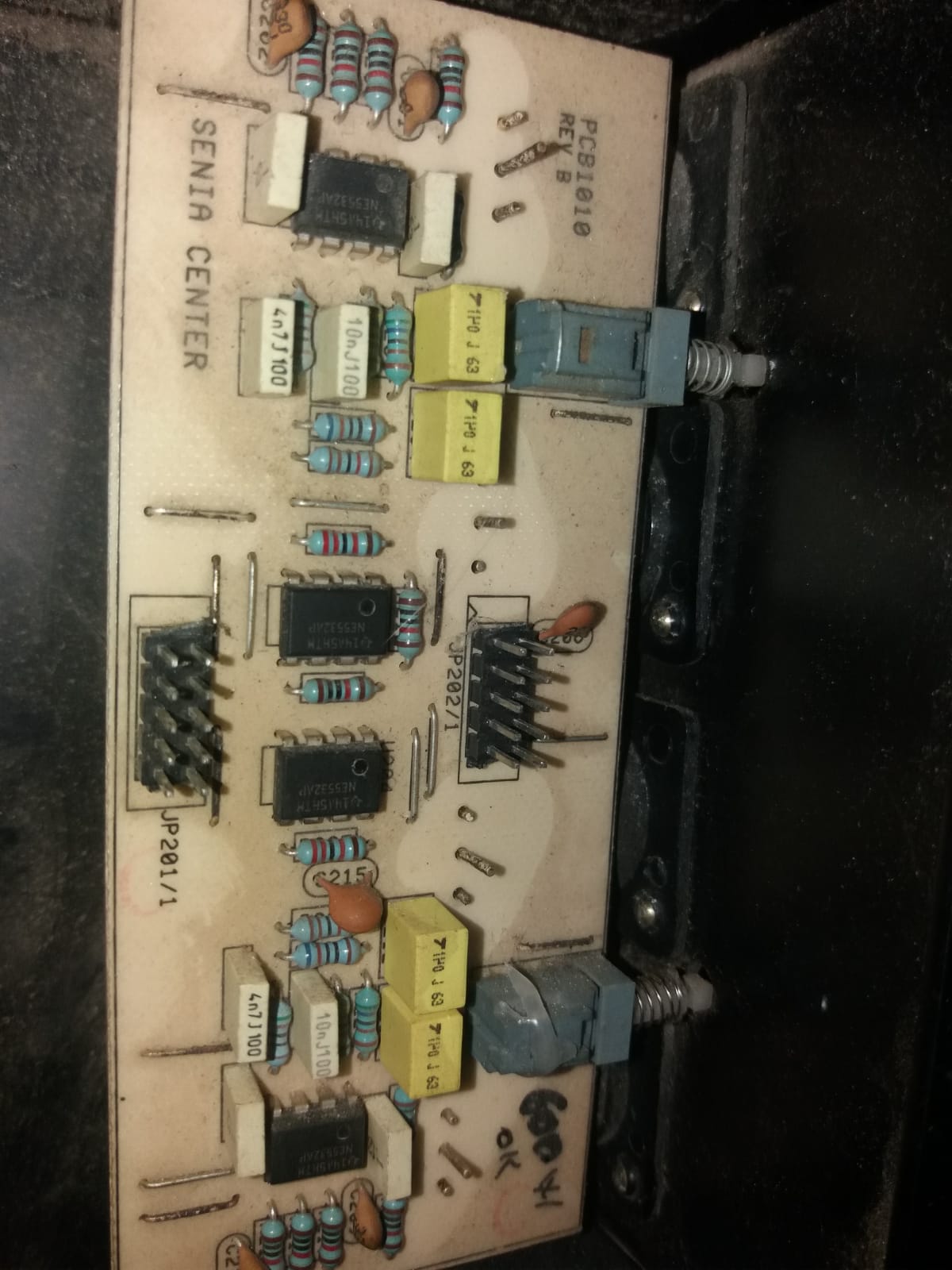

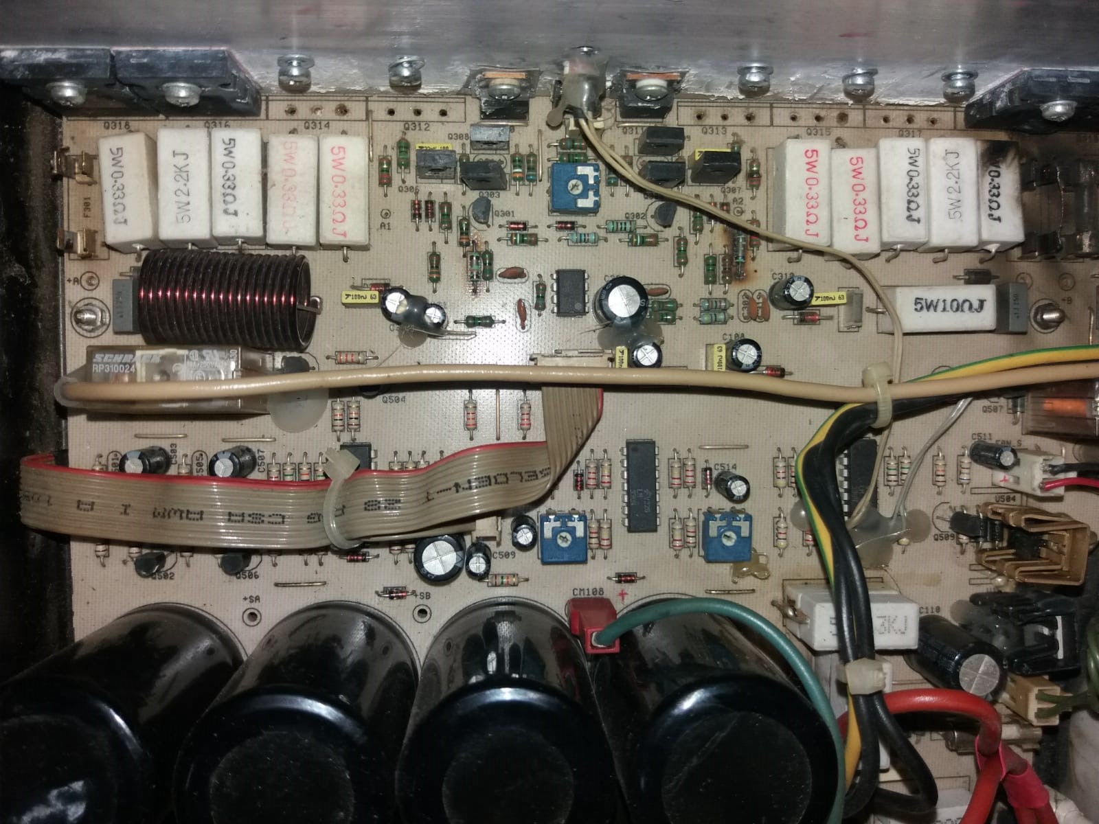

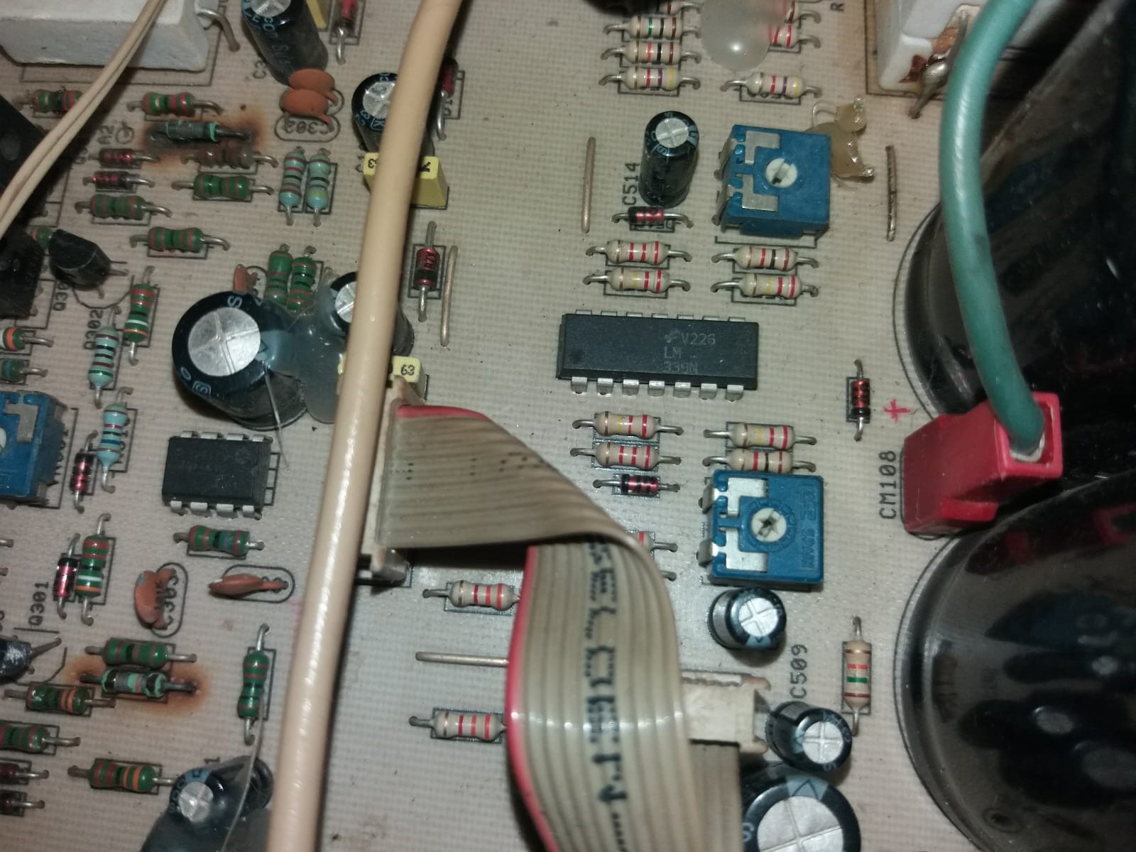

Hello !
Thanks for diagrams 4 and 5 of 5. I need also the rest of diagrams (1,2,3 of 5) due I have a problem on input stage (not working anymore after disconnected both connectors). Servicing for input stage is difficult due no screws - only rivets !

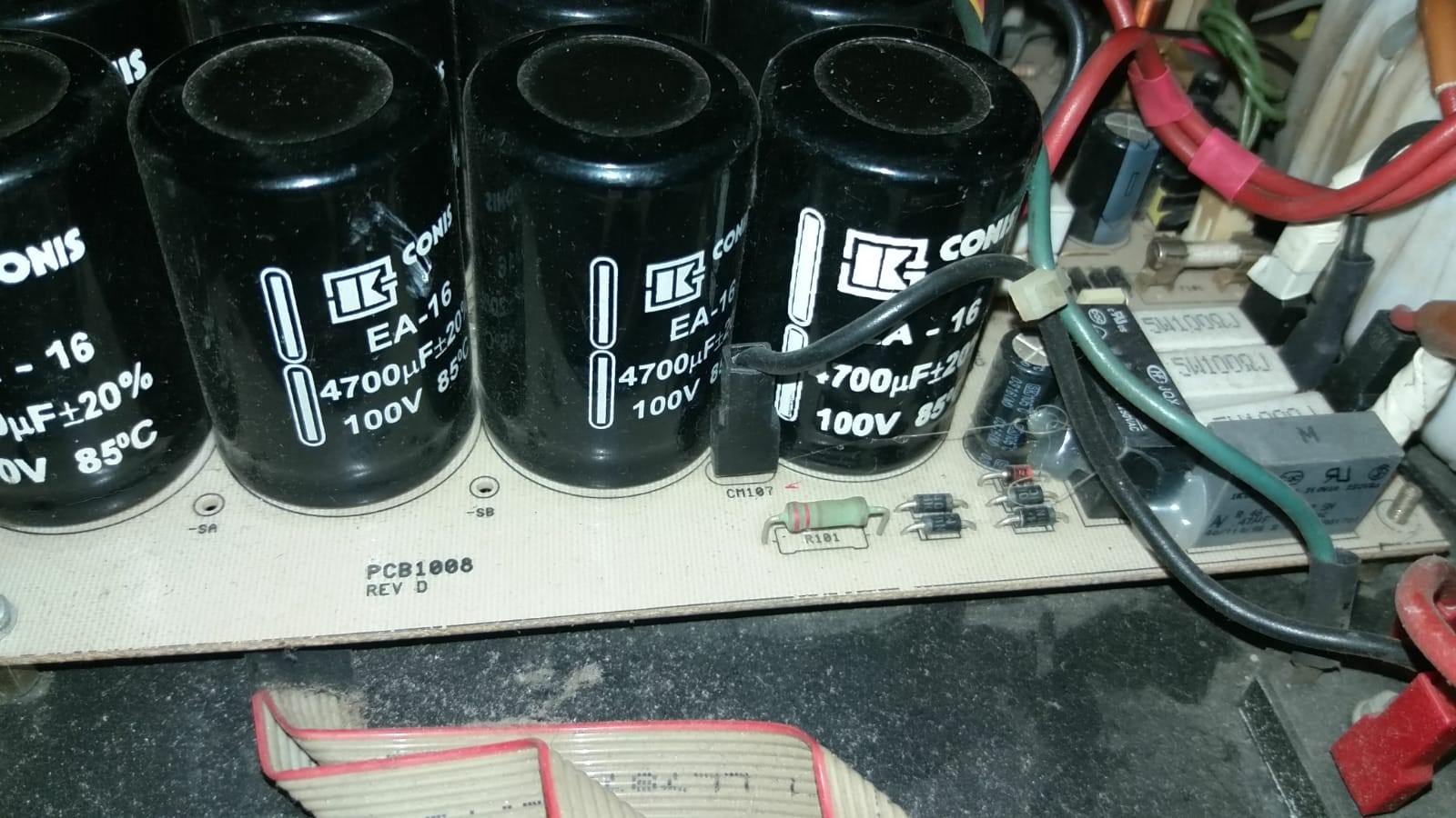

Also I need power supplies diagrams due a lot of voltages on diagrams that different in reality.

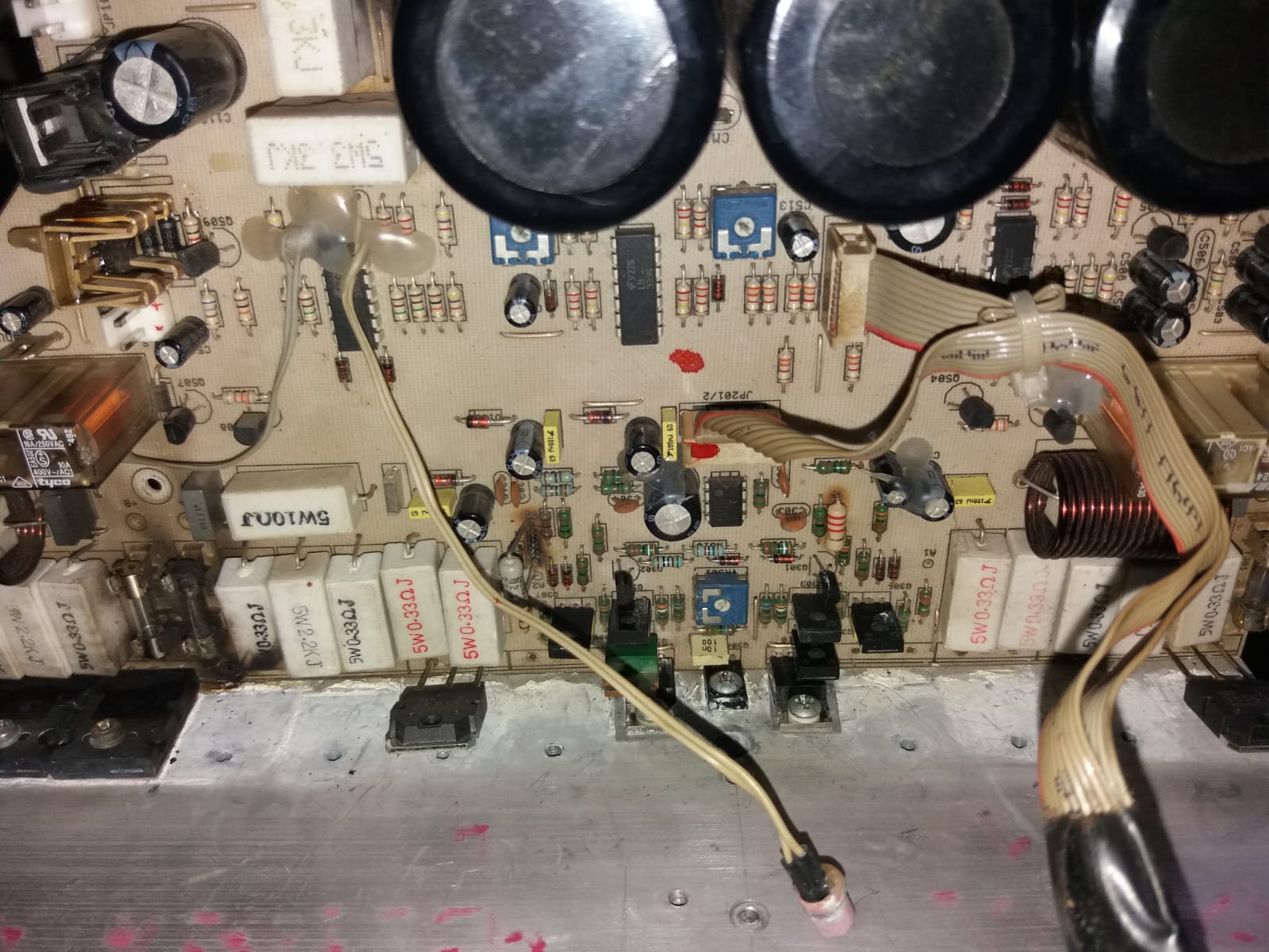

At this moment I have the ex-burned final stage working in only 2 transistors, but working - no idle current but some strange distorsions - green LED "signal" flashing on both channels altough only one has audio signal on it - (I've replaced on my working bench the 21V ac from big transformer with 18V ac only).
I don't know from wehere ± 15V , +28V etc - main trasformer has only 2x70V and 1x21V .
No distorsions if final stage powered by ± 15V , ± 25V but on ± 35V , ± 45V , ± 55V "clipping" strange and no more "clipping" furthermore till ±70V but still distorted.
Inputs directly on volume potentiometers due, as I said , input stage out of order after first disconnection (connectors were heavily covered all around by thermal glue and some force was needed to disconnect...). Or maybe not working on 18V....
Thanks in advance

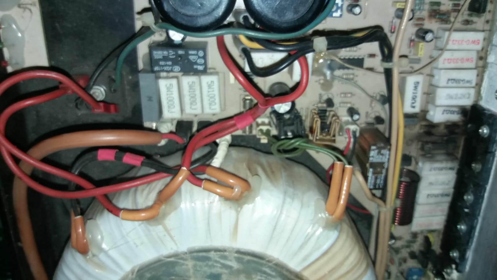

Add coils on the toroidal 20 turns with 0.8 mm insulated wire, in series with the primary, but reverse phased .
In this way, the secondary voltage is low, after rectification and filtration will reach +/- 75 V, enough for today's SOA transistors ...
