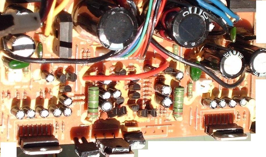

What is the service information? the circit diagram? I've looked and googled every combination I can think of can find anything on it. The model is AT2100i from KLH in case you need it.
Yes I realized my stupidity in destroying my only clue.
Whats the worst that can happen with an misadjusted transistor. Cant I turn it to the lowest setting(or highest, be it clockwise or counter) first and adjust it from there.
In any case I couldn't find any thing that resembles a pot, which I imagine to be a wheel like or flat head screw knob thing. I attached a pic but I have no macro lens so this is the best I got.
Hi stonedfenix, From your picture of the amp, it looks like that transistor has nothing to do with the power amp itself. It looks like those multi-legged things with the metal tab are your power amp IC's.
....I'm adding this link. <http://www.klhaudio.com/warranty.htm> You could ask KLH for a manual. I don't know they'll sell, or not. I didn't get the sense that theywere a well funded part of KLH program.

Those IC's look like the amplifier chips. The transistors may switch in a higher voltage supply when needed as a total guess.
-Chris
I second mrshow4u's recommendations.
-Chris
I would think those power opamps are for the satelites, and that the two transistors in the middle are for the subwoofer. This was the arrangement in a home cinema satelite set I had to repair a while back. The only thing I can't figure is why there would be two, because I thought it was a 2.1 system (it is 2.1, and not 4.1, right?).
But there indeed doesn't seem to be anything like a pot. Perhaps they didn't wanna go through the trouble of proper calibration, and just used a value that mostly works.

That is a good call halfgaar. I got the feeling this sub's x-over/amp were fed with speaker wire. (...and maybe they still are). So maybe this thing is fed with line level signals? I thinks it's time stonedfenix MUST get a service manual.I would think those power opamps are for the satelites, and that the two transistors in the middle are for the subwoofer.
Sorry stoned, I think it's time to admit that better information is needed to move in the right direction. A wrong turn in this area of troubleshooting could cause fire, electrocution, or both. Bad things still happen to seasoned pro's too. It's just that they mostly are going to know what could go wrong. They tend to know where to look for mechanical problems (solder cracks, etc) and when and how to adjust bias. There a lot of things to monitor. Thermal, distortion, oscillation. These are just a few things to be mindful of when repairing/designing equipment. To be good at electronics, takes a long time. You will never know it all. No one will. It's fun all (most) of the way. There is no end. I really recommend the service manual. It will be a great way to really apply reading a schematic to fixing a problem. That's the best way to learn.
About the bias on these things. If the sub amp's output stage is the two TO-3P package transistors, maybe there is no bias pot? Maybe they just run it dirty (under-biased). There is what might be a thermistor in the photo. The power amp IC's (satellites) might have their own internal biasing scheme.
I definitely don't want one of these KLH's after seeing the inside. Hey stonedfenix, maybe this would be a good time to start on a subwoofer project??
....I looked at the picture again. That yellow adhesive on the top side of the PCB. I've seen stuff that looks like that get conductive over the years and cause these "noisey amp" fault. That would be another thing to check, if the noise hasn't gone away through part eplacement or other.
The Project68 subwoofer amp by Rod Elliott also doesn't have a bias control. It is biased by two diodes, which are in thermal contact with the driver heatsink. Rod admits that for normal use, the distortion is too high, but for subwoofer operation, it doesn't matter. The amp in the HKL is used as sub only, so perhaps they used the same reasoning.
