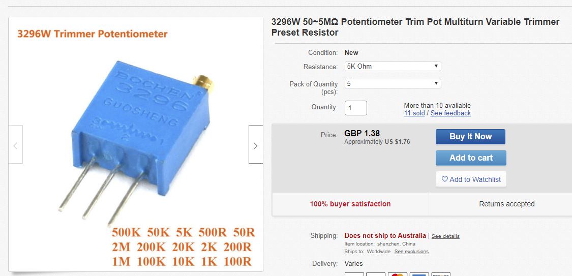

Well, they certainly are cheap!
attachment.php
But... they are cheap.......
You will do much better to replace them with decent, reliable parts such as a Vishay:
https://uk.farnell.com/w/c/passive-...ulti-turn&potentiometer-mounting=through-hole
Just remember that Ebay is often a clearing house for Chinese factory parts that didn't make the cut (poor quality, out of tolerance, copies etc).
As to fixed resistors, it depends on the power requirements and the application. I generally use the Metal Film CMF55 range for 600mW 1% general purpose. If it is higher power, I tend to use the PR02 and PR03 (2W and 3W) range. All of these are available through reputable sellers (Farnell / Element14, Mouser, RS Components, ARROW etc.).
For a bias resistor, I would use minimum tolerance of 1%.

That ebay pot looks just like a bourns, but isn't. Laughable spelling.
Thickness of carbon track or number of expected movement cycles are not advertised specifications of pots. Neither is the type plating on the wiper. There are obviously some competent long life 50 mm slide 10 k pots being sold to mixer manufacturers. These last quite a while. The ability of an individual to buy a pot of similar expected life from any distributor cannot be demonstrated. I've replaced a worn out master volume pot in a Peavey PV8 mixer with a bourns pot. It has lasted 10 movements without trouble so far.
