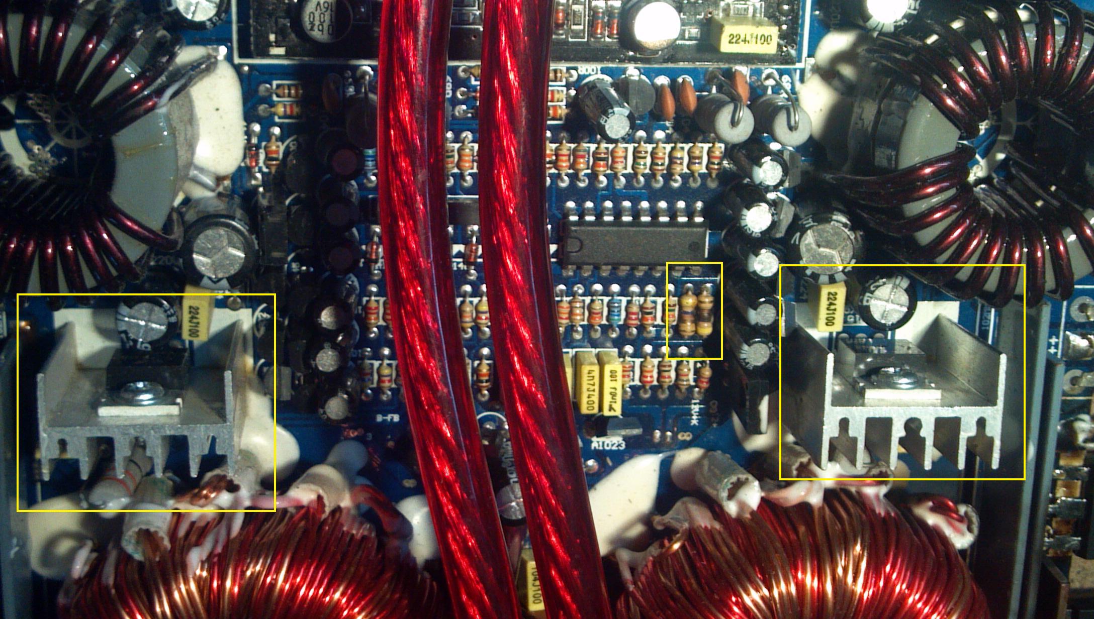

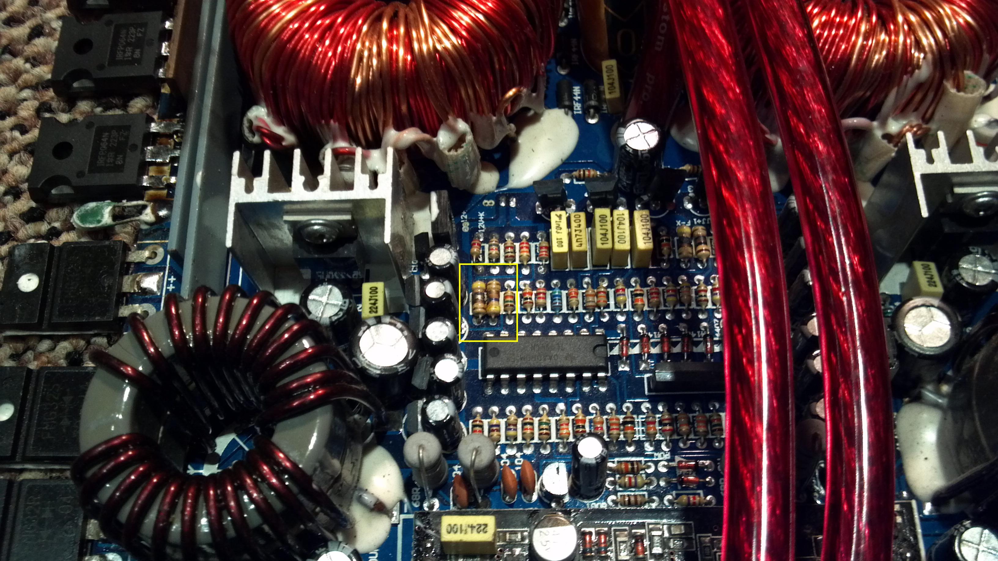

Perry is right, that IC isn't getting enough power. When you power up the amp, what is the current draw of the amp? (I'm curious if you have something drawing more than your power supply can put out, hence the low voltage on that IC)
. 0025 amps at no remote, after applying remote 0.176amps. source voltage is 14.6 volts. LOL Thanks for your attention to detail there blazer. And i am laughing at the situation.(mine). You would laugh too. I am not your average tech. My learning process is different than most.

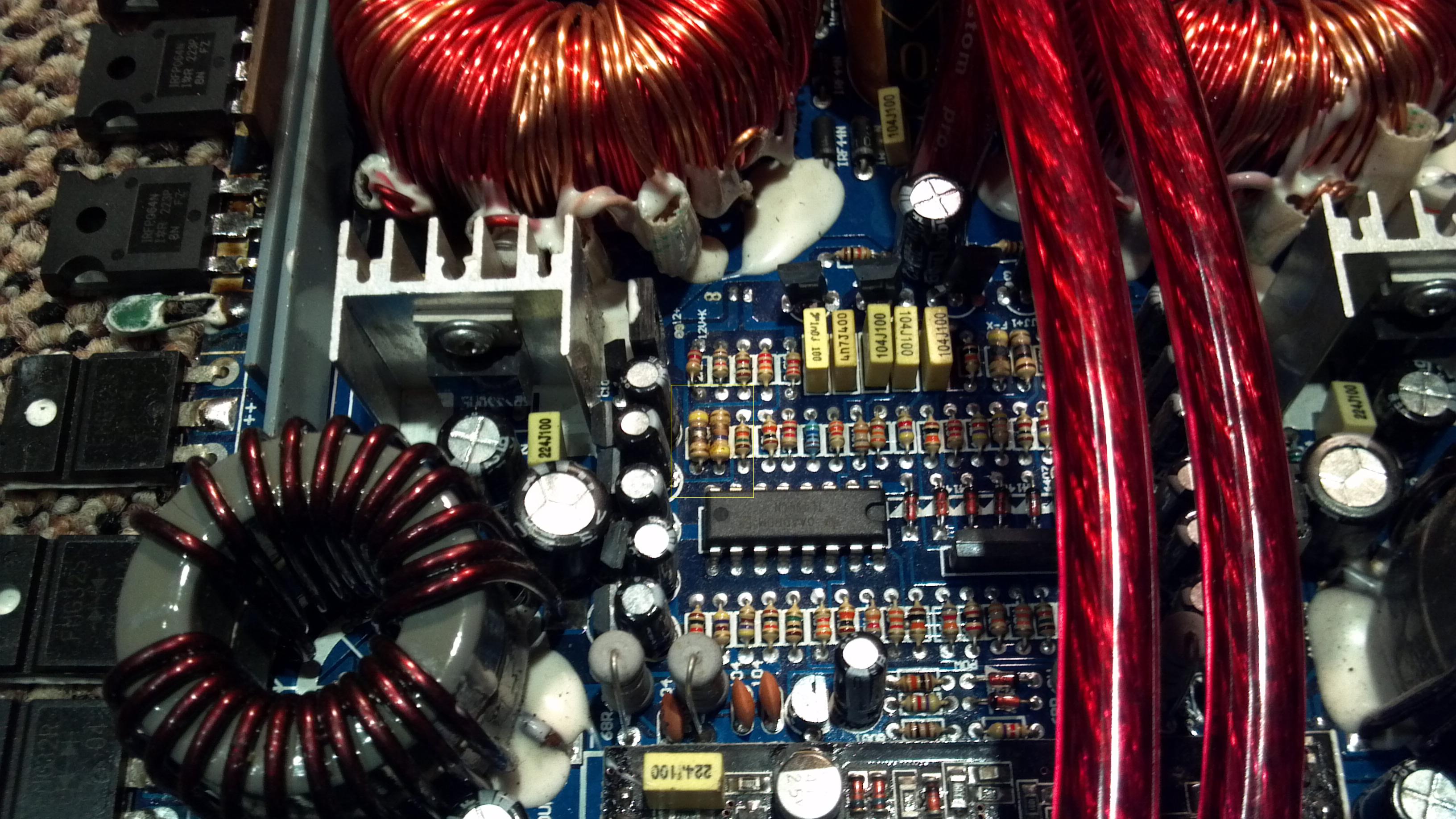

Good, at least we don't have a short that is drawing the supply down. Pin 12 of that 494 IC is power for the chip, trace it back (to usually the remote) and find out what is preventing power from getting to pin 12. I usually find there's a blown transistor holding up things....

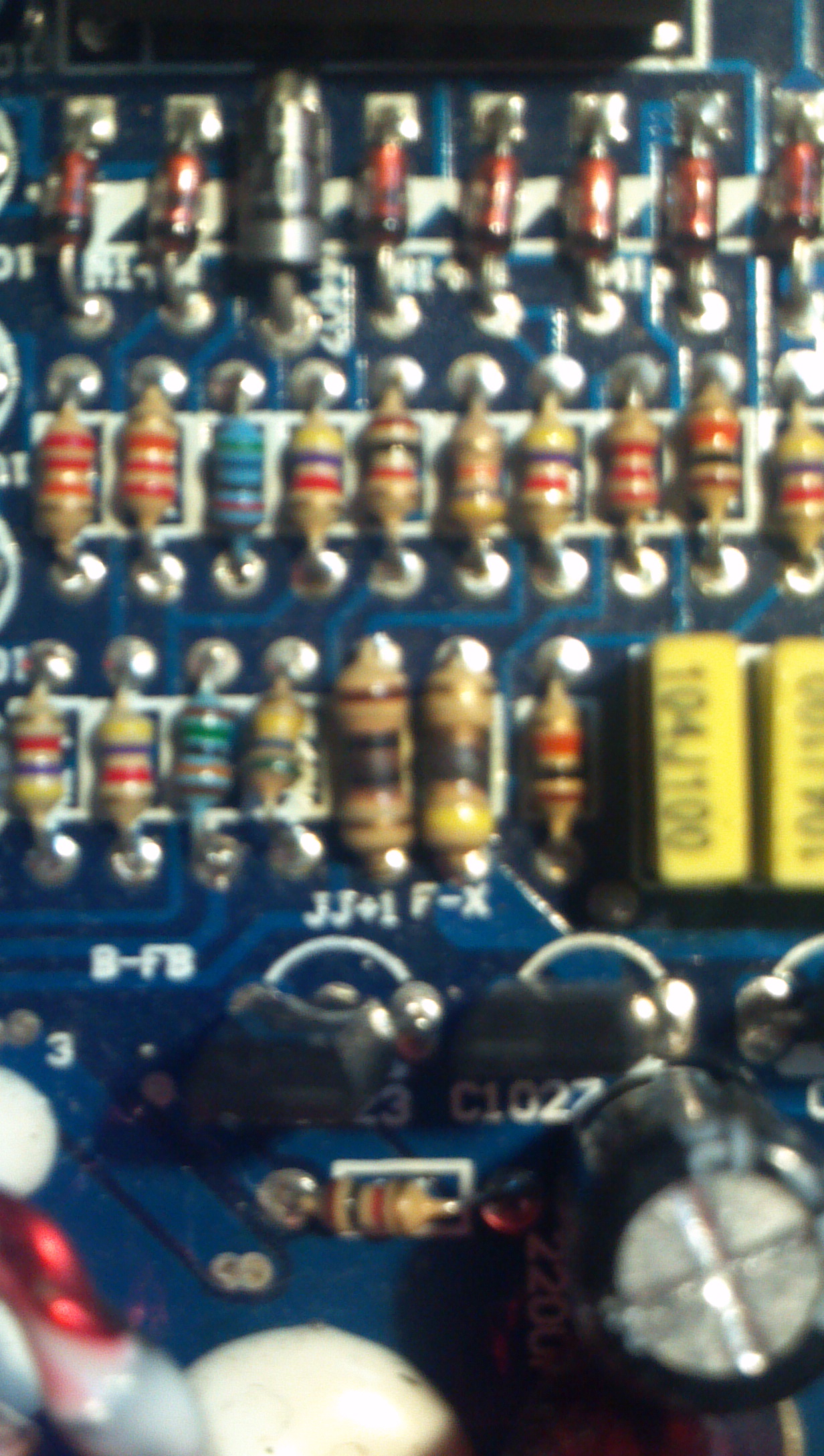

The bigger items on the heatsinks, I don't know, what are the markings on the front of them? The two smaller items are resistors, looks like they got hot. You'll want to verify their resistance because they have burned some. (I can't quite tell their value from the pics)
The one with the brown band is 10ohm and the other is 4.7ohm I believe. Yellow, violet, gold, gold
