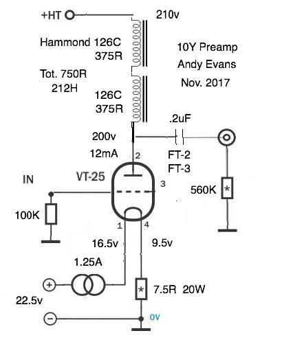

I wouldn't use the 2a3 for one simple reason - it can't be used in filament bias. Filament bias for me is a must - I don't want to be using a cathode bypass cap. I hate any caps in the signal path, and try to reduce them to the best of a necessary evil - polypropylene caps throughout the PSU and one teflon coupling cap with a plate choke or gyrator anode load.
Choices for filament bias - 26, 01A, 10Y as higher Ra or 2P29L, 4P1L with lower Ra. The last two can be used with a plate choke of around 100H. The other three want more than that, even double. So what I'm constructing and hoping to finish today is a 10Y preamp stage with 2 of Hammond 126C in series as anode chokes, which will give me just over 200H at 15mA. In theory this is just what I want. I'll know soon if in practice it works.
So before fixing on the 2a3 I'd strongly suggest you look at options in filament bias. One of these is the Bartola gyrator which is good with the 01A. 01a Preamp (Gen2) – Bartola(R) Valves
For those that don't want solid state I would go with a plate choke like the Lundahl LL1667 or LL1668. For 01A go with 5mA, for 26 go with 7mA, for 10Y go with 10mA/15mA, for 2P29L go with 15mA, for 4P1L go with 25mA.
I'll post my 10Y circuit later when it's up and running.

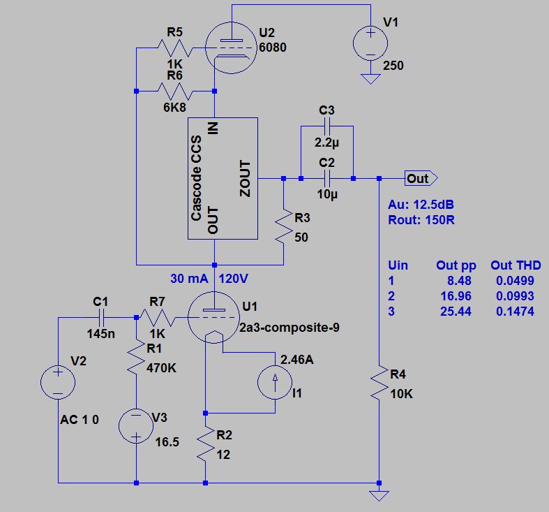

TRAM2 has mixed bias.
I have used resistors in parallel with CCS in diif pairs with CCS tails but what is the purpose of R6 which is connected in parallel with the CCS in this design ?
cheers
That's absolutely not true. A 4R/75W resistor would bring 10V of bias to a 2A3, which would work well for filament bias.I wouldn't use the 2a3 for one simple reason - it can't be used in filament bias.
Filament bias isn't the only way to ditch the cathode bypass cap. A TL31 could bias up a 2A3 for 50mA/10Vb with no cathode bypass cap. A 9V battery biasing the grid could do the job nicely also.Filament bias for me is a must - I don't want to be using a cathode bypass cap.
The issue with the 2A3 is the current required. Using a 6A3 would be much easier.
It was in the original schematic.what is the purpose of R6 which is connected in parallel with the CCS in this design ?

Here it is - my new 10Y preamp. This supersedes all DHT preamps I've ever made (quite a lot) - more clarity, more neutral, better bass. It just sounds completely smooth and natural. Quite a big increase in clarity, in fact. I find myself listening at lower volumes since it's all so clear.

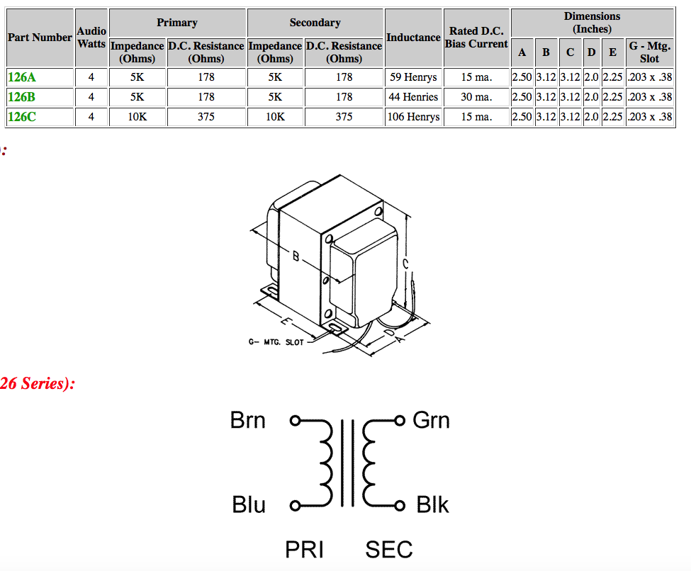

The Hammond 126Cs seem to be working well in series. A pair of these is cheaper than the Lundahl plate chokes, and I imagine just as good from my memories of a pair of Lundahls I once had. The Hammond are bifilar wound - one of their better products. I take the end bells off and mount them under the chassis. You just need the primaries. They're big and solid items. With 212H available, a pair in series should also work for a 01A or 26. Coupling caps are two FT-2 0.1uF in parallel, or you could use FT-3.
I'm very happy with this preamp - it's not going anywhere. Apart from the 10Ys themselves, it's not too expensive to make, though there's quite a lot of work in it. I use a separate choke input filament supply and a separate PSU. Three chassis.
Andy, did you try to connect the primary and secondary of just one 126C in series?
That way you would have over 400H with the same total DCR as what you do with two separate 126C's.
Gosh! Can you do that? That would be brilliant. I never knew that was possible. I've attached the data. You mean you connect Blue to Black or Blue to Green?
If this works it would be awesome. It's gapped for 15mA. Will it still pass 15mA as a plate choke? How is it "over 400H" rather than 212H?
