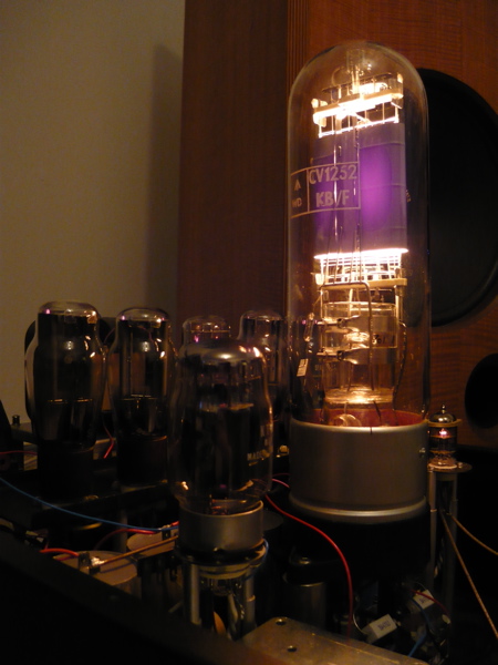

Hugh, then you would not see the heater elements of the tubes at night. That is hypotonic to the eyes. It's like watching a fire. See the picture of my STC 4212E tube. I have had metal shielding in my Ah! CD player and I could not hear a difference. If the Full Music 2A3/SE are microphonic, then use the Herbie's Audio Lab Damping Instruments Guitar type dampners. The Full Music 45 ST shaped tubes are somewhat microphonic and I used the dampners with little difference in the noise heard.

Ah - the Zen option. May I ask why you recommend no tube shielding? The presumed benefits of better cooling and less noise seems pretty useful for a simple DIY job, that even I can wire up without zapping myself.
I simply don't see the point of these pipes... Tubes are designed run hot and to work perfectly fine without extra cooling, and how much will they actually lower the temp? A few degrees..!? That's a solution looking for a problem if you ask me. And since I have no hum what so ever they are not needed for grounding / shielding either.
Besides, as Peter mentiones: Tubes are beautiful, metal pipes are not.
