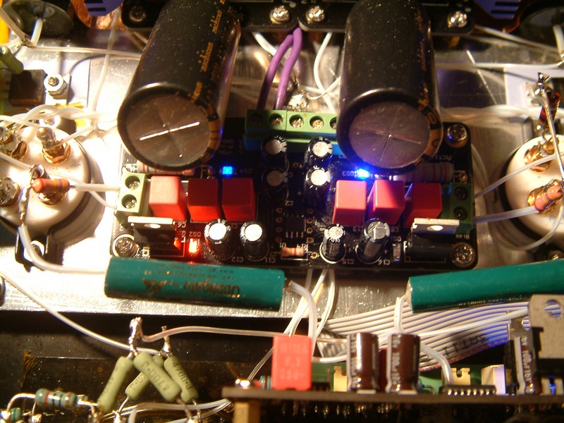

One of the Trams that I assembled developed a fault in the bias supply boards. See the pic. One channel supply is showing red diode next to its 2SA940 transistor. Bias voltage on that side is 16V only. This happened after only 6 months of normal operation.
What went wrong here? Is it possible to get a replacement from Simon?
Are you sure it's the Bias Module? These very rarely cause any trouble.
Just return the faulty module for replacements. Hard to say what specifically went, any possibility, something was shorted? It may still work afterwards for a while but something may have taken a knock...
Ciao T
I am sorry it looks that I was too hasty as always. The red diode follows one of the valves. It is definitely the valve. I will get some spares today and double check. Thanks.
The Red Led is the "cannot control current even though I tried" indication. It basically tells you "Tube dead". If the tubes are under warranty you may be able to get a replacement from DIY.
