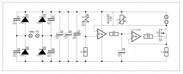

I just finished DHT for 300B, but when I start on output I have 8.75V for 10 sec. and than goes to desired 5V.
Can I leave like this or it will damage 300B?
Any one have idea how to solve this problem?
That's about the opposite of what you want to do. Applying 8.75 V to a dead cold filament will cause a lot of current to run in the filament, thus, causing a thermal chock. That's not nice...
I wonder if it has to do with the fact that you have two control loops in your circuit. One that controls the voltage across the filament, the other controls the current. I would eliminate the voltage control loop and just program the current to 1.4 A. You could make it adjustable so that you can adjust for 5.0 V across a hot filament.
