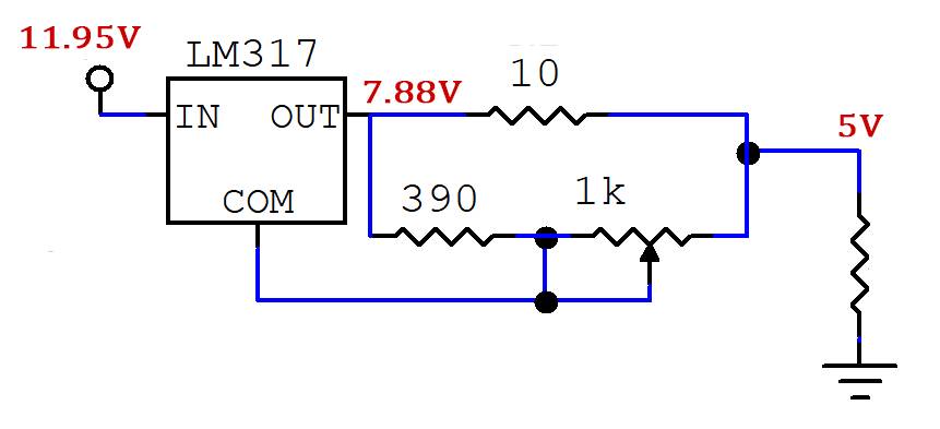

I am playing around with some 12As in a preamp and i have noticed something odd:
I use a LM317T as current regulator for each tube (two separate LM317Ts plus separate floating PSUs). The CCS are adjustable so I set each one for 5V measured at the valve pins.
However current through both valves is 297mA?? I experienced the same with a 71A I plugged in...
Input to the CCS is 12V. The LM317Ts have ~4V across them so they are not dropping out. The voltage across the sense resistor (10R in parallel with 390R and a 1k pot) is 2.88V. Both filaments measure 5V
What gives? The spec for both 12A and 71A is 5V at 250mA....?

+20% is a little high, but I do not consider it a fault.
The data sheet value for Filament Current is only a guide - it's not a guaranteed parameter. The value is very often ±10% away from the nominal. So, I don't think it's a worry.
Some DHTs, like the WE101D and other WEs, and the STC 3A/109 are specified for exact current. In this case, the current must be set carefully to the nominal value, and the voltage can fall wherever it likes (again, within 10%, usually).

Two 47Rs across filament pins, center of which connected to cathode resistor and bypass cap. Anode current is only 5mA. Both tubes drawing ~295mA. Exactly 5V across filament pins.

Two series-connected 47Ω Rs across the filament will draw about 53mA - you can subtract that from the 295mA, and everything looks normal!
Assuming the sense resistor is between the output and the ADJ terminal of the LM317, the voltage should be quite close to 2.5 V, between 2.4 V and 2.6 V if I remember well. So why is it 2.88 V, 15.2 % above nominal? Is the circuit different from what I assume it to be or is it oscillating?
The circuit is simply not what I guessed; I thought there was 2.88 V between OUT and COM (a.k.a. ADJ), which would have been strange.
For the record, what I wrote in post 7 is all wrong, as the LM317's reference voltage is 1.25 V +/- 50 mV rather than 2.5 V +/- 100 mV.
