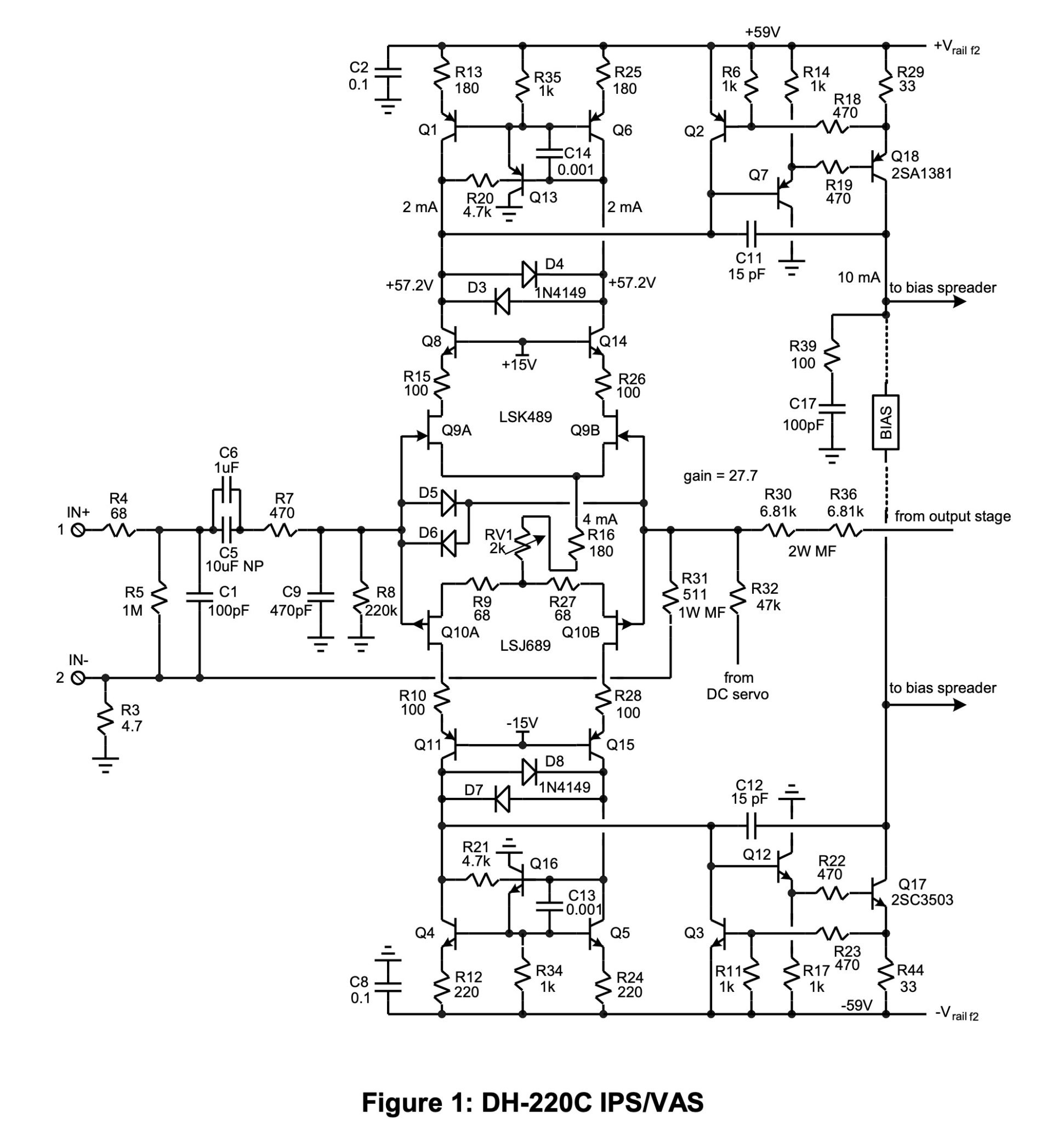

I've been working on rebuilding my Hafler DH-220 into the DH-220C input circuit - the Bob Cordell designed circuit that's sold by delta9electronics on eBay and I believe is a member here.
Anyway...on power-up, (the rail-to-rail voltage is about 120V or just under +/-60V) and it more or less immediately fried R53, the 22 ohm resistor at the positive rail, along with both R13 and R25 the 180 ohm resistor that power Q1 and Q2.
This was only one the right channel - the left channel seems to have survived.
Questions:
I haven't pulled the transistors, but is it safe to assume they're also toast, or is there a chance they're ok.
What would have caused R13 and R25 to burn.
I presume that R53 blew because of overcurrent at R13 and R25...
Where should I be looking for the root cause?

So far I have found the following failed components:
R53 (not shown on schematic but in line with +V(rail)
R13
R25
Q6
Q13
D1 (also not shown but is the shunt zener +15V regulator)
It's weird. I can't see R53 burning unless there was a large amount of current (which of course there was). R13 and R25 saw enough current to blow, and Q6 is in line with R25, but Q13 is inline with R25, which was perfectly fine, so I guess Q6 was fully conducting which put over voltage on the base of Q13? Am I reading the schematic right?
D1 is also fishy...it was blown, but I wonder if it is the root cause of all the issues...
If it is bad from he start then the +15V reference at the bases of Q6 (blown) and Q14 (OK) would have been potentially too high.
I'm rambling here trying to talk myself into finding the root cause, but I can't figure out what it would have been...

I believe that I found the root cause of the failure of the IPS board.
Zener diode D1, which provides the +15V reference, was either bad from the start or failed on startup and caused the failure of the above listed components, including Q8, which was partially shorted - it tested ok in a tester, but a multimeter test across C to E showed only 147 ohms, so it was bad.
Ok...all other components tested fine, replacements were installed and it was powered up successfully, and biased properly and predictably according to the instructions.

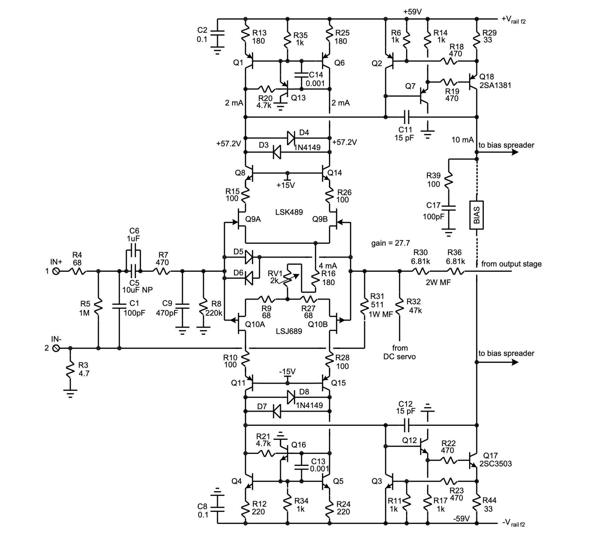

On the IPS board, resistor R3 blew on both channels.
R3?? come on, that's the resistor that ties signal ground to the chassis. And something caused it to blow, so that meant significant current was attempting to drain into the chassis.
But what could that be??

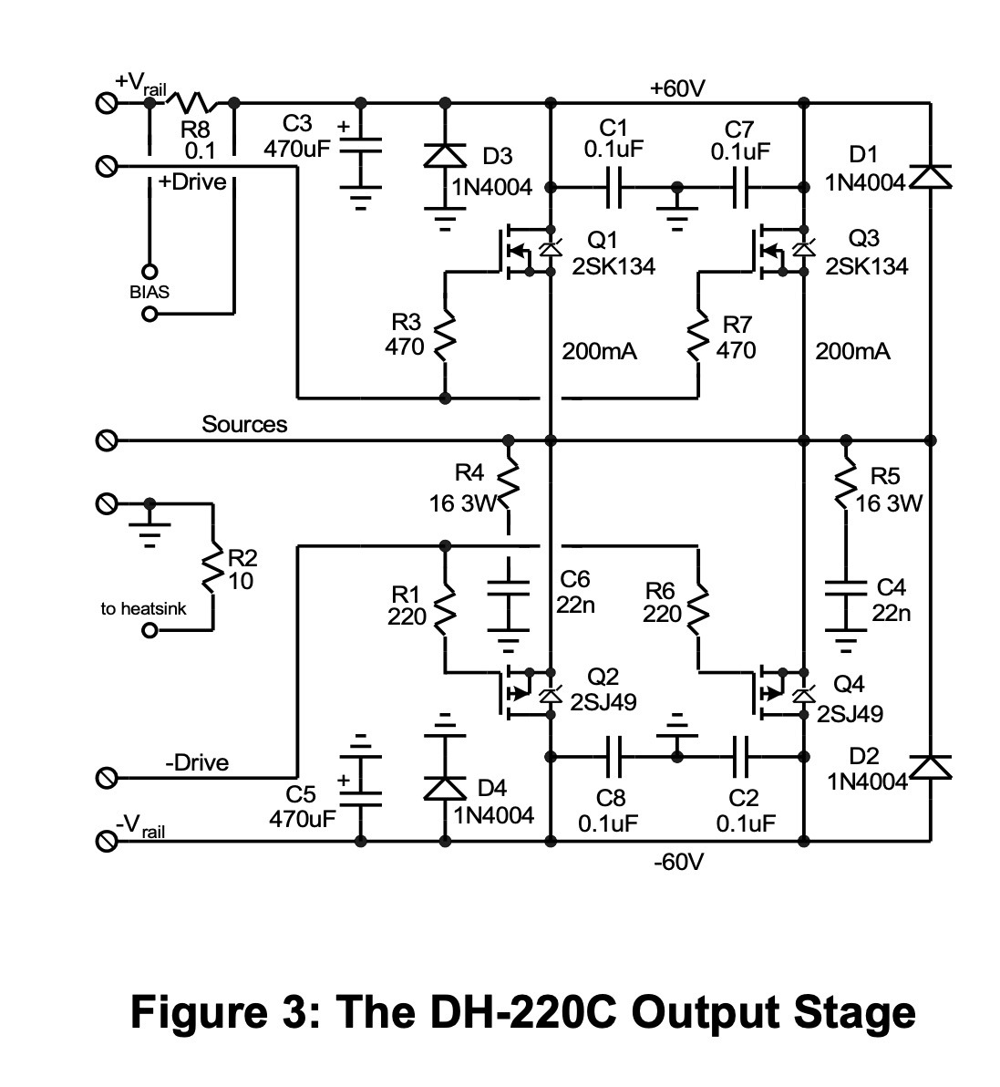

In a similar vein, on the OPS board (diagram shown) resistor R2 blew on both channels. And fairly spectacularly. Again, that ties the output ground to the chassis, so something was passing significant current there, too. But what??
I can't think of what it could be. Could the chassis have become energized with something? It's not from the MosFETs. I did check to see if they were isolated (they were).
Has anyone experienced anything like this?
Also, what is the purpose of these low value resistors from signal ground to the chassis?

Did you check to insure that your MOSFETs are galvanically isolated from the heat sinks? I beleive for TO-3 package lateral MOSFETs, the drain is tied to its case.

I believe everything is correct. I checked all the mosfets and they are not shorted to the chassis. When I rebuilt the chassis it got new mica insulators and new mosfet sockets.
And I did start it up with a dim bulb tester and it started smoothly and passed the biasing tests described in the AudioXpress article without incident. The IPS reproduced a 10KHz square wave very nicely well past 3VRMS at the test point.
The issue happened when speakers were connected and an input signal applied.
