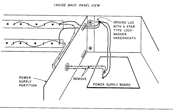

There was a ground loop issue discussed in TAA 2/79. The fix is noted in the attached GIF.
