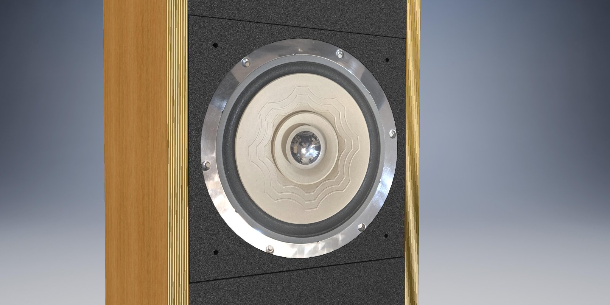

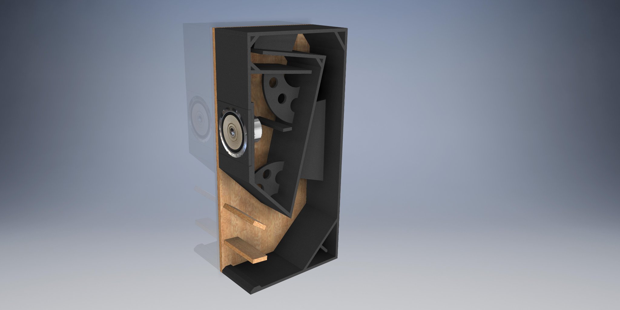

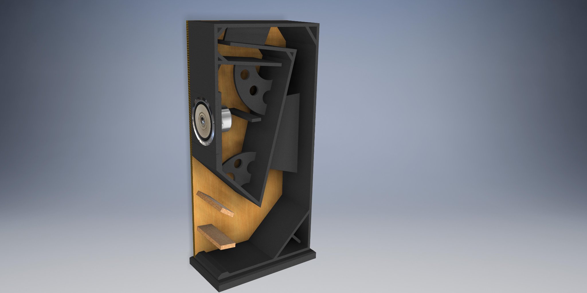

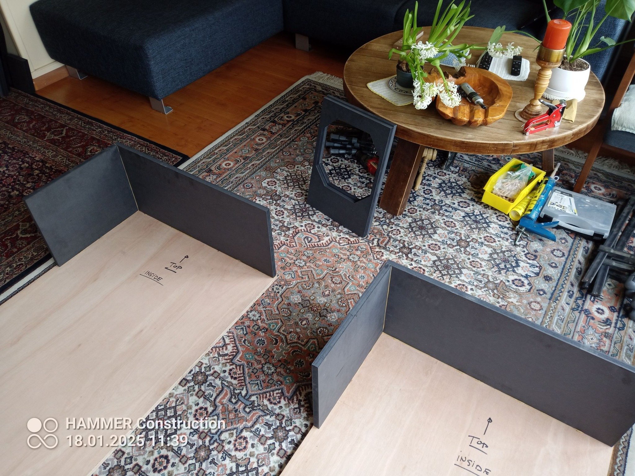

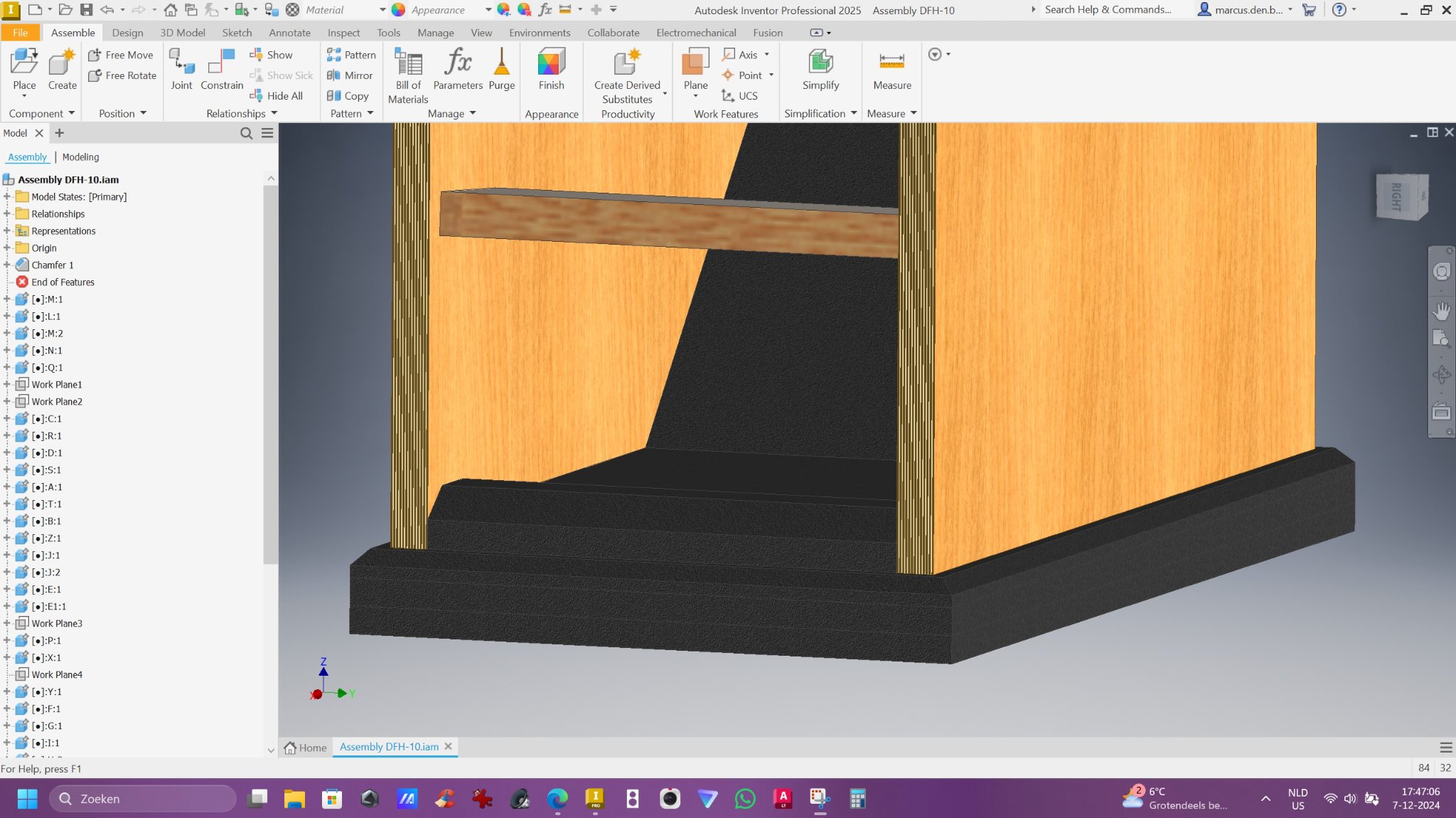

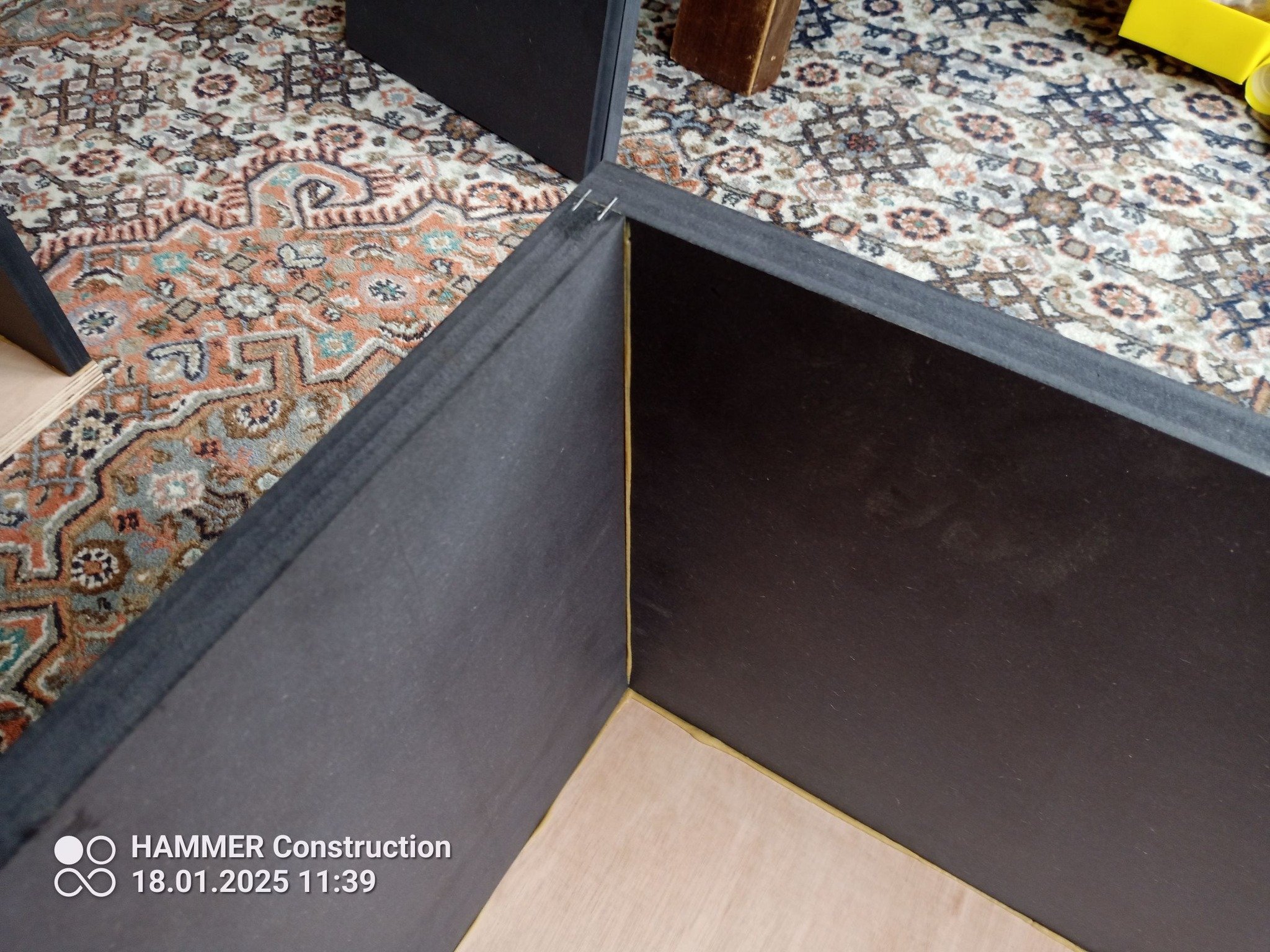

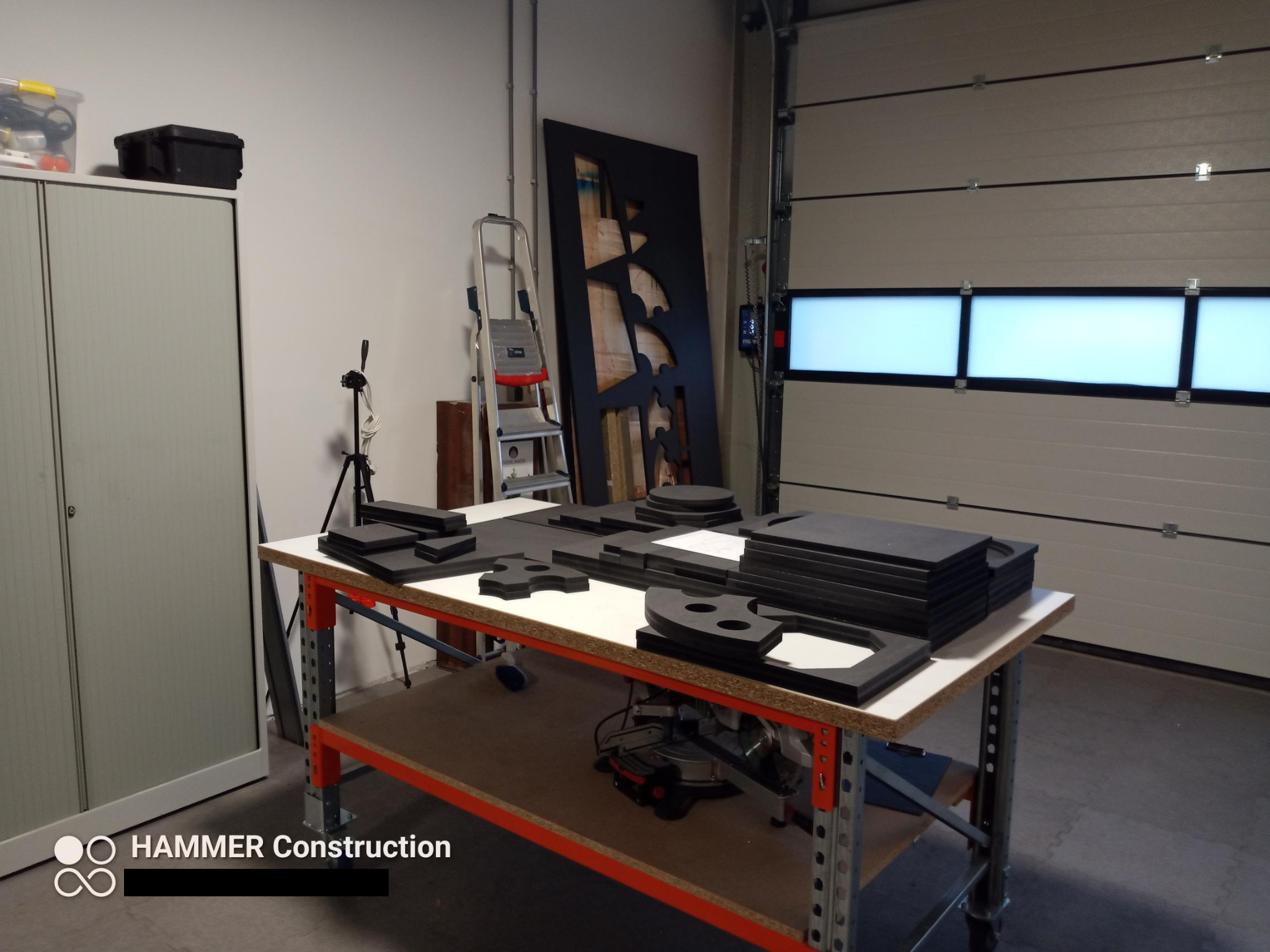

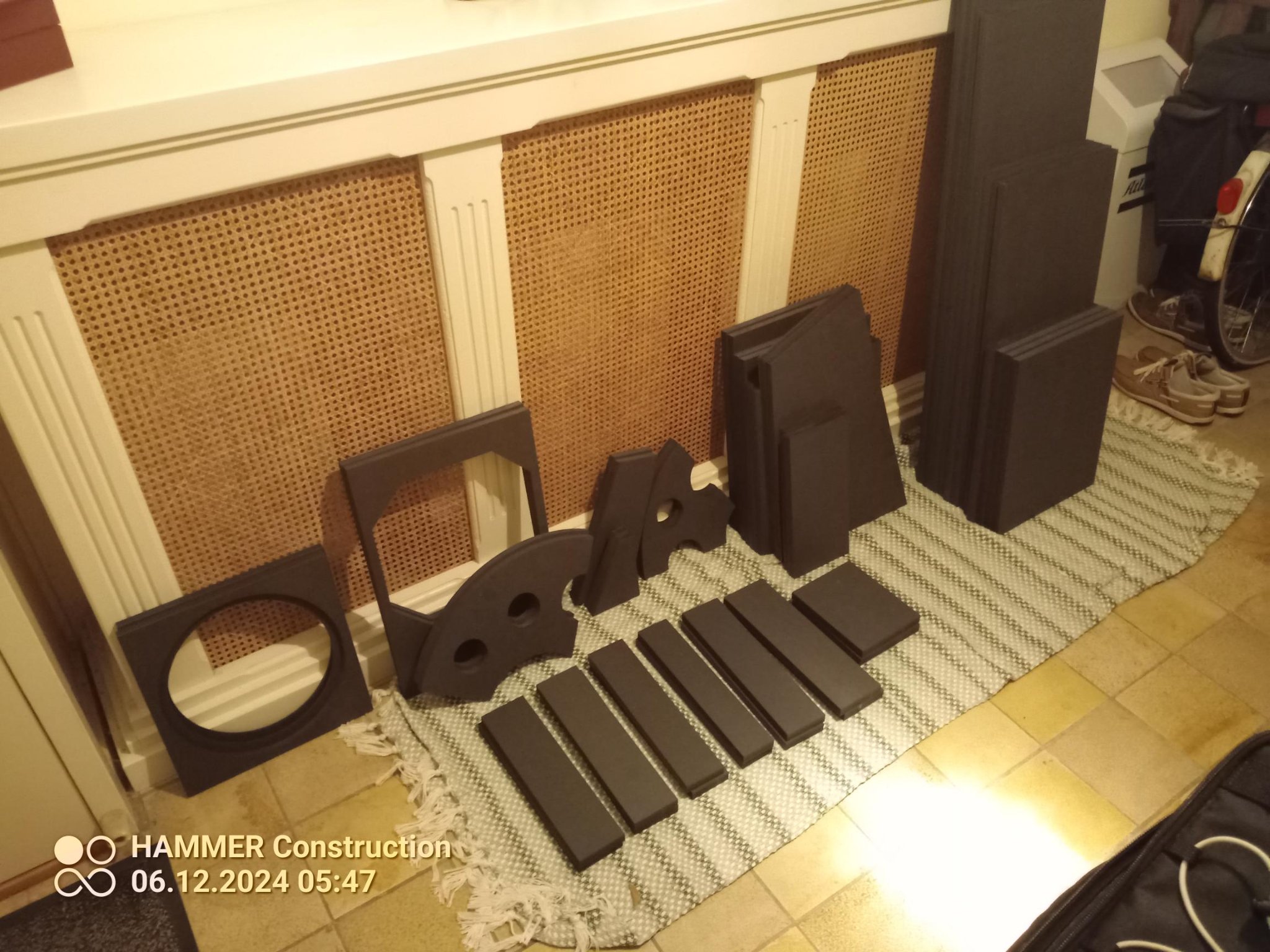

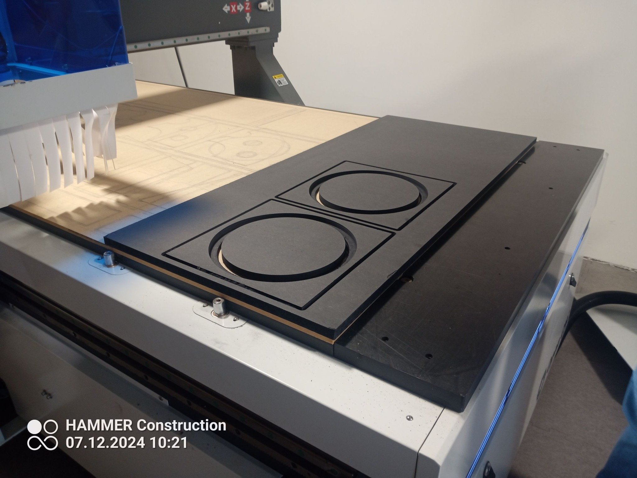

Hi Marcus,Hi John,

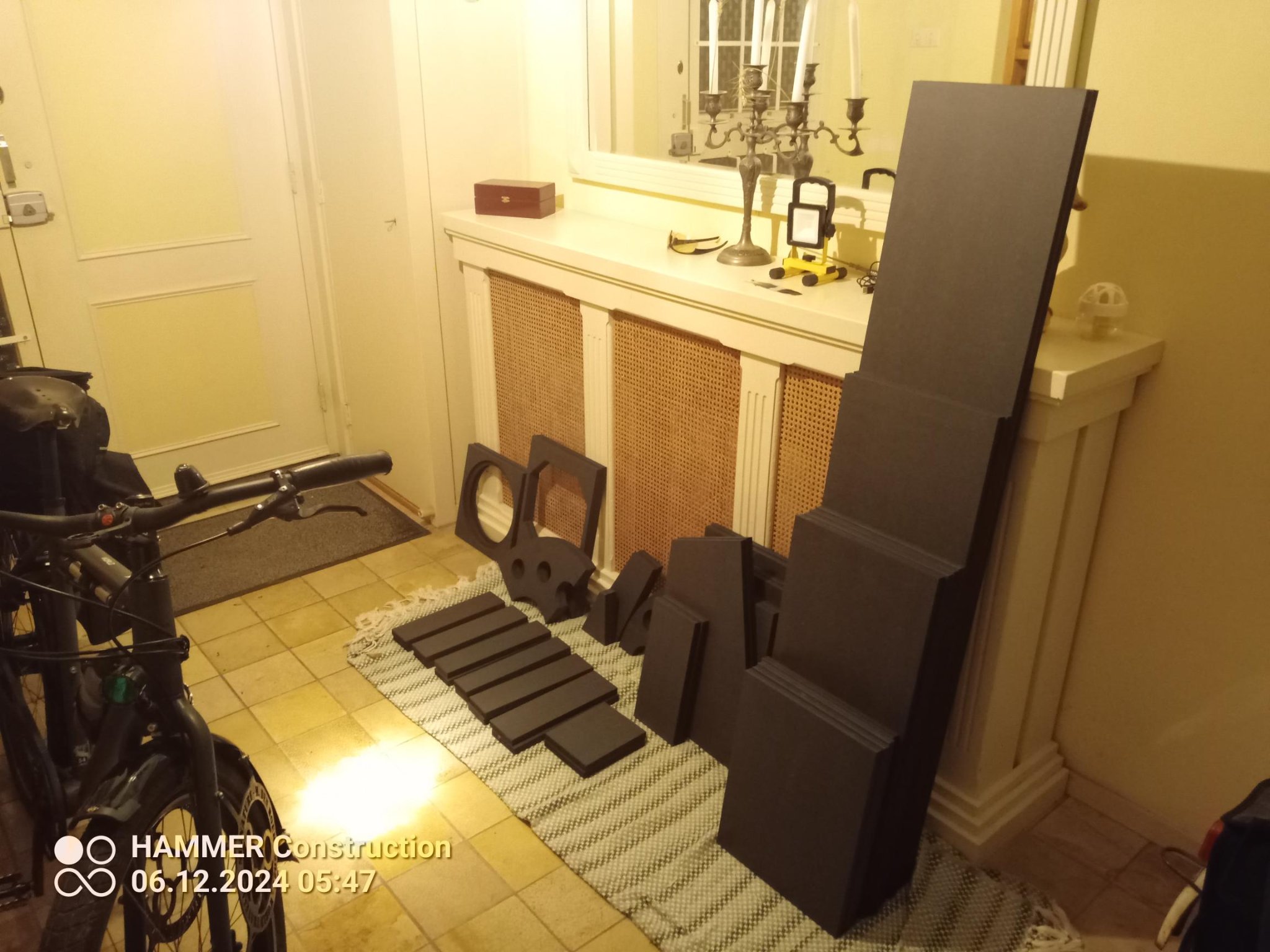

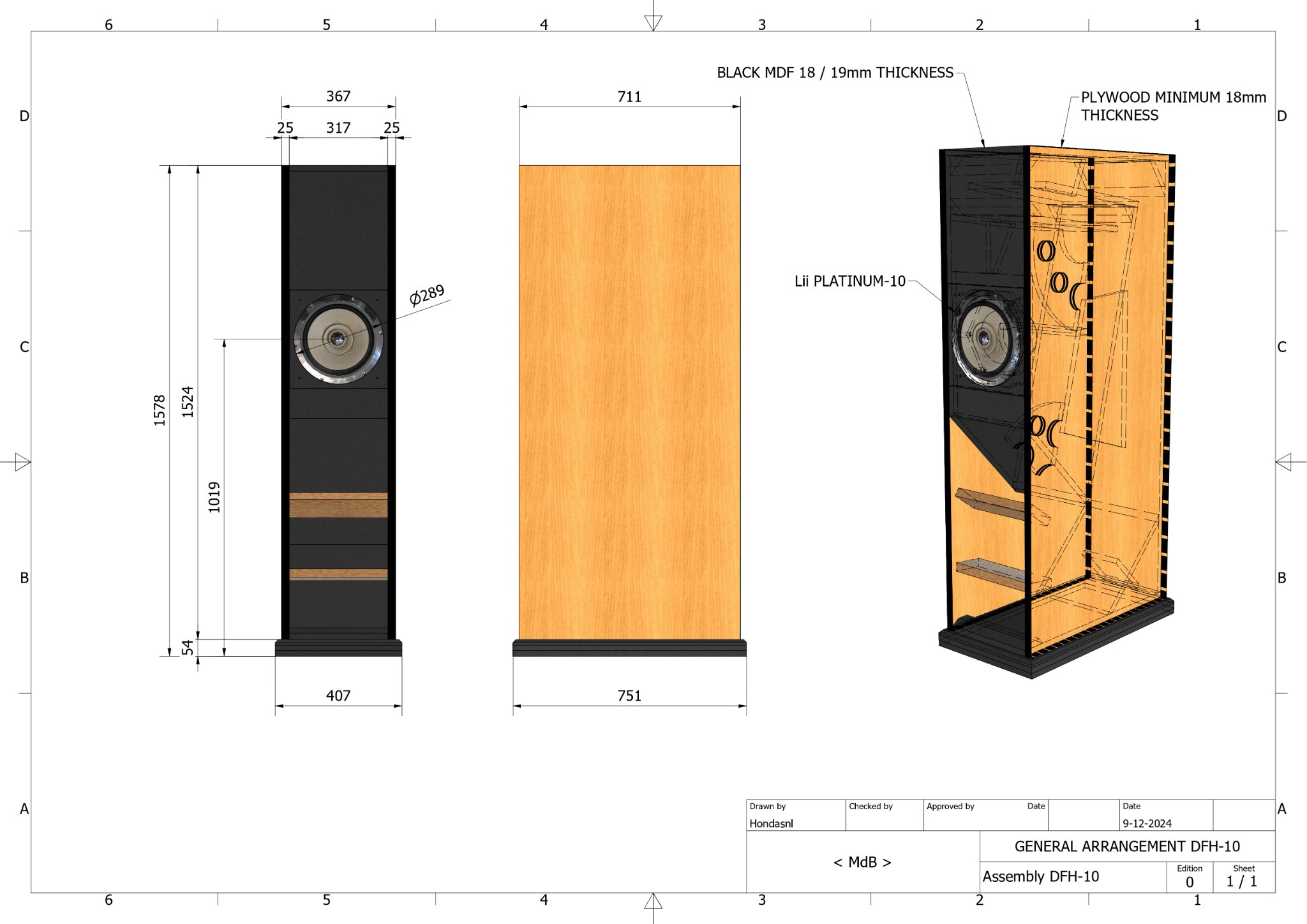

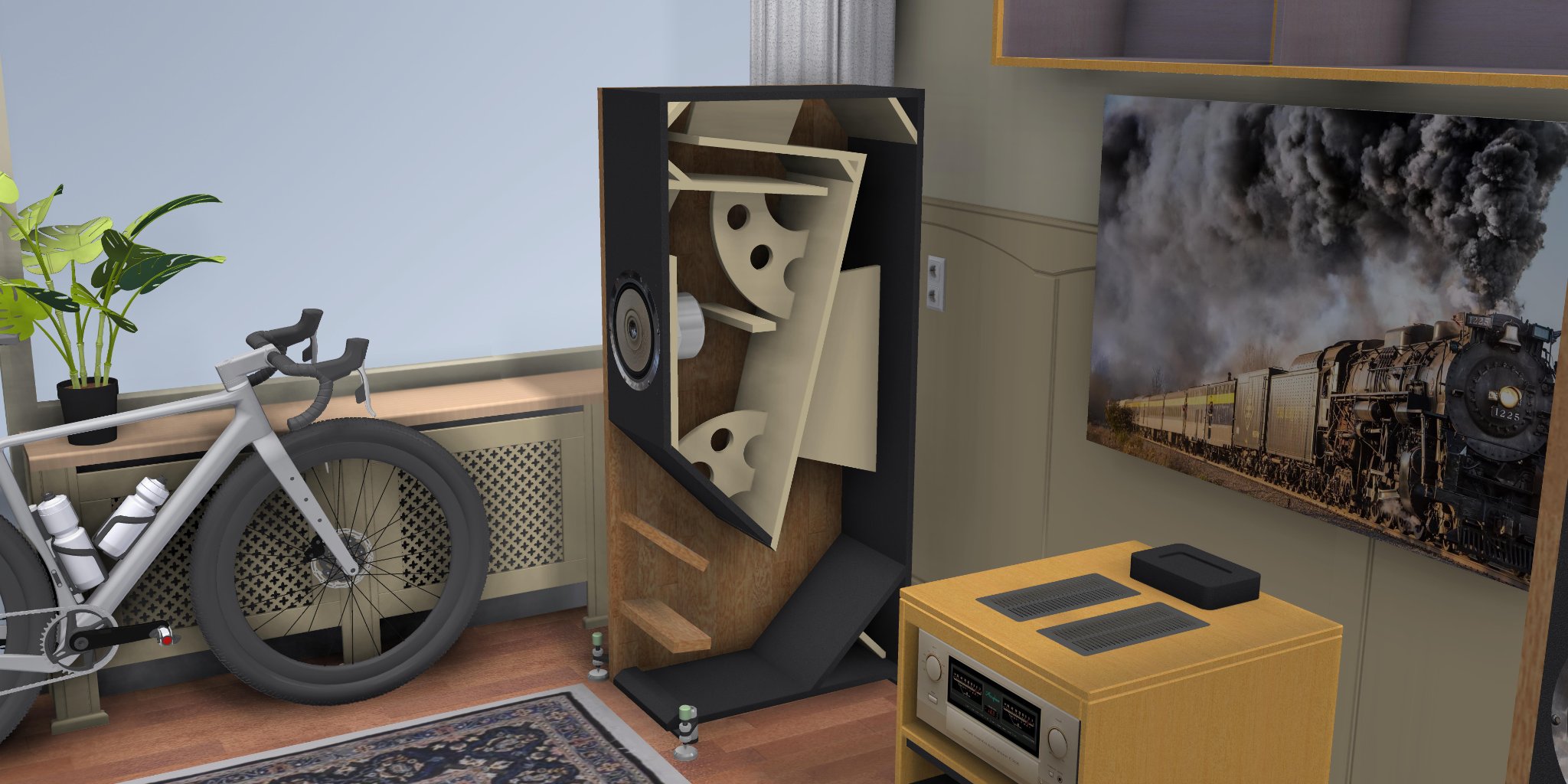

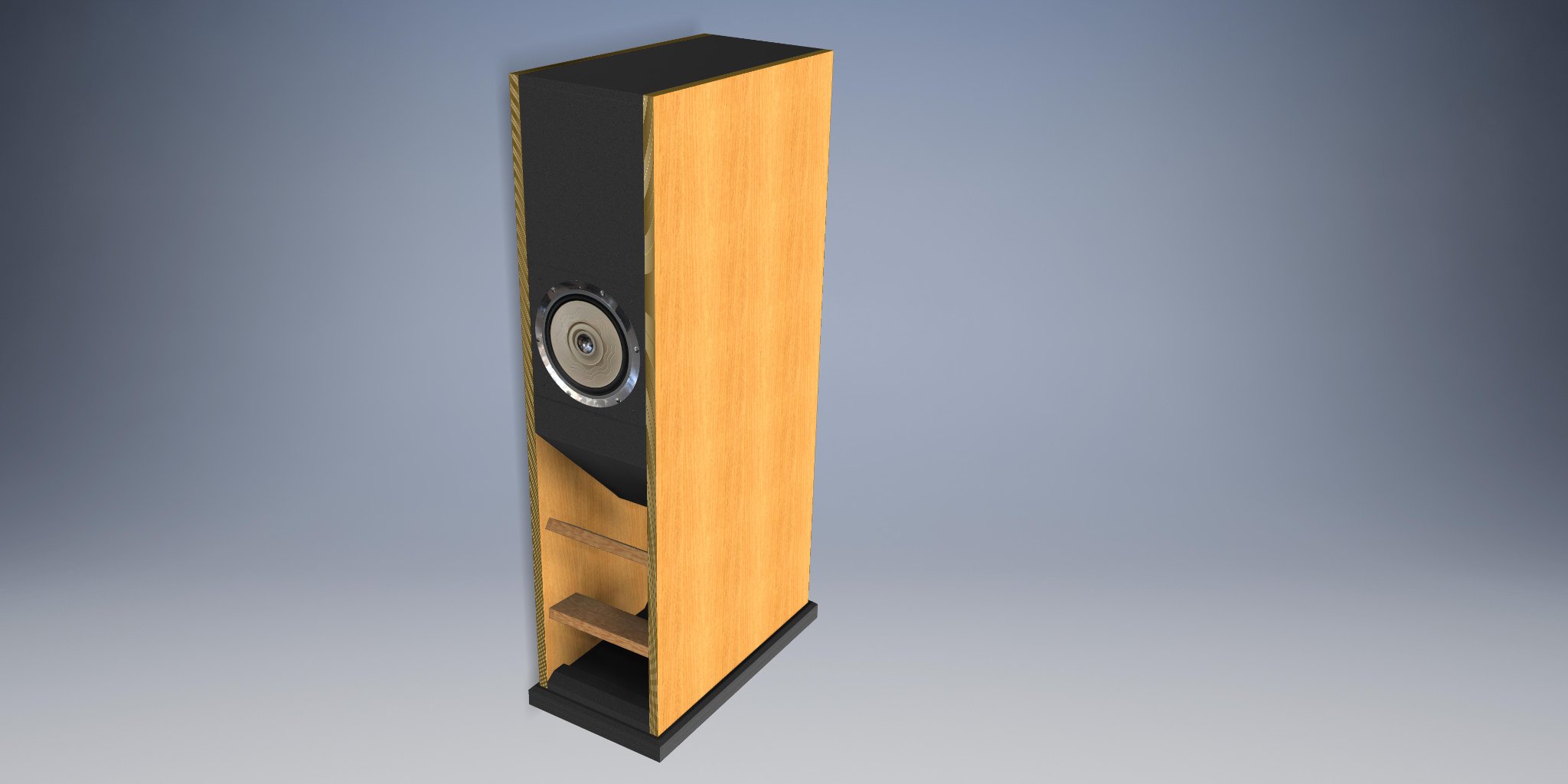

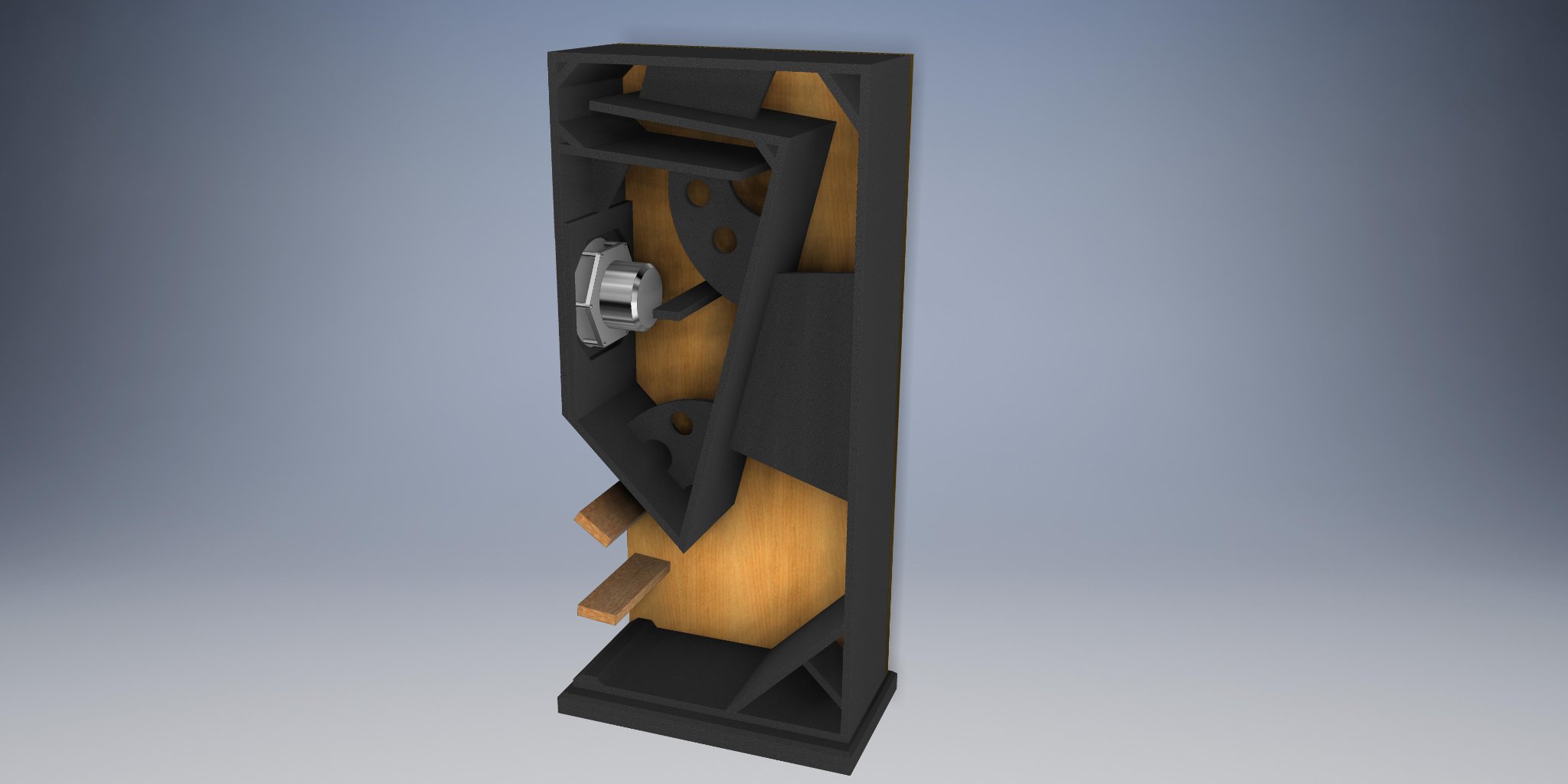

Plan is to make solid stand 3(+1) x 18mm black MDF.

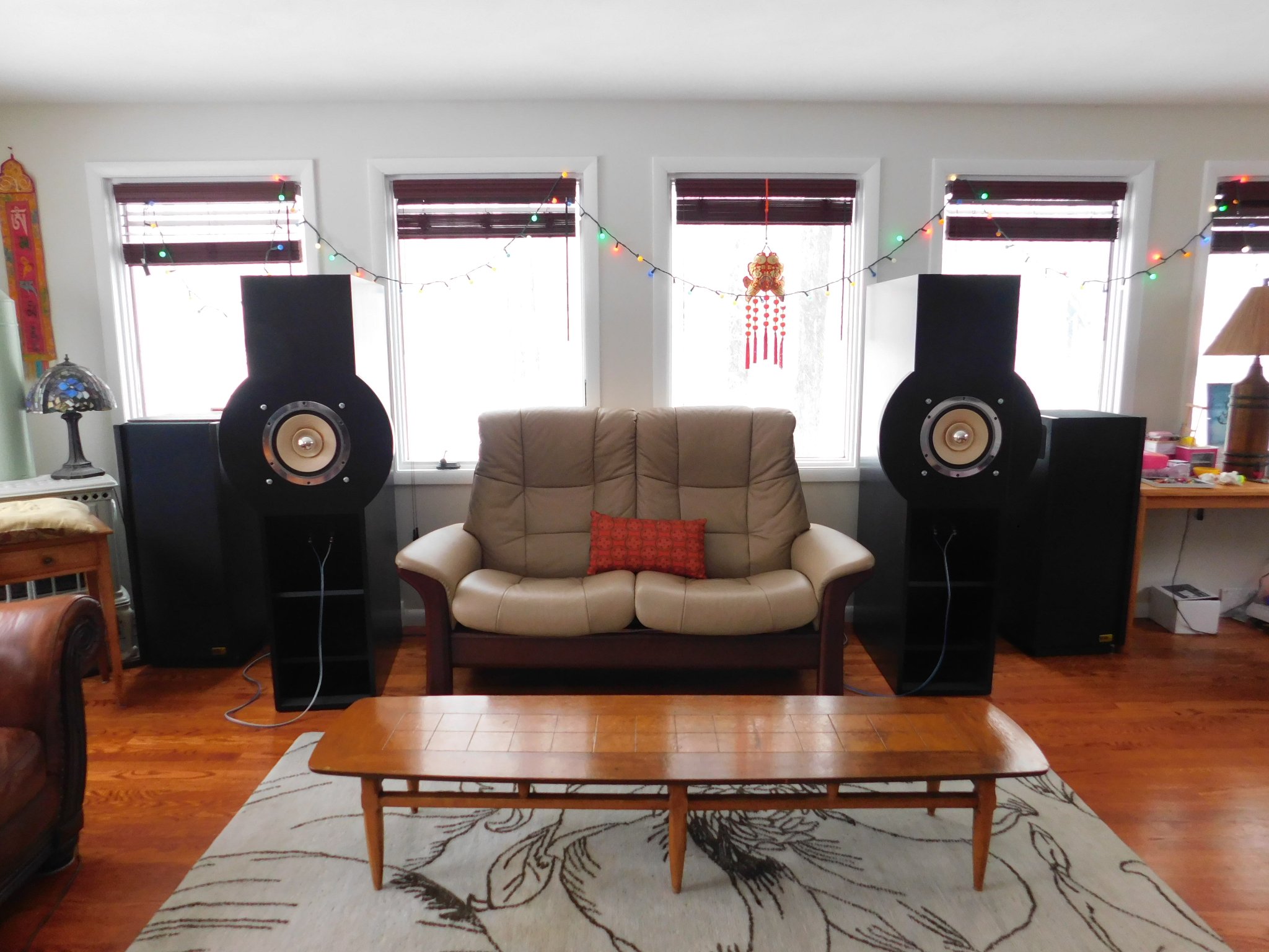

Hi Marcus,
Are you still going to build these Headwreckers? I hope so...

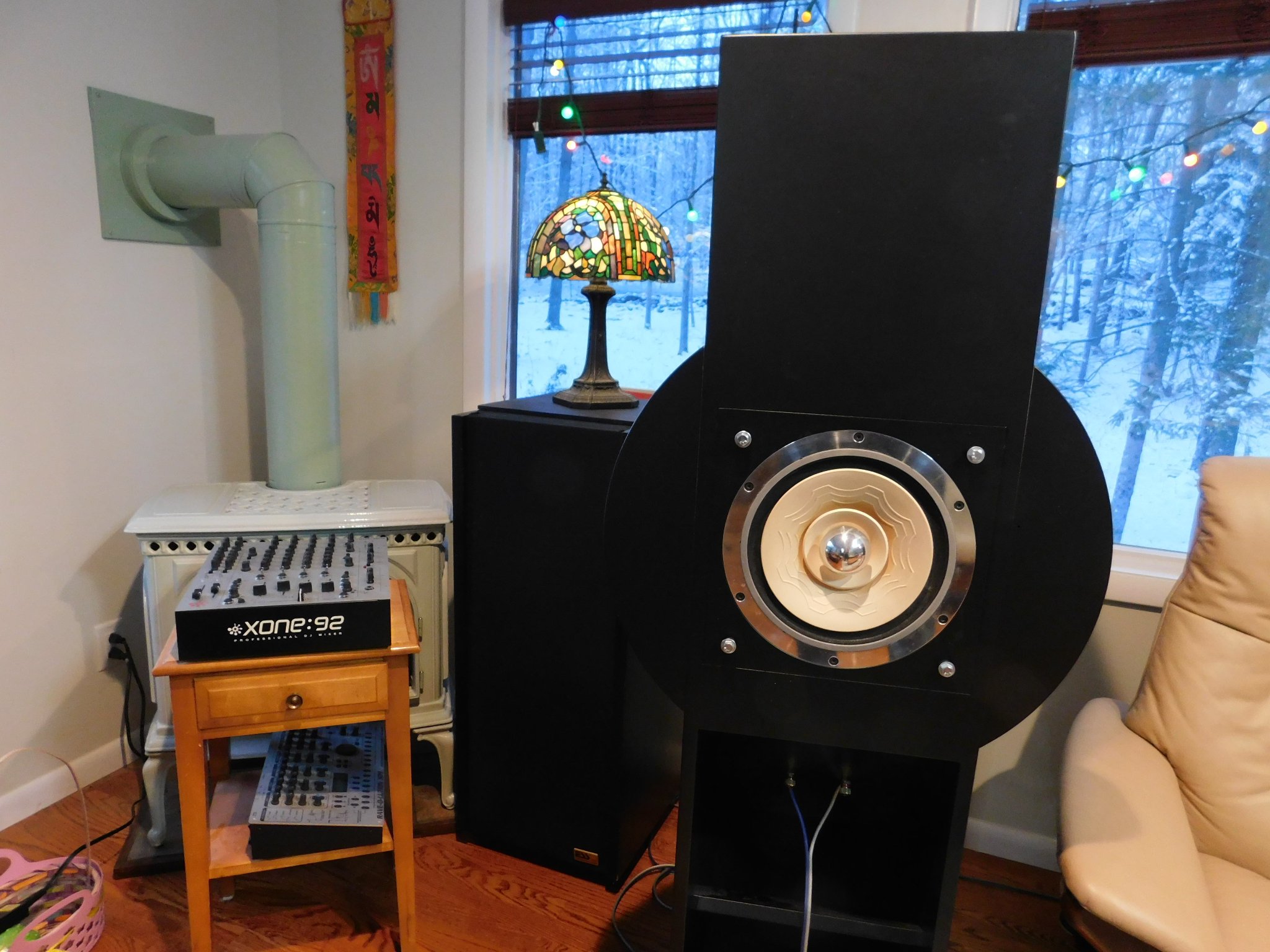

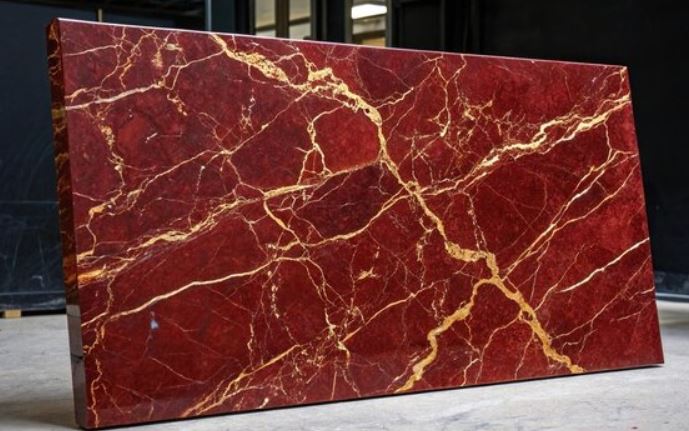

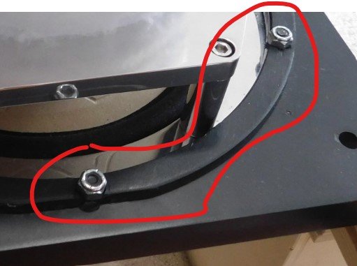

Marcus, Can you make a plan for these cabinets based off what I sent BUT...
The speaker baffle would be the round shape that would be made of stone.
The stone round would be mounted from behind so screws would not show and be replaceable to use optional drivers.
I think this would be beautiful and sound great. I don't have CAD skills but you are very good at it.

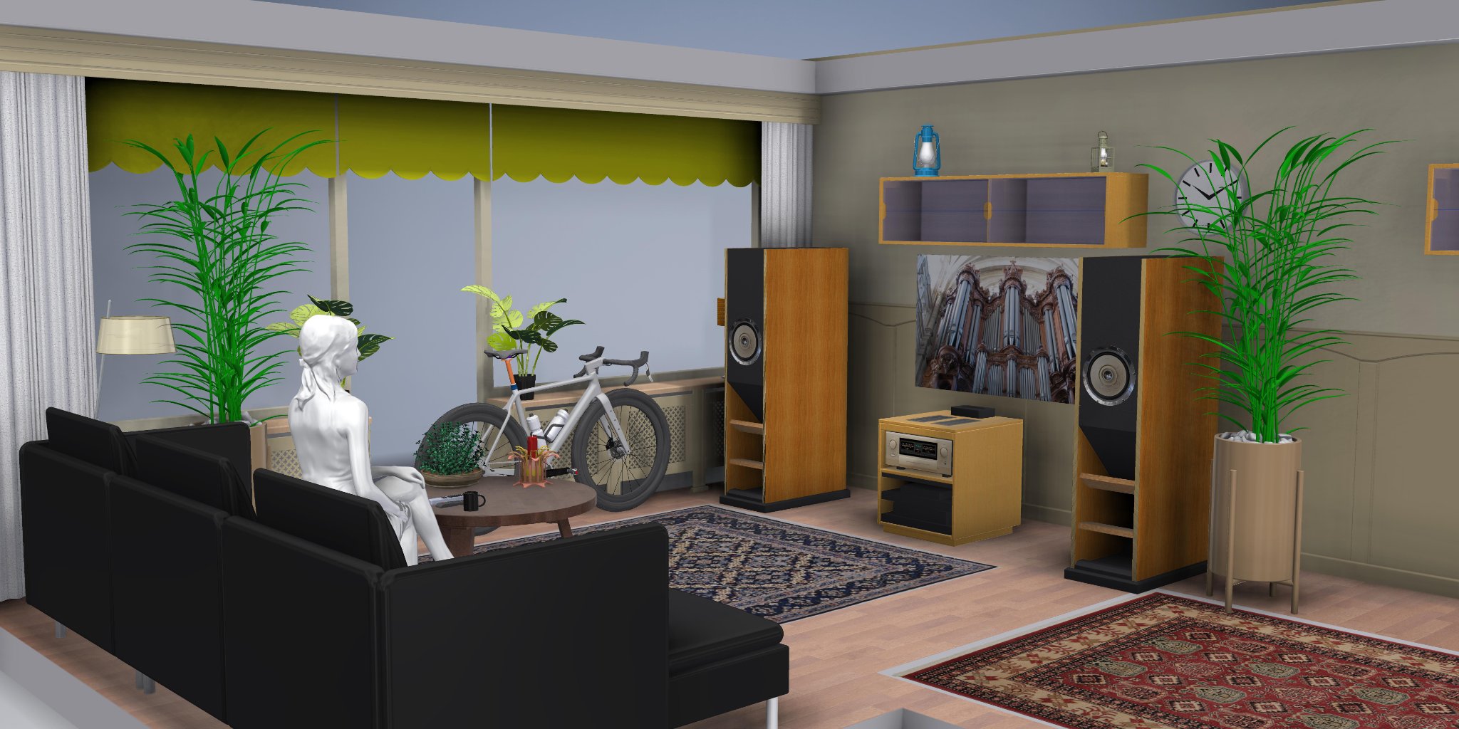

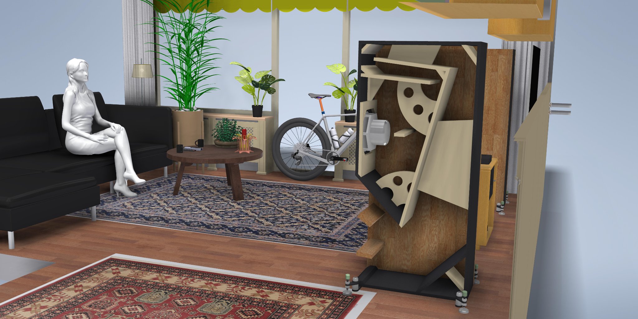

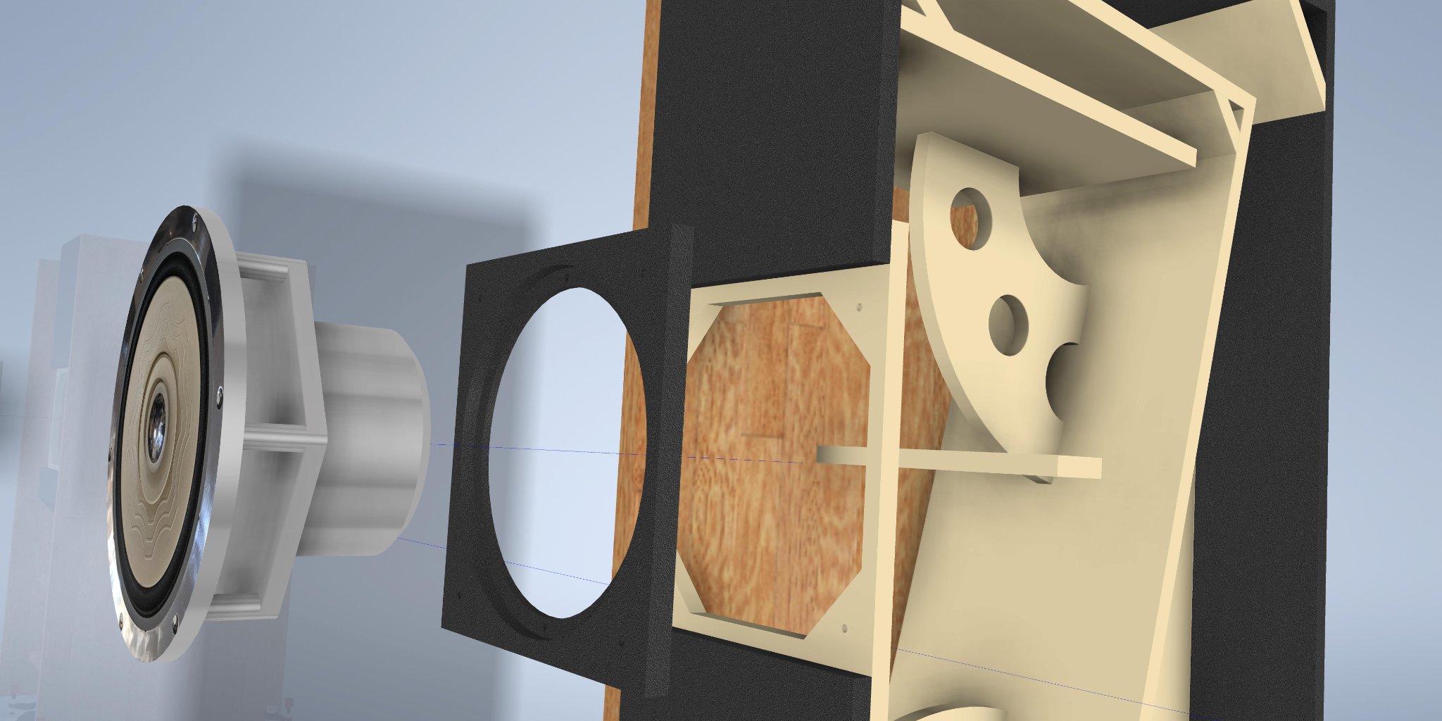

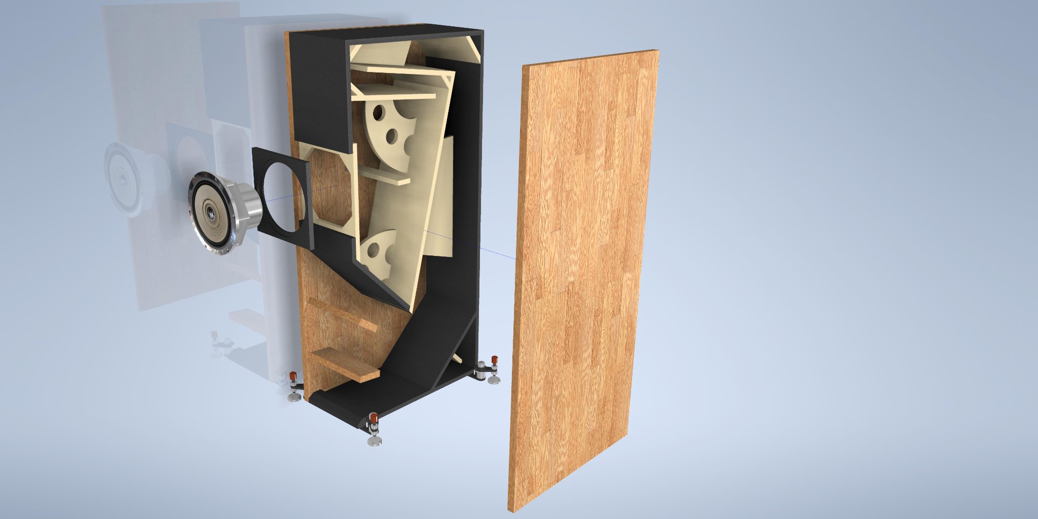

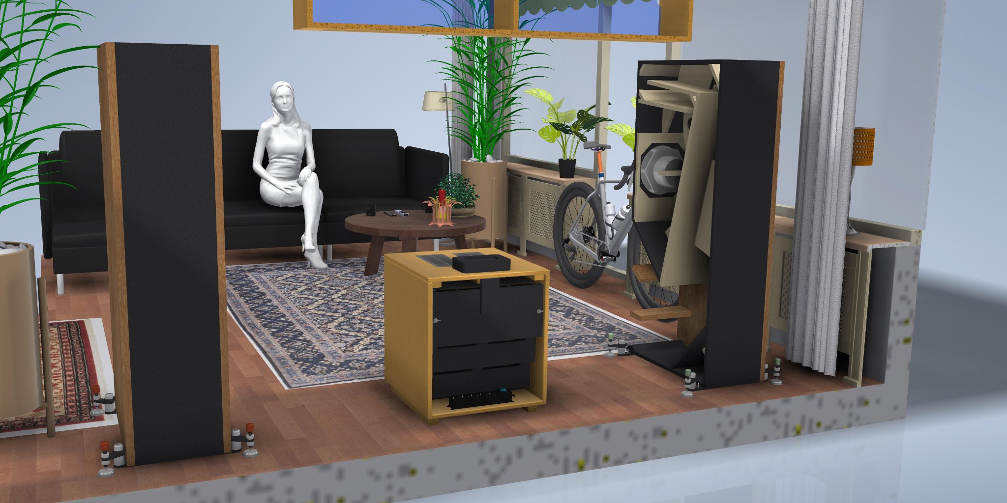

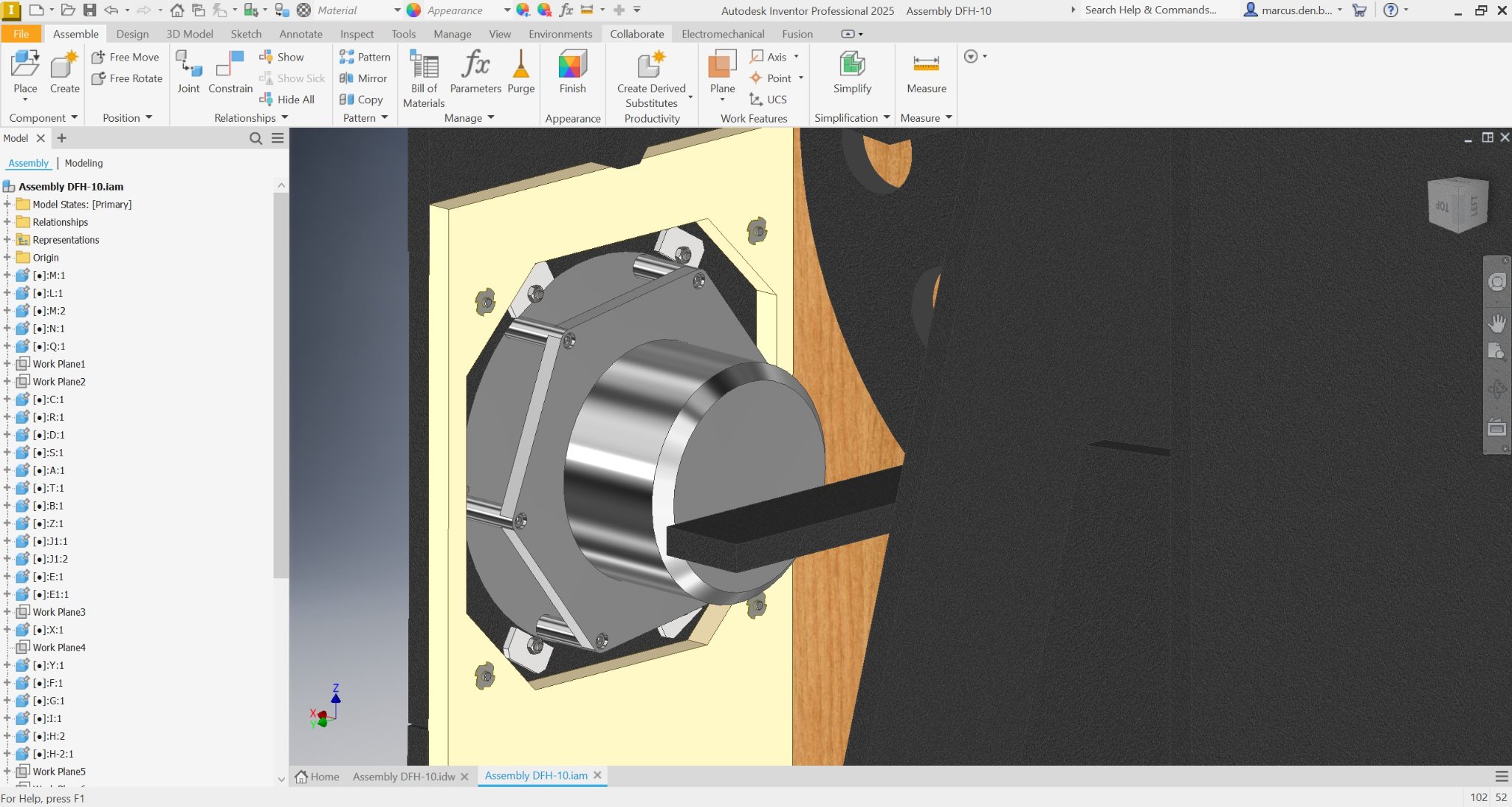

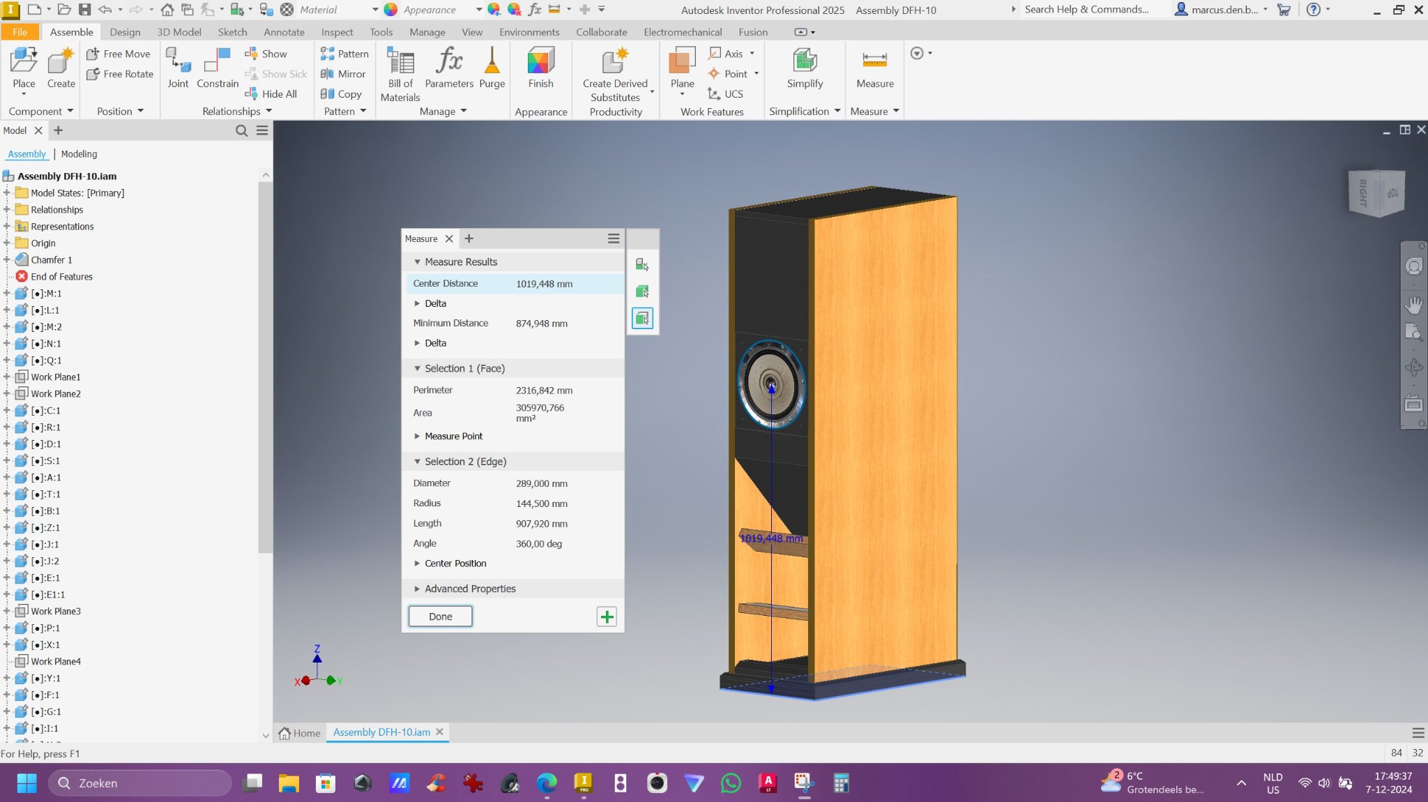

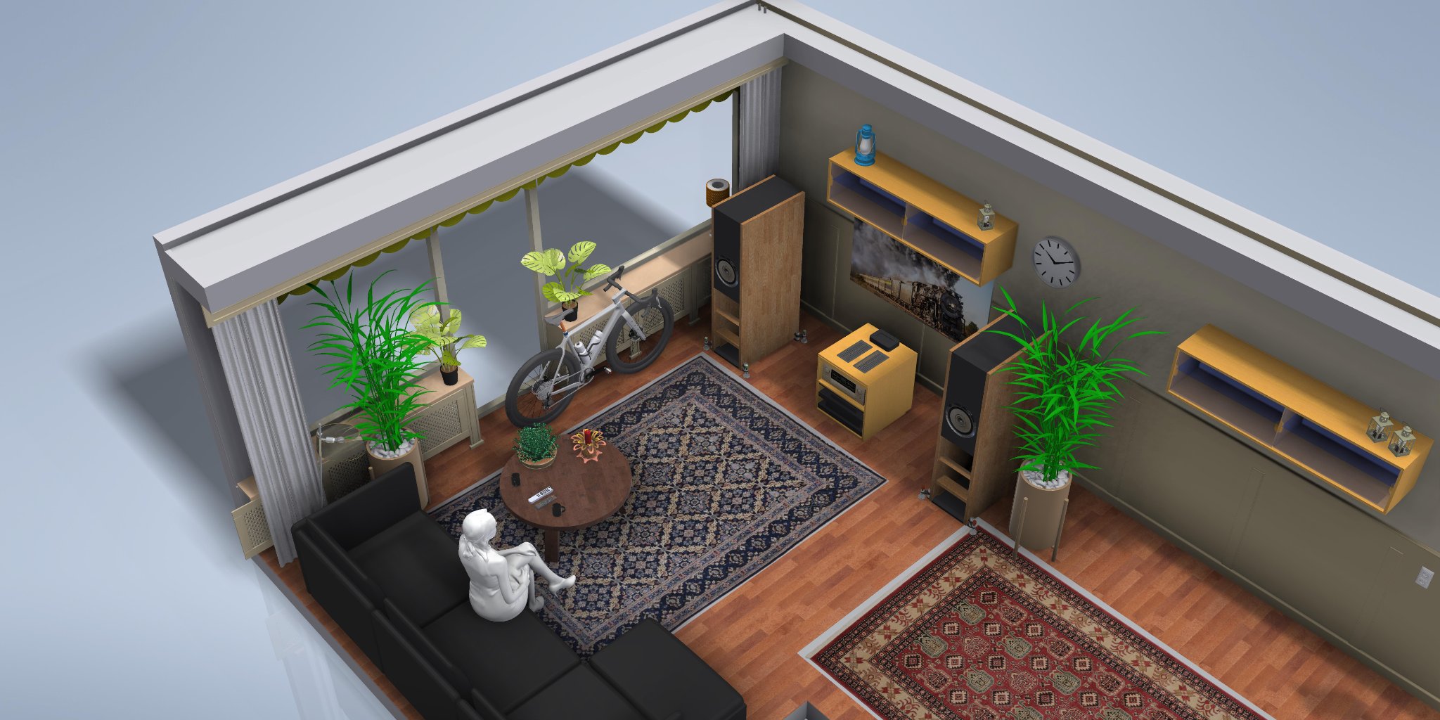

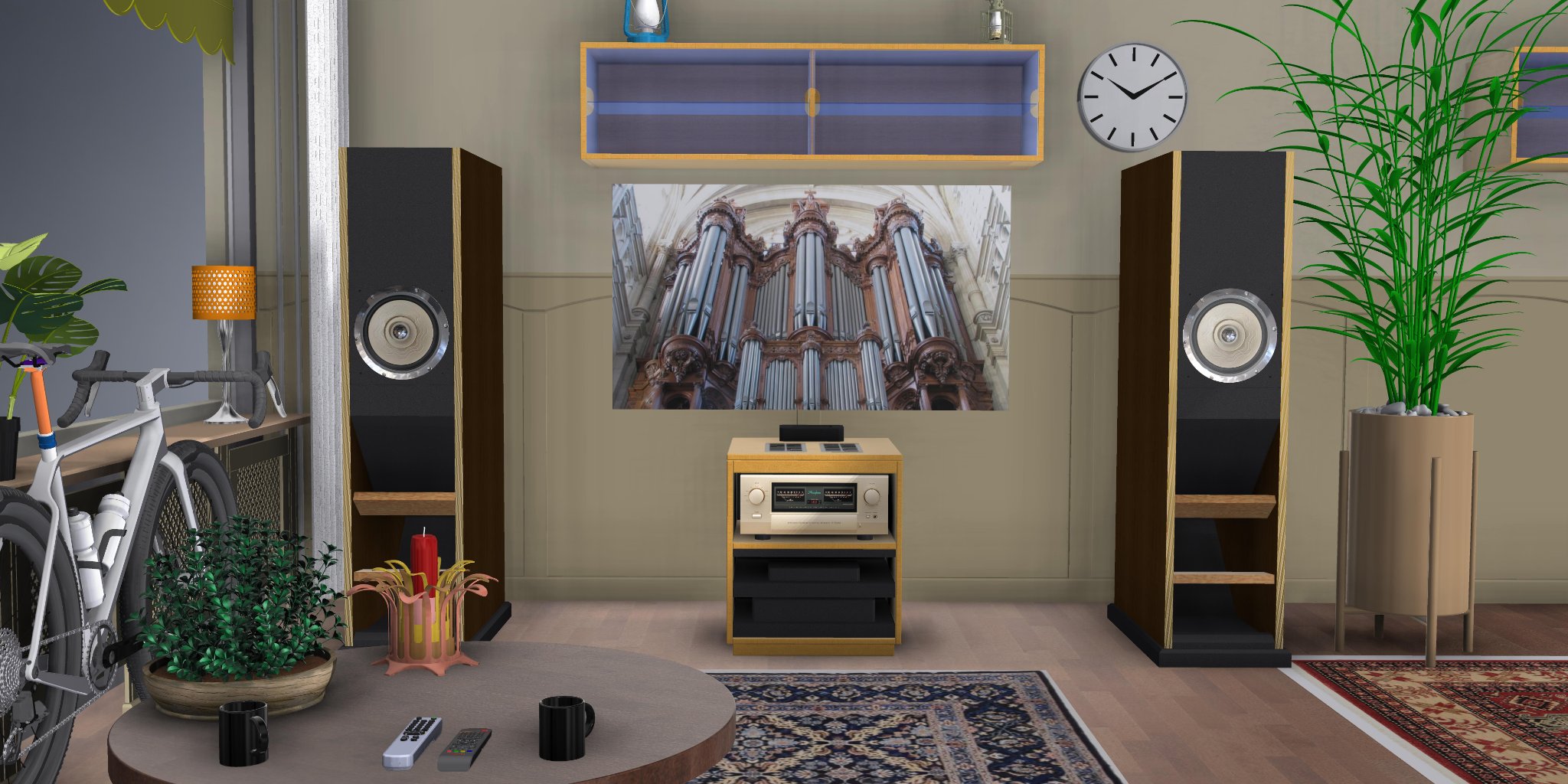

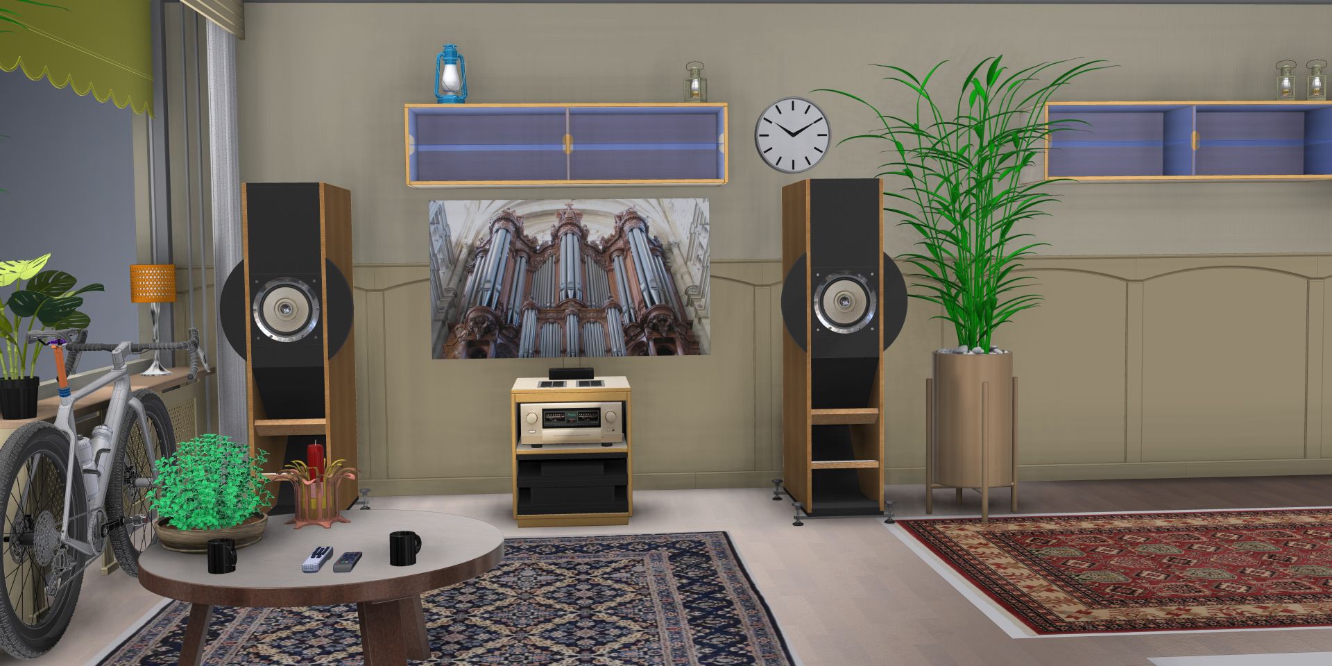

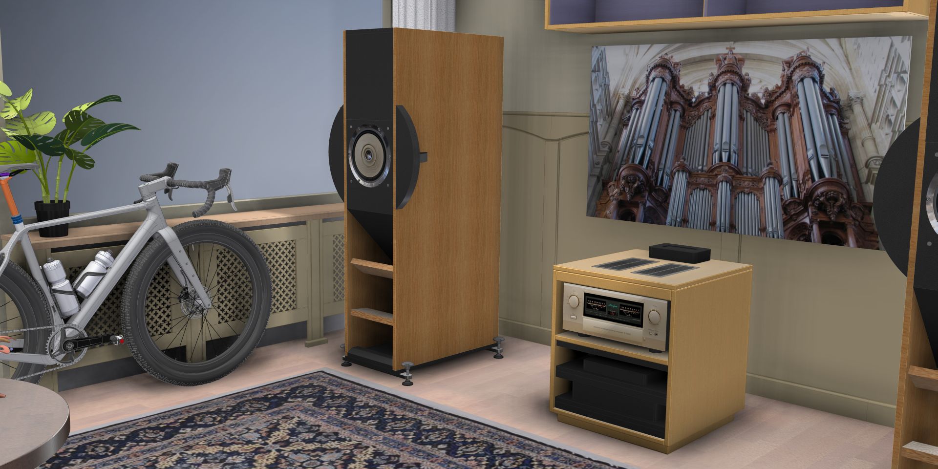

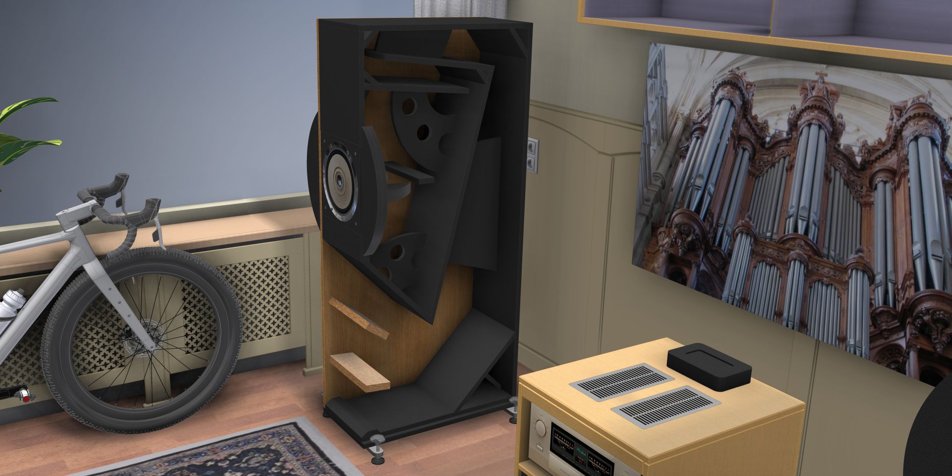

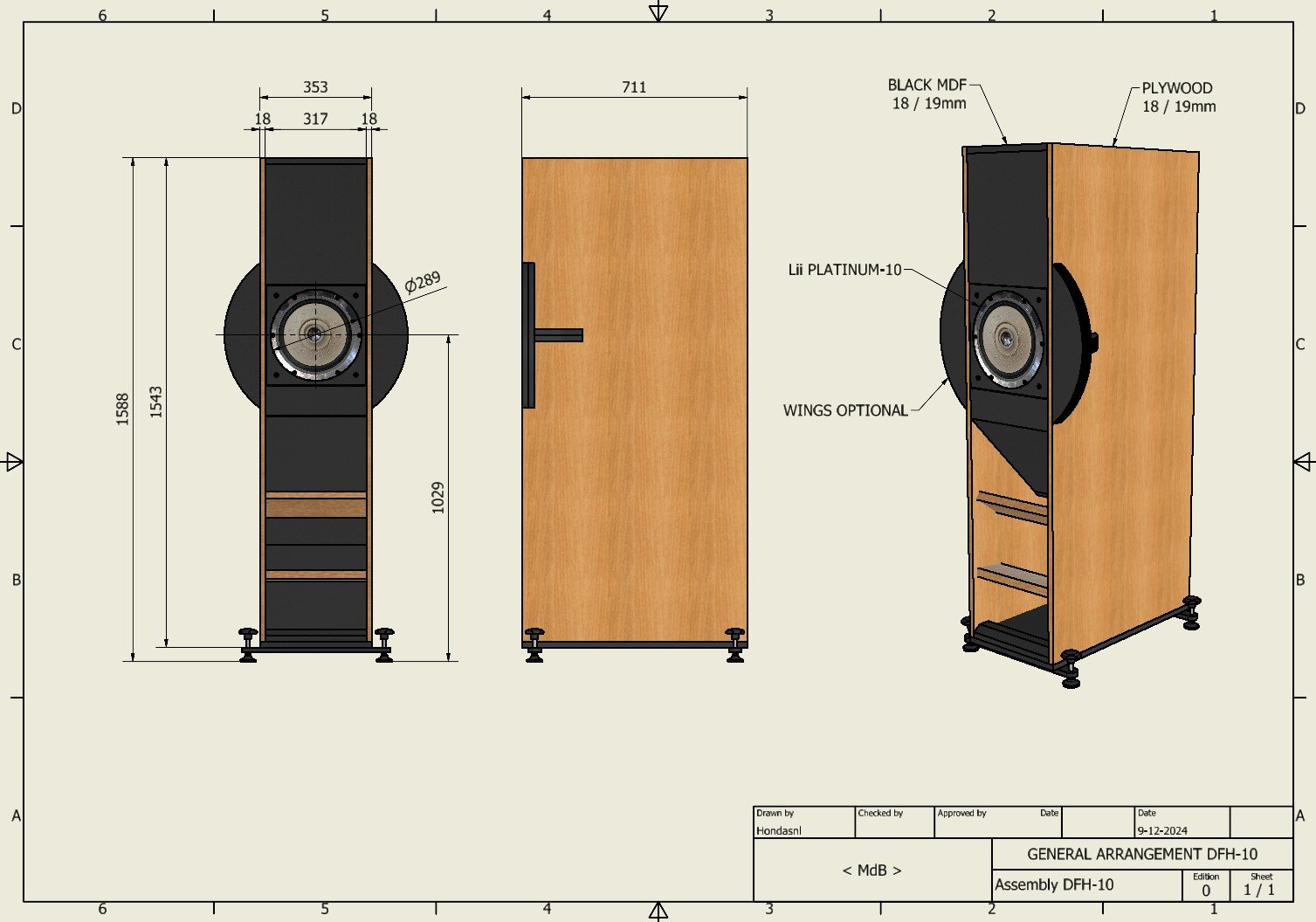

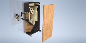

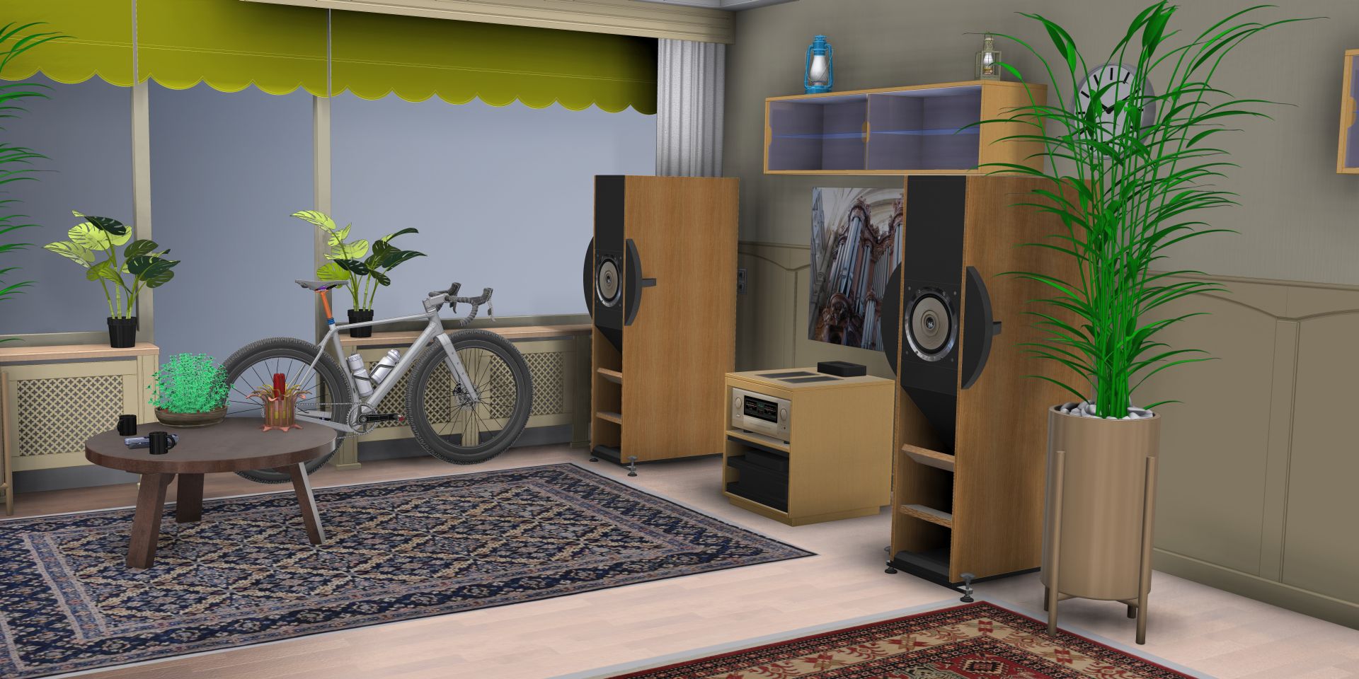

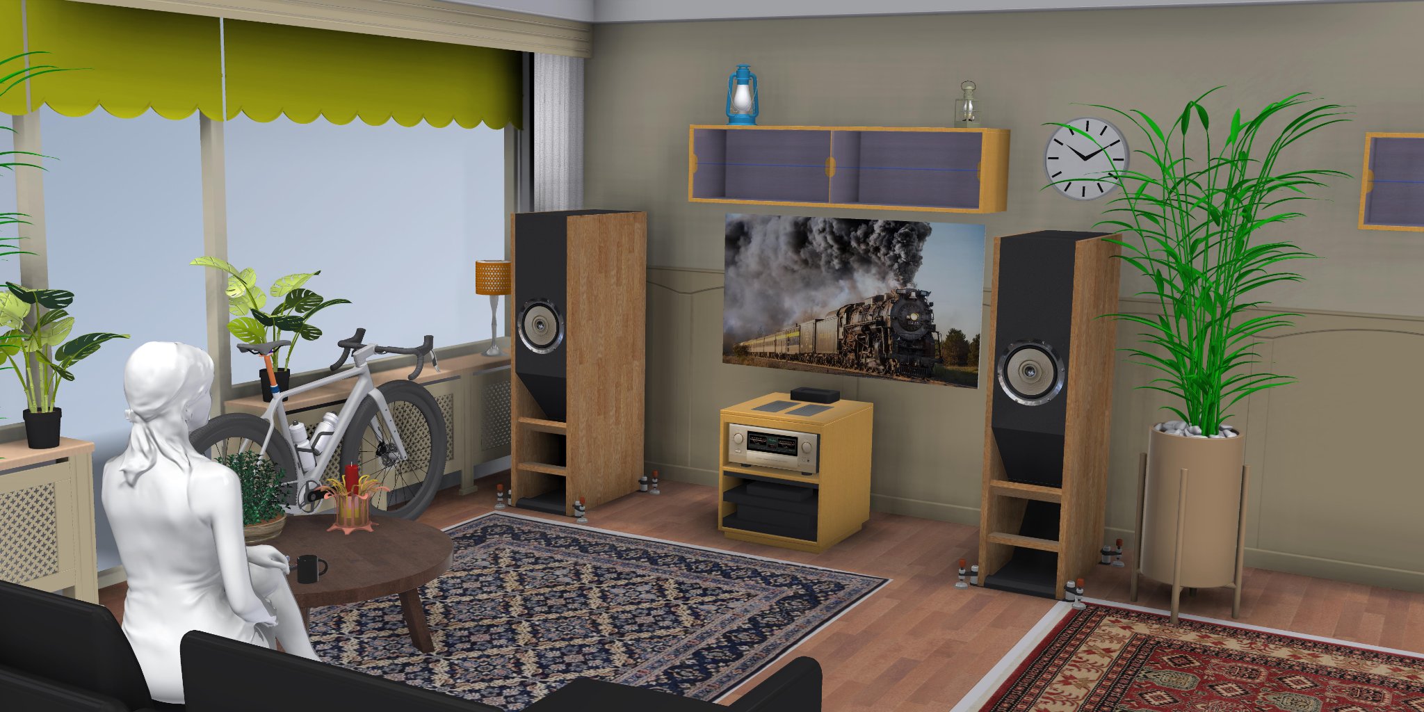

Last plans.

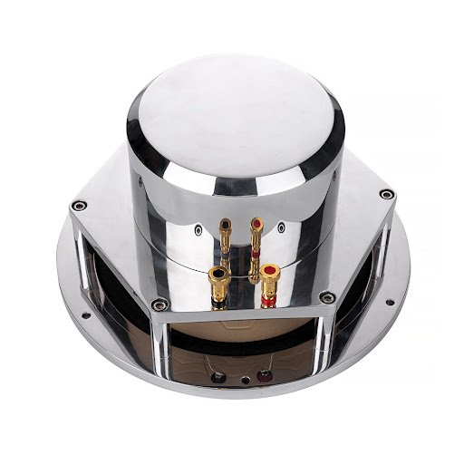

My beautiful amp, the E-5000, can handle these beautiful speakers. No worries.Hi John I will use my current beautiful amp, the E-5000.
Maybe in the future a nice tube.

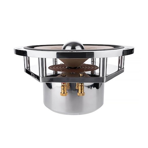

- Full Range
- DFH-10 Clone with the Lii Platinum-10
