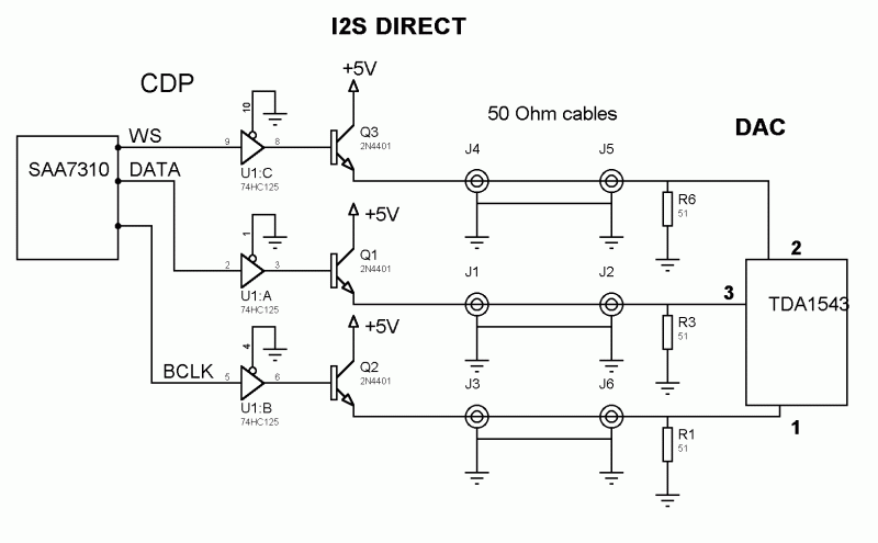

I finally found all three pins by backtracking from the DF1704. They go to a Xilinx XC9536 CPLD. Pin 1 of the DF1704 (DIN serial data input) goes to pin 37 of the CPLD (I/O) and pin 2 of the DF1704 (BCKIN) goes to pin 36 of the CPLD (GTS1 / I/O, some sort of buffer delay perhaps?) and pin 28 (LRCIN) goes to pin 38 of the CPLD (I/O). So, I'm assuming the CPLD takes the data from the transport and probably transforms it in some fashion to prepare it for the DF1704. I'm 99% sure this format is Philips i2s. So, my question is, can I take the output from these locations on the CPLD and pass it to my DAC? I'm not sure how things in the digial realm work, but I'm essentially asking if I can "split" these signals like this and send them to both my new DAC project and the existing onboard DAC (I cannot really "unhook" the existing DAC, so that's why I'm asking as well.. it might also be nice to compare the two).
Thanks so much!
If the DF1704 is in hardware mode, i.e. pin 10 low, the level on pin 3 defines the input data format. It is high for I2S.
As for tapping the signal, it would be best to play safe and buffer the signals before dispatching them anywhere.
rfbrw:
thank you. I think I will buffer using this schematic, unless you have another recommendation:
