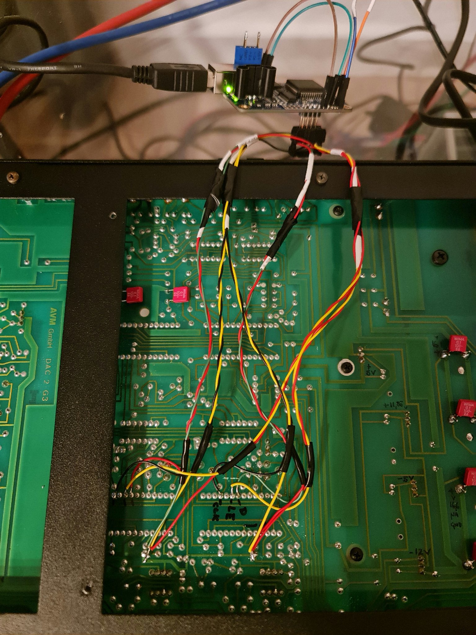

DF1700 to SM5842 conversion board
DF1700 and SM5842 are pin compatible at least for main signaling. Not all pins are compatible and require some modifications.I don't know if DF1700 can be just replaced by DF1704. I think for NOS work DF1700 should be skipped. Direct I2S signal should go to the dac chip.
Jlsound board connected directly to the pcm63. Only 22ohm resistors between them. Now dac is working in NOS mode. I like nos mode. There is no more ringing artefacts.
