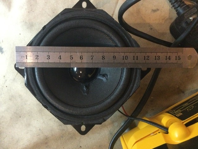

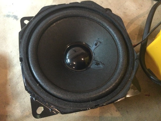

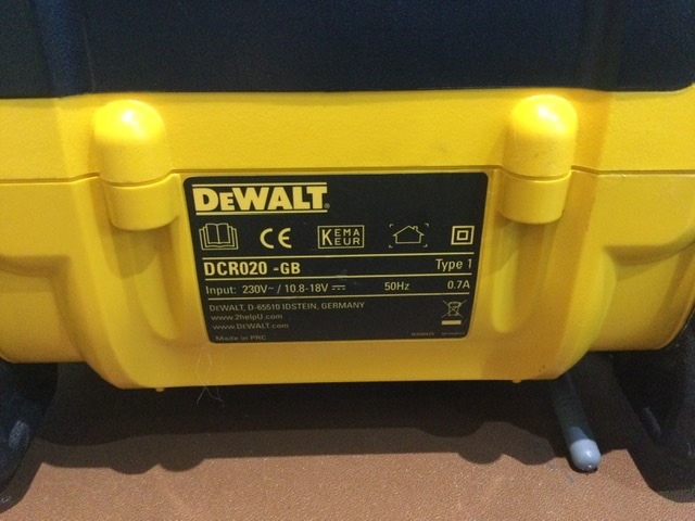

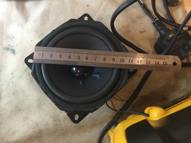

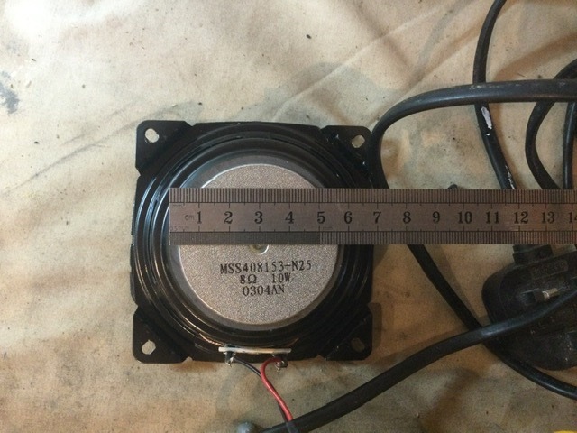

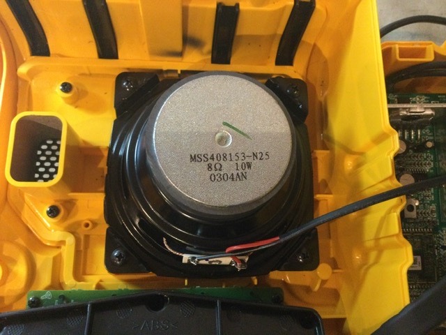

Id like to swap out the speaker on my Dewalt work radio -Dcr020 as it sound muffled and dull compared to my previous standard kitchen radio .
im not sure if this existing speaker is multi range but It sounds too bassy so I need something that gives more midrange and treble .
Can any recommend anything ? I’ve had quick look online and there’s plenty out there inc ebay but I’m not sure about the ohms and wattage that I’ll need to abide too ?
Or if just go for a midrange like for like Will I achieve anything?
Thanks in advance , Scott .

What about a coaxial like the one linked below? The tweeter should add some upper frequencies. You'll probably need to stick to 8 ohm nominal impedance for the speaker as per the original, so a car audio coaxial (which are usually 4 ohm nom.) might over stress the amplifier and therefore isn't recommended.
https://www.nonsolospeakers.com/coa...l-driver-with-34-silk-dome-tweeter-8-ohm.html
A whizzer on such a small driver does not really make sense.
Looks like a 4-4.5” FR. Lots of possible choices.

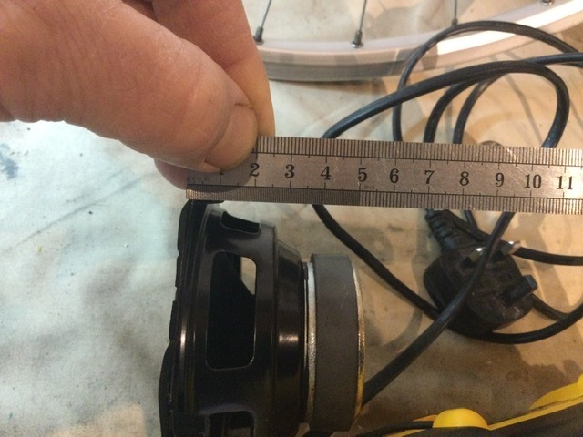

What is the box loading for the existing driver?

First you need to assess if that aspect is coming from the speaker driver. Have you connected this radio up to a different speaker set? Does it sound great? Before you go off and invest in some metal alloy cone FR speaker, only to find it's the radio...Dcr020 as it sound muffled and dull
Whoever designed it likely EQ'd the **** out of the audio signal, as it has to sound good on a job site with power tools running alongside and operate on the tool battery for a reasonable time, considering a work day. Certainly a different environment than a kitchen or living room. You may want to investigate that.

Apologies I don’t know what a box loading is ?A whizzer on such a small driver does not really make sense.

I’d be willing to try another speaker before investing in a new one as it might not be the speaker itself as suggested by jjasniew above , just need to make sure I’m not going to damage anything .
is there a tolererance on the ohms and wattage that I could use / try ?

I’ll have to check on that 👍 , what are you thinking ?What is the space behind the driver. Volume? Vents?

I've had a couple of these work radios apart (admittedly only Makita and Milwaukee examples) and I'm not sure there's a lot of careful design behind them. Usually there's almost no box volume, they leak at multiple places (although there is some attempt to seal the box) and the speaker appears to be EQ'd to boost bass. I just thought it was worth a try with that coaxial or similar as this unit only has one driver, so it isn't that expensive an experiment if it doesn't work.
That said, maybe they do have a driver made for the purpose (tiny volume) and I could be wrong. Some of them sound OK, although apparently designed not to grate at high volumes hence the mellow sound, as some workers would be right next to it and some far away.

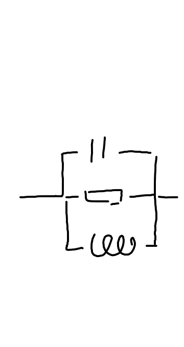

Just try putting in series LCR filter with the existing driver:
2.2uF, 5 ohm, 1mh
And put some damping foam inside the box. Best is fixed foam 2 or 3cm thick on all internal surface.
Or some white baf wadding in the middle of the box if you have no foam at hand.
2.2uF, 5 ohm, 1mh

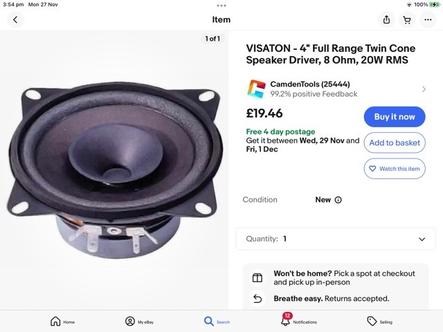

Visaton drivers are not bad in general. But they are the exact example of german engineering: squeeze everything from simple and cheap materials.
My selection would be polypropylene waterproof cone drivers, like this one https://www.visaton.de/sites/default/files/dd_product/FR 10 HMP_4880.pdf
