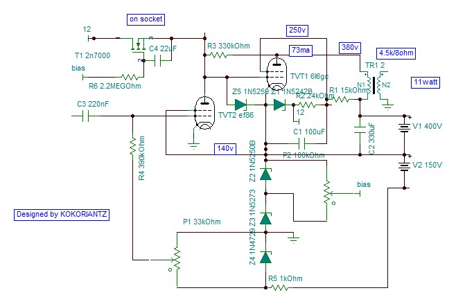

Devices with high Early Voltage
It is not a ccs but a gyrator.
