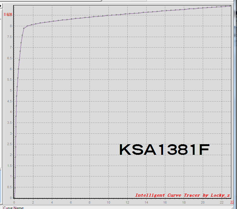

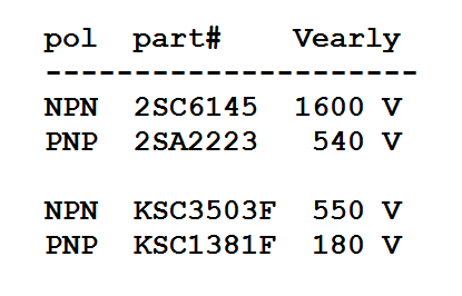

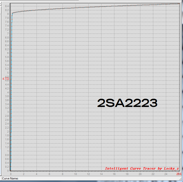

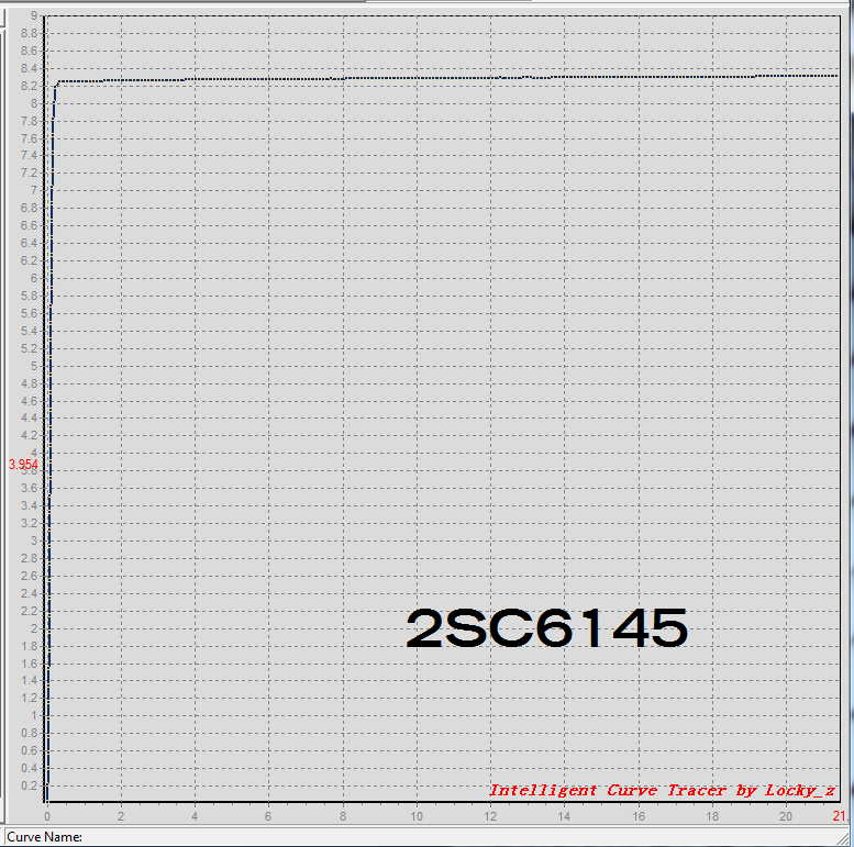

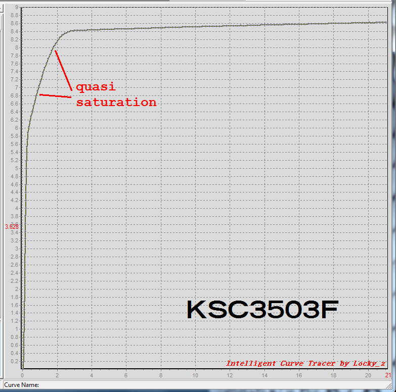

The highest Early voltages I've ever seen personally, were measured on the 2SC6145 (NPN) and the 2SA2223 (PNP). At least in my own testing, they masured higher than the previously-mentioned KSC3503/KSA1381 pair:
attachment.php
I-V curves below. The Early voltage is a measure of the "flatness" of the curve at high VCE. The flatter the curve, the higher the Vearly.

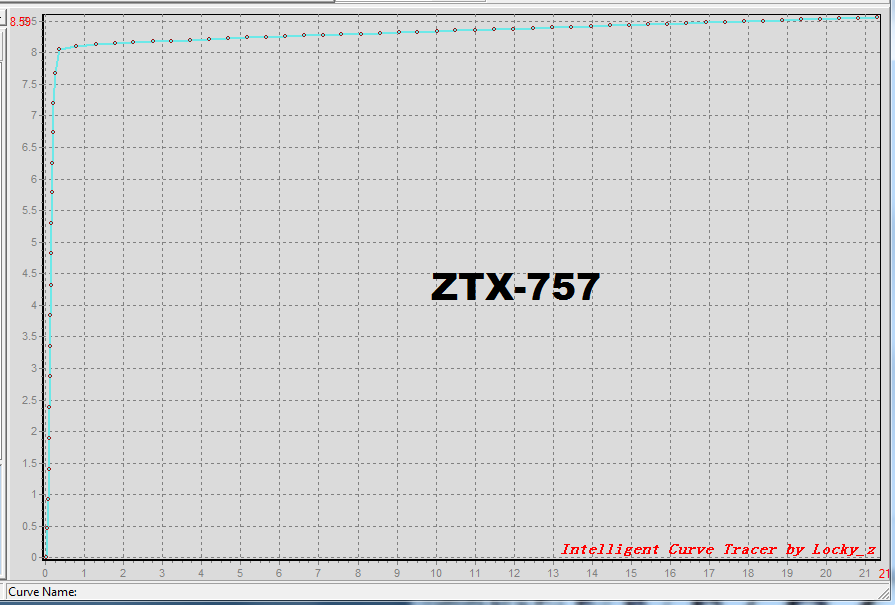

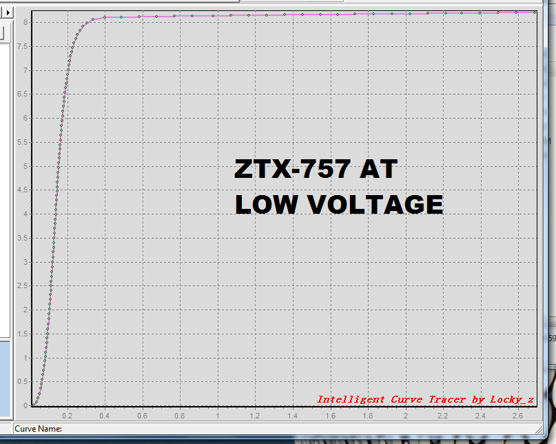

Here's a bipolar transistor with a reasonably decent Early voltage. You can extract a pretty good numerical estimate of its Early voltage from the plots, simply by using good old Algebra-1. Slope = rise/run ; Y = (slope * X) + intercept
  • Vearly = [I1 * (V2-V1)/(I2-I1)] - V1
The choices of V1 and V2 are completely arbitrary; the ones I often use are 6.0V and 16.0V. Why did I pick those? because their delta is 10V which is an easy number to punch into a spreadsheet or pocket calculator!

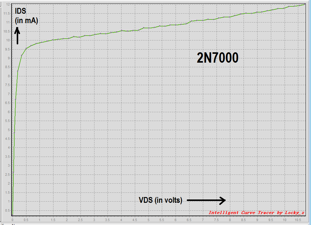

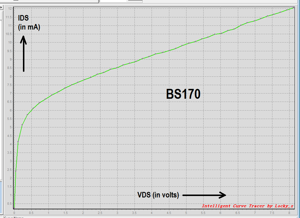

Immediately above, diyAudio member kokoriantz writes
There are lot of mosfets with very high early (impedance) , as the most common 2n7000.
I decided to measure that. 30 minutes ago I put two different MOSFETs on the curve tracer, a BS170 and a 2N7000. As you can see from their datasheets attached below, both of these are small signal devices in the TO-92 package.
Measured output conductance gds = (dIds / dVds) is quite high, which means that output impedance rds = 1/gds is quite low. These devices do not behave as kokoriantz predicted.
