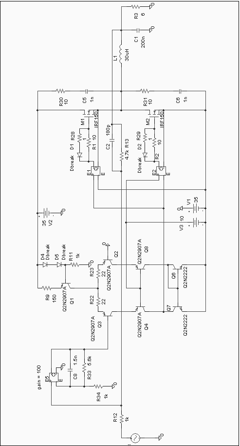

How did you go about playing with the gain of the loop without effecting the overall gain of the amplifier? Just a change in the RC portion of the loop?
By adding an LTF of the following form into the forward path of the circuit :
H = A0 * (jwT1 + 1)/(jwT2 + 1)
The netlist I sent to Bricolo already contains it
:devilr: , hope he didn't get too confused. The additional circuit has a gain of 5 up to 20 kHz approx and then falls to 1 at about 100 kHz. Even though it is basically flat above that it has enough phase-shift at the switchibg frequency that the feedback cap has to be redimensioned if one doesn't want the switching frequency to drop too much.
I wasn't able to find Johan's double loop topology but I assume he does something similar.
For better understanding I post the schematic here (PSPICE users can mail me for the .SCH file).
Regards
Charles

Aaaaaah this one !!!!
Yes, definitely !!!!!!
You just have to use a resistor in series with C2 and another resistor parallel to said series RC circuit.
This would give an elegant all-IC solution (apart from the output stage of course) when a gate-driver IC is used. I would use a dual Op-AMP so there is one left to be used as a differential input buffer.
BTW the very same circuit can be used for carrier-based class-d amps with feedback takeoff from the filter, if dimensioned differently (hint: PID controller) !
Regards
Charles
