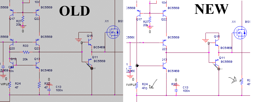

I've build an amp based on the schematis I've posted earlier in this thread (page 55). Additionally short circuit protection has been added, to prevent failure.
It's build of 95% smd components and all hand made, even the pcb.
The losses are quite low. Each mosfet dissapates >1W at zero output and a few watts at full load.
The modulation is done kinda Mueta.
Switcing amp review 9:

What about losses in the output filter inductor? Looks to me like a standard Toroid? In my experience the losses here are too high.Is there an air gap?
What is the switching freq??
By the way can you be specific about the post number where the schematic was and not the page number.
If you refer to the post number, when you say page number, it is probably wrong. There is a schematic in post #54 though.

sovadk said:I've build an amp based on the schematis I've posted earlier in this thread (page 55). Additionally short circuit protection has been added, to prevent failure.

To koldby
The schematic is in post #544.
The loss in the output inductor is very small. The series resistance is arround 20mohm which gives 1W dissapation with 200W into 4ohm. The core is Micrometals T106-2 wich has a very low loss. For this application the matrial of this core is outstanding, however the permittivity quite low, so it requires ~40 tuens for 22uH. According to Micrometals design software the core loss is 0.44W @ 200W into 4ohms. I haven't noticed any real temperature rise of the inductor, even under high load conditions.
The real reason why I chose this core was because of it's linearity and availability @ ebay.
The siwtcing frequency is ~300kHz.
T106-2 @ Micrometals
To KLe and SSassen
Thanks for the comments.
The distortion is arround 0,1%, but the mesurement is from an earlier review, so I can't really tell. I've done simulations with added PID feedback, which can supress errors further by 35dB @ 10kHz and more at lower frequencys if desired. Theorytically this should give a distortion figure of 0.002%.
About the frequency responce. According to simulations it should be totally flat and load independent, wiht a bandwidth of 60kHz. I haven't done any mesurements to confirm this.

Hi Sovadk,
Do you have problem with symmetric output? I simulate your amp and found that the output is not balanced. I see also that your high side gate without resistor. It may because the high side gate turn on lately than low side gate.
Is there no problem with that?

I have experinced some DC supply pumping which increeses with the output load. This causes increesed distortion and higher supply voltage which can be critical (breakdown voltage might be reached).
The reason why the unsymmetry has an affect, is because of the low gain of the hysteresis comperator. The gain af a hysteresis comperator is determined by the ratio between the two resistors that sets the hysteresis voltage. The means that the gain in my case is only about 40dB, which causes a voltage difference on the two comperator inputs and from this a DC voltage at the output.
A solution could be to slow down the low side driver, however I epect this problem to disappear with additional feedback.
I've changed the comperator a bit, to speed up the output transition from low to high (see the picture attached). This helps a bit.
The new resistor in series with the source of X1 protects the mosfet from failure. I use 56ohm currently.
I like your amp.
Your amp arrangement support high speed switching because no need holding current, t-on and t-off can be fastly.
After try the UCD based, I will try your amp. I think your amp did not need very high grade component to support the speed.
Isn't?
The other, your amp is very simple in control the turn on-off time. No many component that have contribution in on and off time.
But if you add a resistor to the drain of mosfet as picture, you probably still have 1 to 2 volt at OFF state at high side driver. What is the voltage treshold of your ON state of your mosfet?

Thanks for the feeback.
To kartino
You're right, there's no need for high grade components. BC8?6 or similar will do just fine. The gate drive BJT's dosn't have to be high current ones, like I've chosen. The real critical component is the mosfet for the high side driver. I haven't found the right one yet.
The MOSFET's I'm using (FDD3682) has a thresholdvoltage of 3,2V @1mA (my own mesurement. Taking into account the voltage across the driver BJT, theres 3.2V + 0.6V -12V*56ohm/390ohm=~1.8V of space. It might be pushing it, you tell me.
