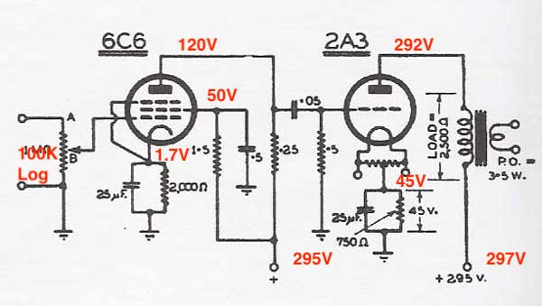

- Radiotron 6C6 - 2A3

OK, I've now breadboarded the Radiotron 6C6 --> 2A3 as originally published and really like it. So much more effortless and musical than the 5842. Not surprisingly, it sounds a bit like the WE91A. Initial impression is that it is very detailed and dynamic, with beautiful tonal development. Lots of drive and sustain. Jazz guitar sounds very fast. One thing I'd like to mention is that the 6C6 has a metal film cathode resistor and tantalum bypass cap. I've got a nicer 2K resistor and a Sprague electrolytic that I'll swap in later just to see if it affects the sound. I'm going to listen to this for about a week.

Hi,That means the SRPP 2nd harmonic distortion only partially cancels the 2A3 2nd harmonic distortion, (or with luck only fully cancels at one particular loudspeaker impedance).
I'm not sure if the highest degree of cancellation will 'sound best' but suspect there will be an 'ideal' value of load impedance to the SRPP, which may or may not be the same thing. Super cool to know that although there are many variables and considerations, all you have to do is turn the pot and listen, what a great hobby 🙂
Cheers
How so? A quick cakc shews that configuration freq response to be down 3 db at 6,4 KHz,Initial impression is that it is very detailed and dynamic, with beautiful tonal development
OK for when the 6C6G was in common use. with AM radio & 78 RPM disc.🙂
How did you do that quick calc?
Approximations (That Work)
Get out your copy of the RCA tube manual that contains the interelectrode capacities of the tubes to be used. In this case we are calculating the 3db down frequency of the interstage network between the 6C6 & the 2A3.
So for the 2A3 the grid-plate capacity is 16.5 pF. The 2A3 input capacity is 7.5 pF. And the output capacity of the 6C6G is 6.5 pF.
To account for Miller Effect of the 2A3, we need to know the 2A3 gain. For a triode power stage, gain depends on the load resistance but for this calc by eyeball I just used G = 3.5. The Miller Capacity is then 3.5 X 16.5 or 57.75 pF.
That all adds up to 71.75 pF, (57.75 + 7.5 + 6.5)pF. Making allowances for strays of wiring capacity conveniently rounds out to ~100 pF. Or 0.1(10^-9) F. All must be driven by the 6C6 load resister of 250K or 0.25( 10^6) Ohms. The Time constant RC is the product of those two numbers, 0.025 seconds. Be careful how you collect the exponents of those numbers. Otherwise crazy results follow.
Stuffing that into the formula for RC frequency 3 db down looks like ~0.16 / RC. The freq response of the circuit is already down 3 db at 6.4 KHz simply thru the interstage coupling. There are still other factors such as the response of the OPT & the input circuit. Looks like the original input Pot has been changed to 100K. That is much better. The lowest drive impedance to the following grid is now 25K when the slider is at mid resistance. But there needs to be a decoupling cap at the input of something like 0.1 microF. 🙂
The 2A3 input capacitance including the Miller Effect capacitance is about 57.75 pF,
just as was stated by jhstewart9.
However, the triple parallel impedance that that 57.75 pF "sees" is:
The very high plate impedance, rp, of the 6C6; the 250k Ohm 6C6 plate load resistor; and the 500k 2A3 g1 resistor to ground.
That makes the -3dB point just a little higher frequency than the 6.4kHz that was stated; but it still falls much lower than 15kHz or 20kHz.

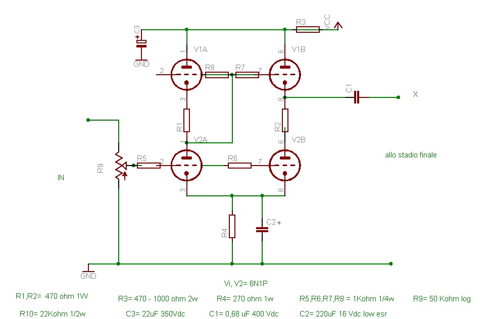

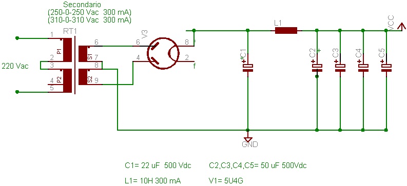

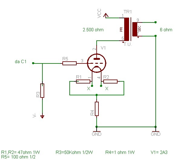

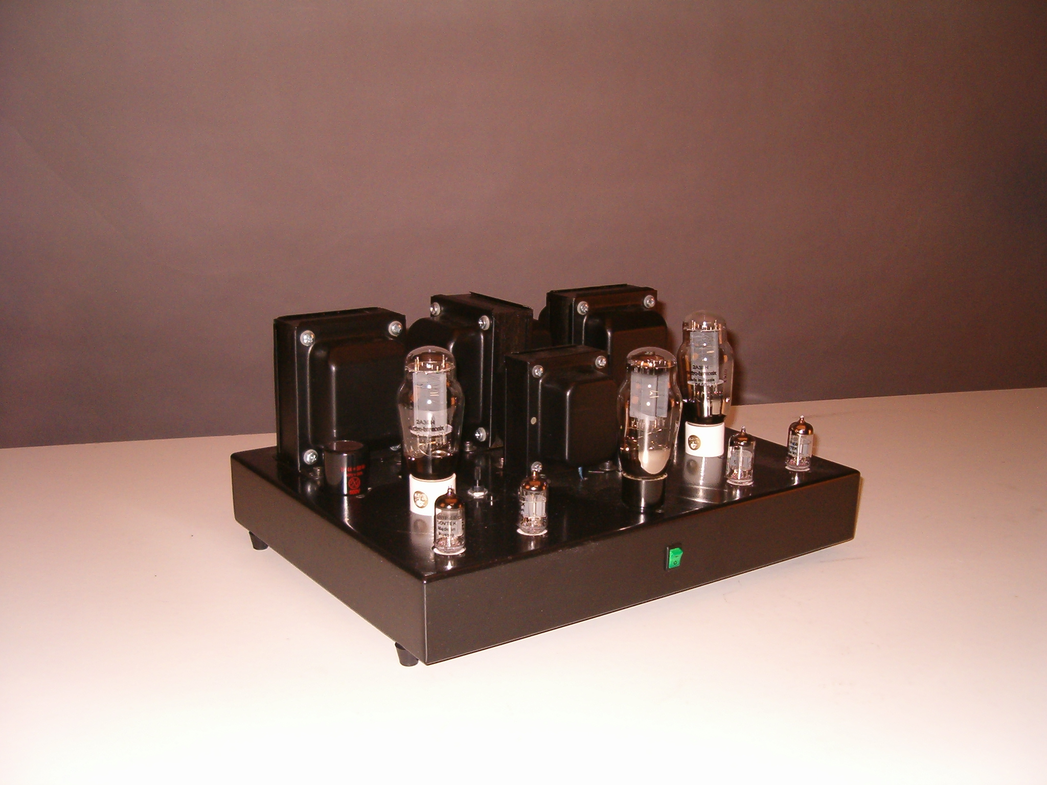

I have done a s.e. 2A3 with Gomes stage with 6N1P
In attach the proto
It is not difficult and works great with the appropriate trafo.
1 volt rms as input signal for 2,5 watt on 8 ohm.
In attach the proto
