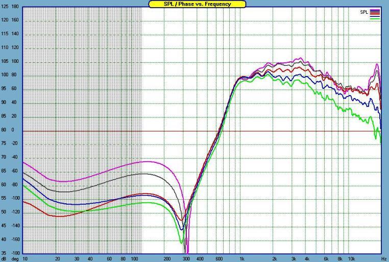

BMS 4552ND + DDS ENG 1-90 Pro

Now THIS is interesting to me. This is a direct quote from Clayton Shaw and EP regarding his new CS1. I am surprised that he is crossing over the BMS unit in the DDS WG at 750 Hz. I am fairly certain that the B&C DE250 can be crossed as low as 800. Now I am really confused. I guess more trial and error/RTA will be needed.
>>For the record, the CS1 incorporates the DDS waveguide and a German made BMS compression unit with neodymium motor assembly. This combination not only sounds very good and smooth, but is more stable at low frequencies (CS1 xover is 750Hz) than most other 1 inch format compression drivers. Its annular diaphram design has a ring radiator layout with twin, concentric voice coils and a mylar diaphram material.
