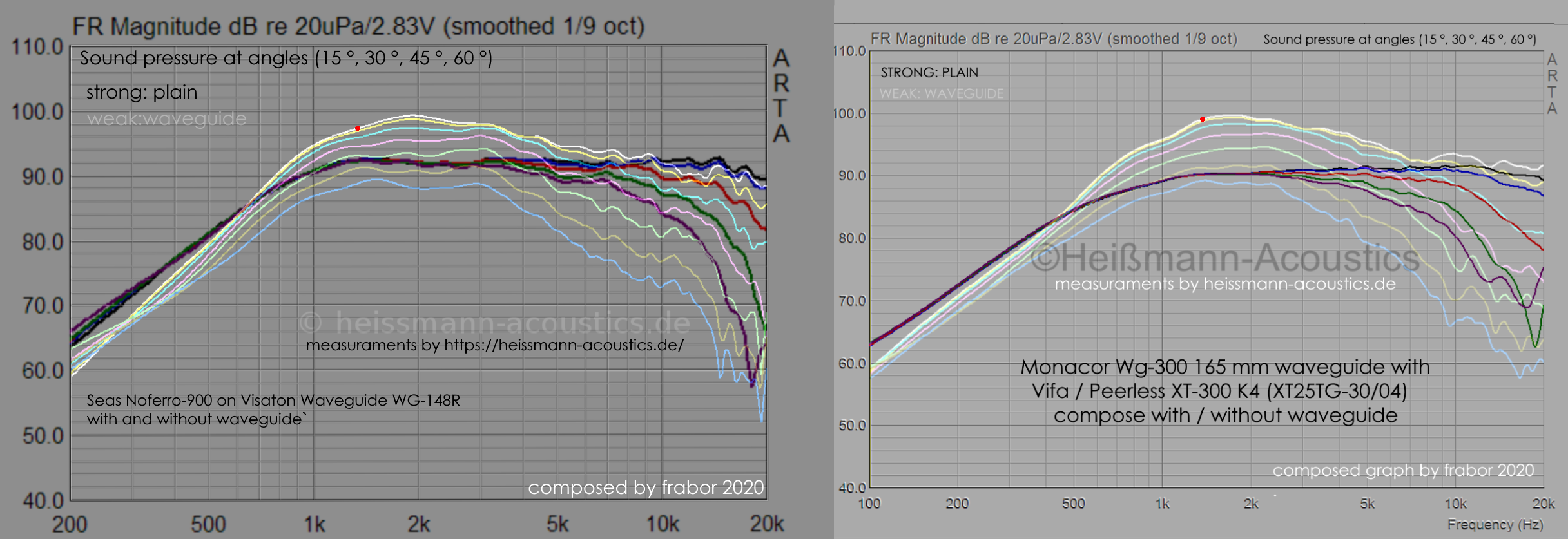

Looking at using one of these two wave-guides, the Monacor W300 and the WG-148R by Vistason. The Vistason has USA distribution (low shipping available now) but the Monacor does not, and the shipping is kind of pricey at this point due to Covid. The driver can be attached directly to the Vistason but you need a 3d printed adapter for the Monacor
I am thinking about a XT19, SB19 or the XT 25.

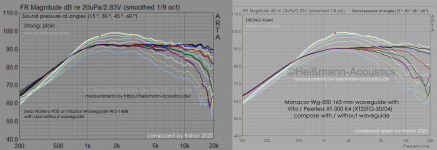

It seems that the Vistason loads at 650Hz while the Monacor at about 450Hz (see attached graphs). Both are done by the same person under similar conditions but they are different tweeters, that is the best compassion I could get to determine the point of loading.
How can I calculate the minimal crossover frequency on the wave-guide ( I am shooting for the vicinity of 1500 Hz)?
Regarding the choice of waveguide, is the Monacor worth waiting for and the extra work of the adapter, or does the Vistason provide the desired frequency point and a good compromise?
Regarding the graph, Sound pressure at angles (15 °, 30 °, 45 °, 60 °)

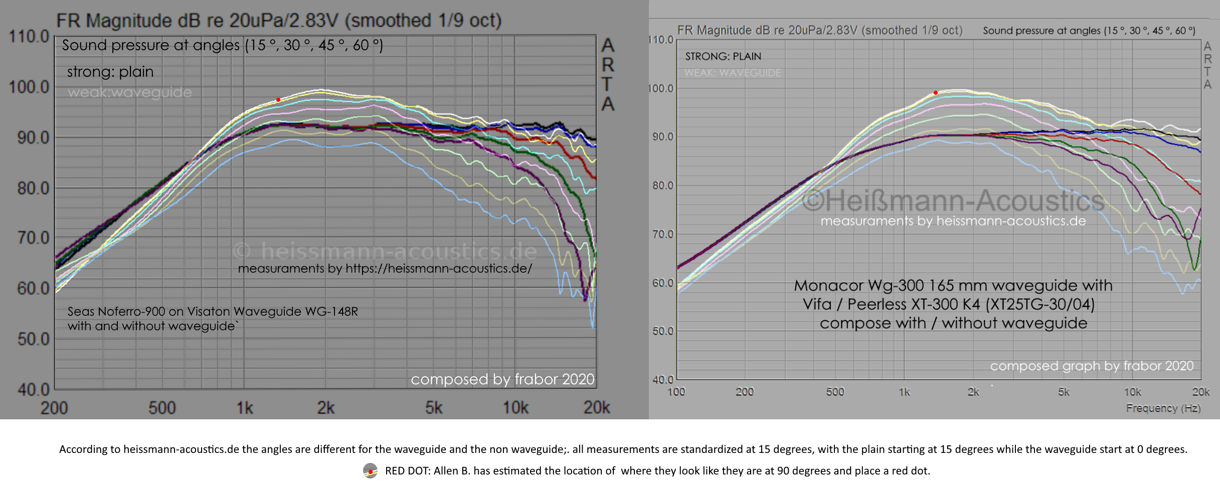

It looks as though the Monocor doesn't work as well close to the driver, however it is generally more narrow than the Visaton, but not by much.

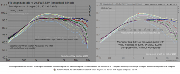

What are the angles shown?
According to the author of the measurements, the angles are different for the waveguide and the non waveguide pots. He states that the all measurements are standardized at 15 degrees, with the plain starting at 15 degrees while the waveguide start at 0 degrees.

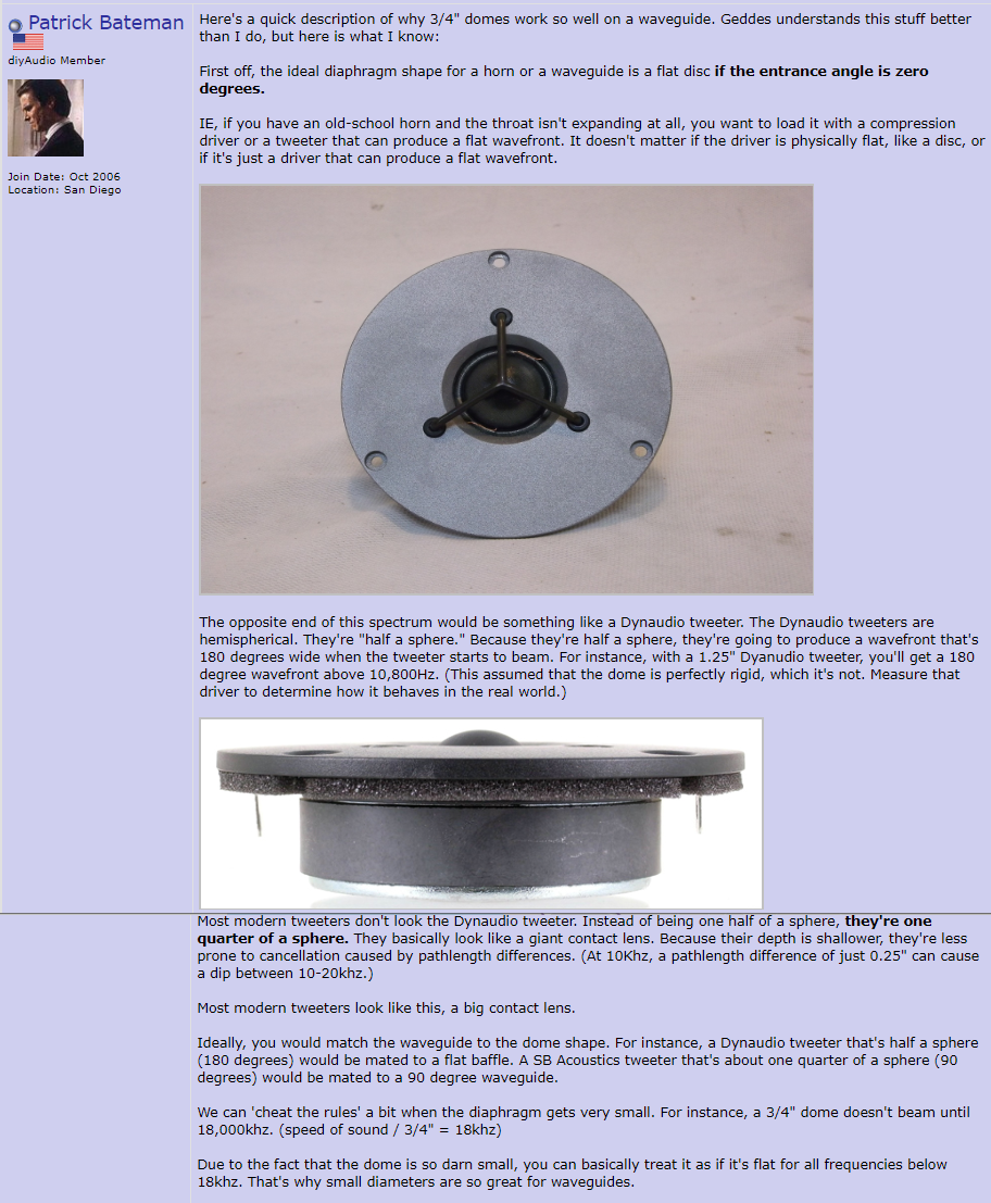

I choose the XT 19 and 25 since there were low cost ring radiators. For what I recall I read in a Patrick Bateman, soft domes and ring radiators work best in waveguides and hard domes do not work so well and 3 / 4” tweeters have some advantages (see attached graph) (I’ll try to look for the post and attach it).

The Wavercor tw030wa11 specs look great, and it has the integrated waveguide that makes life simpler, but less fun for sure. It looks like a great driver and if I am correct is a 1 1/4" soft dome. I rather use a tweeter that is an inch or less to keep the beaming frequency as high as possible, optimally on or above 15Khz. (see prior post for Patrick Bateman explanation of beaming vs diameter).
