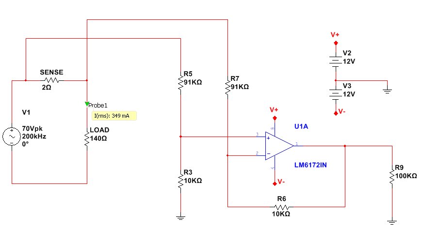

By current transformer you mean wind a transformer with primary on the 1R Sense and secondary with one leg grounded?
from my first post: ' I use Pulse P820X and find it very accurate. ' The lower turns ratio have better wide band frequency response, mainly I use the 1:50 and 1:100. Tons of application notes on current transformers.
