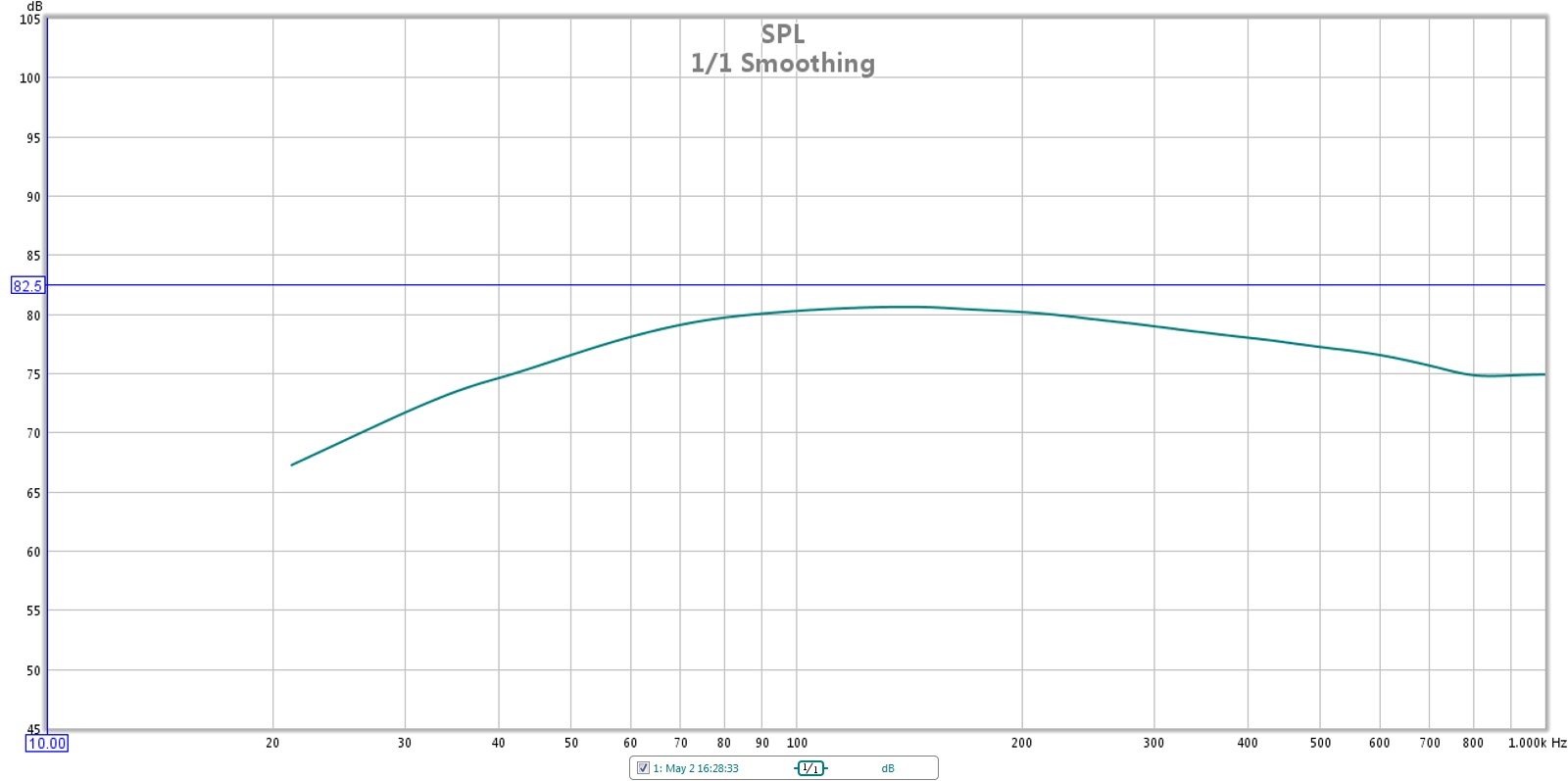

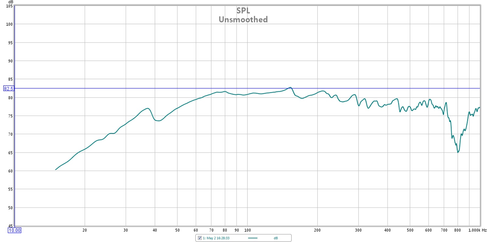

After recently building some sealed subwoofers I would like to determine the F and Q of the system to create a dsp Linkwitz Transform.
Are there any free measurement apps that will give exact figures of the final subwoofers Q and F? I did simulate the build in winisd first but the cones of the woofers had some mass added to them (plasti dip rubber coating) and the box size ended being a bit different (braces).
Can you tell from the graphs accurate F and Q values?
The measurement was taken 1.5 inches from one of the drivers dust caps - that's another thing I am not sure of for a subwoofer with 2 drivers is the dust cap of one the correct place for nearfield measurement or should it be the point on the baffle between the 2 drivers?
Also from the graphs would you say I have too much fill or not enough?

Hi charliecola,
Measure the SPL = SPL1 close to the Cone(~1 cm) at the Box resonance frequency(f(0)) and at a sufficiently higher frequency where the FR begins to flatten out= SPL2, i.e. where the Driver Cone is Mass-controlled.
For your case this ocuurs at ~100-190 Hz using the smoothed FR Curve. The Box System Q is then simply;
Q(0)= 10^(SPL1-SPL2)/20...
.. at the specific frequency = f(0).Enter Q(0) and f(0) into a LT Spreadsheet, specify f(p) and Q(p) to target a new BW.
b🙂
If you take an impedance curve, it would be much easier to determine Fb and Q. However, in the absence of that, BJorno's suggestion should work.
If that raw response curve is a close-miked one, it suggests that you might have a leak in the box (this could be the cause of the "blip" at the low frequency side of the raw response).
REW has built in capability to do an impedance scan. You just need a 100 ohm resistor and some cables from your sound card.

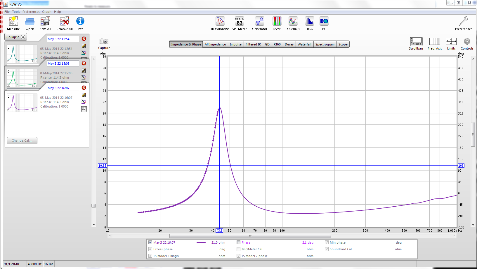

I done an impedance measurement with REW. Is the Fb simply the peak of the curve i.e 44hz? How do I determine Q from this curve?
Do you have a copy of the Loudspeaker Cookbook by Vance Dickason? The process described therein to measure a driver's Q can also be used to determine Qb. It takes longer to explain it than to do it 🙂.
Here's the abbreviated version - Bjorno can check my math and process here:
1. Obtain Re, the driver's DC resistance
2. Obtain Rm, the impedance at Fb, the peak of the impedance curve
3. Calculate r0 = Rm/Re
4. Calculate Rz = (Re*Rm)^0.5
5. Obtain F1 and F2, where R=Rz on the impedance curve
6. Confirm Fb = (F1*F2)^0.5
7. Calculate Qmb = Fb*R0/(F2-F1)
8. Calculate Qeb = Qmb/(r0-1)
9. Calculate Qtc = Qeb*Qmb/(Qeb+Qmb)
Best Regards
If you did the impedance measurement in REW, go to Thiele Small parameters and add some (known) mass to the driver cone and repeat measurement - REW can calculate the Qes, Qms, Qts for you as if it were a bare driver - but now the Q is with the effect of the box. I think that should work (only for sealed alignment as it has one peak only).
