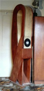

Thought you might be interested in my late in life project. I have always been interested in full range speaker designs. Had built a pair of Voigt Pipes using a pair of at hand Audax HT210A2 full range drivers which I was well pleased with. However, at the age of 72 and with very little woodworking experience I decided to try a pair Of Hedlund Horns and also decided to make the curved parts with laminated 2mm MDF. This has taken me some 2 years and although all construction work is finished I have yet to apply a suitable cosmetic finish, unfortunately my attempt at finishing the curved faces with a veneer (Cherry) did not work out too well. Not having the necessary funds to purchase a pair of Lowthers I fitted the Audax drivers, really really good sounds right through the range, enough well rounded bass right through to top end, but I needed the Audax drivers for the Pipes so decided to experiment with a pair of Jordan JX92S's! The result is exceptionally good, a marked improvement on the Audax. Will try and attach picture.

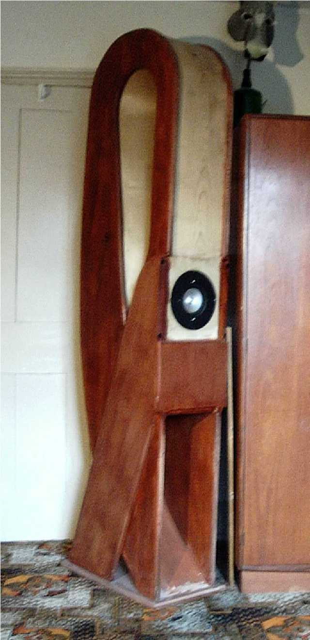

Thought you might like to see the Hedlunds with their new drivers plus an idea of their size in relation to the door!!
Man, some of you guys have a way with wood that I very much envy!! Nice job, and no easy task to build those I'm sure..
Those are some man sized cabs!!, hooray for that and screw that stupid WAF rule lol.. Your wife or girlfriend should be worshiped for letting those puppies hang out in the room!!! If she has a like minded sister, please send her my way 🙂 Good Job!!😎

An old man's follies really. Needed a project a few years ago so got stuck in. Actually the WAF factor not involved as they are in my bedroom/study, that being the only suitably sized space in the house which I could practically use to assemble the brutes,once assembled there they have had to remain being too big and far too heavy to move downstairs. However that works just fine as I spend more of my time in this room now and it is large enough to do justice to the Hedlunds although I suppose a solid floor would be more of an advantage.
