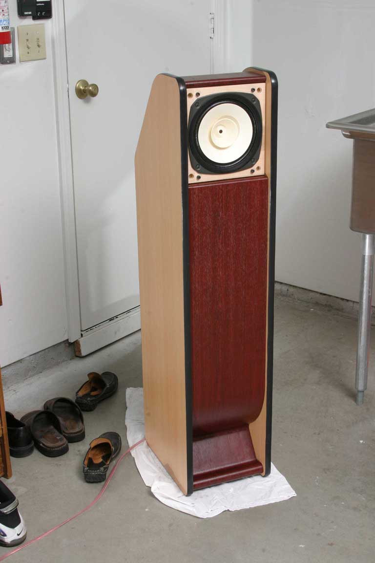

Fostex FE206E folded Horn
This is my second horn that I built. The first one was a modified Mauhorn 12, this one pictured is a cross-breed between a Mauhorn 12 and Buschhorn.... Just finished and sound tested about 1 hour ago; still hard to belive how good it sounds!!!!
Still need to machine out the grill frame
