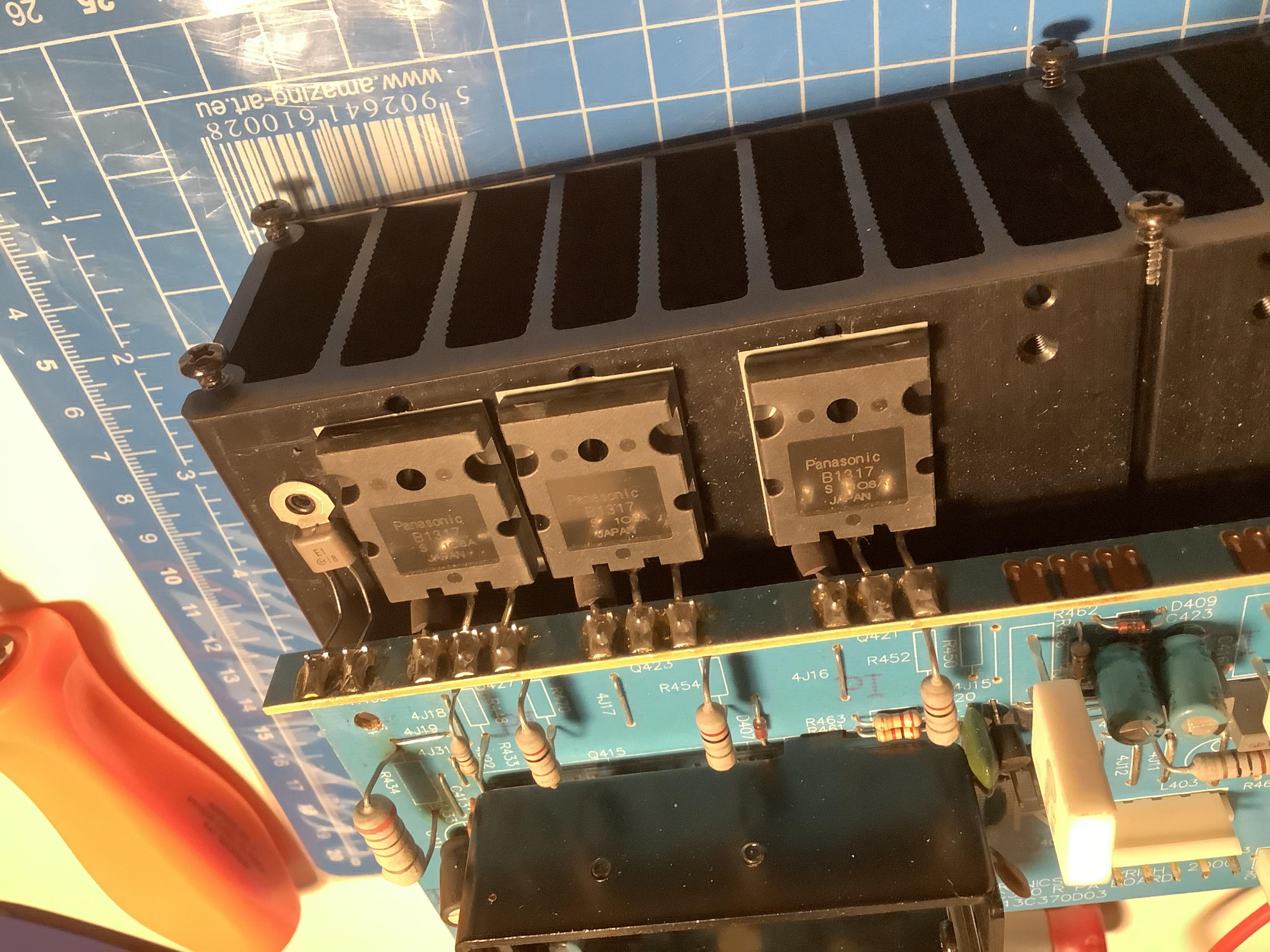

What's a good way to pry these guys off without damaging them? They're stuck - I tried tapping on them left/right/forward/backward but they won't move.
Bonus question, what are the little circles on the leads?

The circles look like ferrite beads.
What is their purpose?
I scrape the transistors off with a knife, or better, a wood chisel. You can hammer the handle gently.

Try to pry off with a 1/2" utility knife AFTER desoldering.
Why do you need to remove them?

The board has a couple of long legged resistors that have started to pull up the trace on the backside of the board so I need to remove it. I thought it would be easier/faster to get the transistors off the heatsink than to desolder and solder again (this is the first amp I'm taking apart). I guess desoldering makes more sense.
Don't play with properly mounted transistors unless you need to.

To add impedance at high frequency to prevent unwanted oscillations.What is their purpose?
Don't unsolder them, just tap repetively (and gently) with a punch from the side , they will eventually release
This is a NAD C370 😉 and I've done loads without damage to the washer or trannys
The ferrites are pointless really. but you don't need to unsolder them anyway if you're just replacing caps, just take the whole board off intact.

Another trick I use to get those transistors off is use a sled bar off a cd mech , remove plate and screw (obviously), then pop the bar in the hole and again tap gently (whilst biasing it to one side with your fingers), two or three taps and the transistor will detach (washer perfectly intact))

You can desolder the legs by bending them. You can test those output transistors in place on heatsink just to find out if they are good. May be they do not need to be detached.
