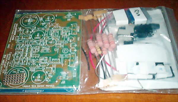

I am still curious about your package Nordic
I am curious....maybe some plastic bags... maybe have used printer to make stamps ....hummmm... some plastic with bubbles... some styrofoam pieces around......i can imagine some
small card boxes with resistances inside not to bent leads...people was impressed... and they are from the country were the best packages born...injected plastic and nice things came from Beautifull United States of America... and they were impressed...so...you have made so good or better than they use to see there...into their homeland.
Also i know your wife use to help you with that stuff...was you or was your wife that made the excelent package people have commented?

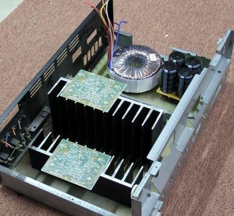

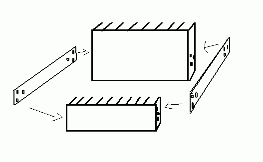

Hey there, just getting going on my amp now that the snazzy boards are here.
Check out the attached pic, will be using a 330VA (dual 25AC Secondaries) transformer, 4x 15,000 uF 63V caps and ... what do you think about the heatsinks?
The big one is 8.25 W x 2.5 thick x 5 high (inches)
The smaller one is 8.25W x 2.5 thick x 2.5 high (inches).
To me, the big one looks way to big and the small one seems a little small. But only 2 output transistors per channel it would seem that the small ones would be fine or could I scale this up?
What do you all think?
EDIT- FYI, the case is an old Onkyo TX-2500 Mk. II receiver that I saved from the dump.
If you gonna use heatsinks the way you show..inside the case
I have checked, and heatsinks are perfect to the work they will have.
The bigger one will be good to hold a 100 watts RMS amplifier, continuous power, sinusoidal wave.
The smaller one around 60 watts RMS amplifier, continuous power, sinusoidal wave.
If you put them together, using two aluminium plates fixing them together and distributing the heat (not very well.. have delay and will depend of how big is the aluminium bridge contact area)...maybe 140 watts or a little bit more.
I am talking as output power, not power consumption,
Your amplifier will produce around 40 watts RMS over 8 ohms.... the total power will be 80 watts of audio power.... and your heatsink will be able to hold amplifiers till 140 watts of audio power.... so...you will be happy with them if use 8 or even 4 ohms loads.
