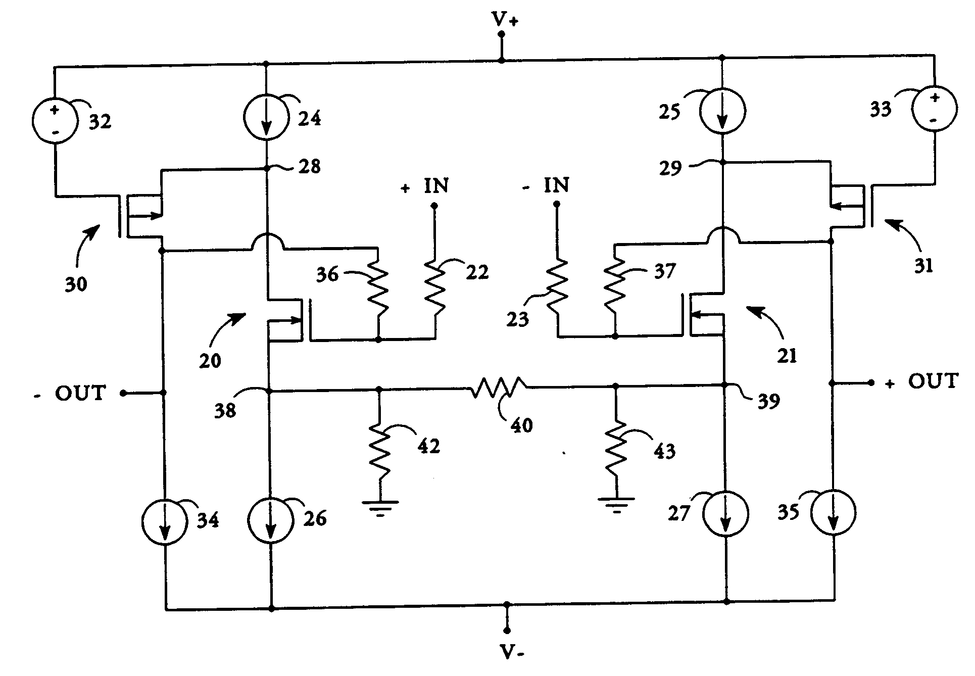

It's a simple enough idea, easily explained with a hand waving argument,
and easily seen in sims. The mechanism is that each half of a balanced
amp can amplify errors on the other side in-phase, cancelling them.

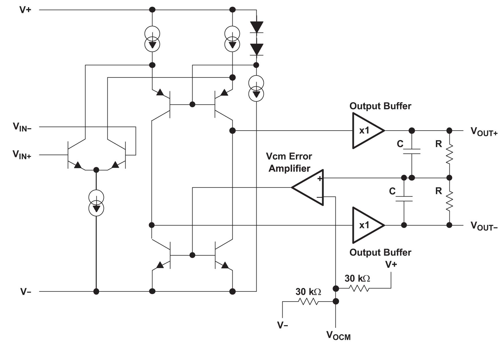

just download datasheet for OPA1632 and read
you can take it as two inverted opamps , interconnected
member Wensan had few interesting threads , regarding (regular) OPamps in SUSY configurations

Here's the first patent drawing and the simplified OPA1632. You may recall
that TI licensed the patent.
