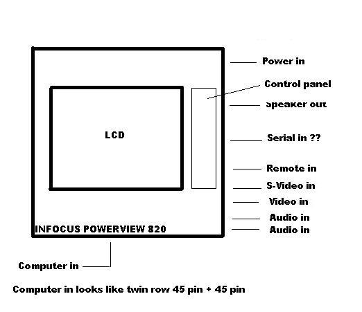

I got my panels today. 2 820's and one 950. Turns out one 820 came with a full set of accessories, including one of those CableWizards.
The place where I suppose the RCA and s-video jacks would be on some 820's is blank on both of mine... anyone know if this was an option for these models?
Anyhow, I hooked up the VGA from my PC's GeForce2 Ti to the Mac side of the CableWizard and got a picture. The Mac VGA input on the device is a 3-row plug, and the output is a 2 row. The PC side is exactly reversed. (Is this the way it generally was back then? I can't remember...)
I didn't realize that the panel-end plug where the CableWizard attaches is not even a standard plu - or is it? Not a standard VGA plug, anyhow. Is there somewhere I can order this plug so I can build myself a bastard cable? How much does one of those CableWizards cost?

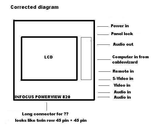

Side port
I'll be damned, there is a port hidden away there on the side! What plugs in there? Certainly nothing I've got!
The place that has the RCA and s-video jacks is *empty* on both my 820's - something I didn't expect. When I lift up the plastic cover (I'd call it a "delete" plate) there is literally nothing there - just a gaping hole. I must have got the bare-bones model 820's 🙁 Ah well it's OK, those ports probably wouldn't have done me any good anyway due to macrovision.
I'm talking about the CableWizard port - that's the one I think is a IEEE 1284 port. That's where I'm thinking I'm going to get my VGA in...

Remp... exactly what mine is like *minus* any video or audio inputs!
I really wonder what that long side connector is for.
But above all, all I want is standard VGA video to my panel, I don't care about anything else.
So I'm on a mission to build that 3-row DB15 to IEEE 1284 "C" converter cable.

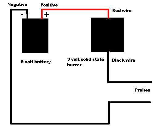

Regarding using a voltmeter and a battery to get pinout this will work also but there are a couple of things.
You do not say what voltage the meter will read.
Whatever voltage it says on the meter that is the voltage battery to use. Do not go over the meter voltage or the pointer will bend.
Lets say your voltmeter is a 20 volt meter. If you use a 1.5 volt battery the meter will only move a little bit. A 9 volt battery will make the meter move to about half way while 18 volts (2 9 volt batteries in series) will move the meter almost to full scale
There is a far better way than using a battery and a voltmeter.
Buy one of those 9 volt solid state buzzers from your local radio spares place, (about $1) connect up a 9 volt battery. then when you complete the circuit the buzzer will buzz. Saves taking your eyes off the meter probes.
If you want me to help you get the pinouts email me. Saves hogging the forum. When its done we can post the finished results.
