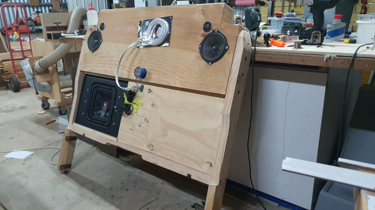

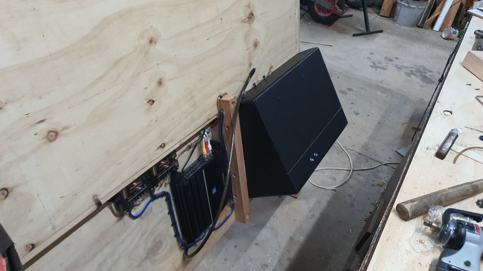

Just for a laugh I've attached some pictures of this contraption set up that's going into my work van(Im a Handyman), it fits behind the safety cage barrier and sections off the cab from the back... greatly reduces the size of the Airconditioned space(its 42°C here currently)and keeps the noise of me tools banging about at bay!
And yes reminds me of my childhood headboard on my old bed!
Reactions: DontHertzMe and GM

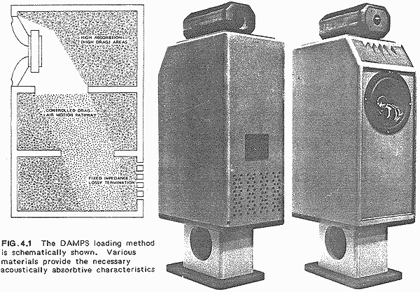

Or use the standard aperiodic formula, build as large a box as you can live with and then make it aperiodic.
Let's take a 15 litre (approximately 0.5 cu ft) enclosure as an example.
To convert this otherwise sealed enclosure to aperiodic loading, you can drill a 5 x 5 array of 12 mm (0.5") holes in the rear of the enclosure.
The centres of the holes shall be 20 mm (0.75") apart and be covered internally with soft, felt like cloth to provide extra acoustic resistance.
With this design, only the internal walls of the enclosure (excluding the front and back) should be lined with absorbent material.

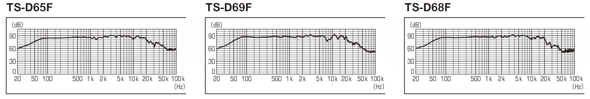

Unfortunately, those drivers' infinite baffle performance won't translate into good sound from desktop boxes.
Car door is ~40 l leaky sealed enclosure. This kind of auto speakers have weak motor with typical Qts of 0.8-1.5 and resonance frequency of 50-70 Hz. Perfectly adequate for inteded use case, perfectly inadequate for small box.
(note the extra-wide 120 dB vertical scale)

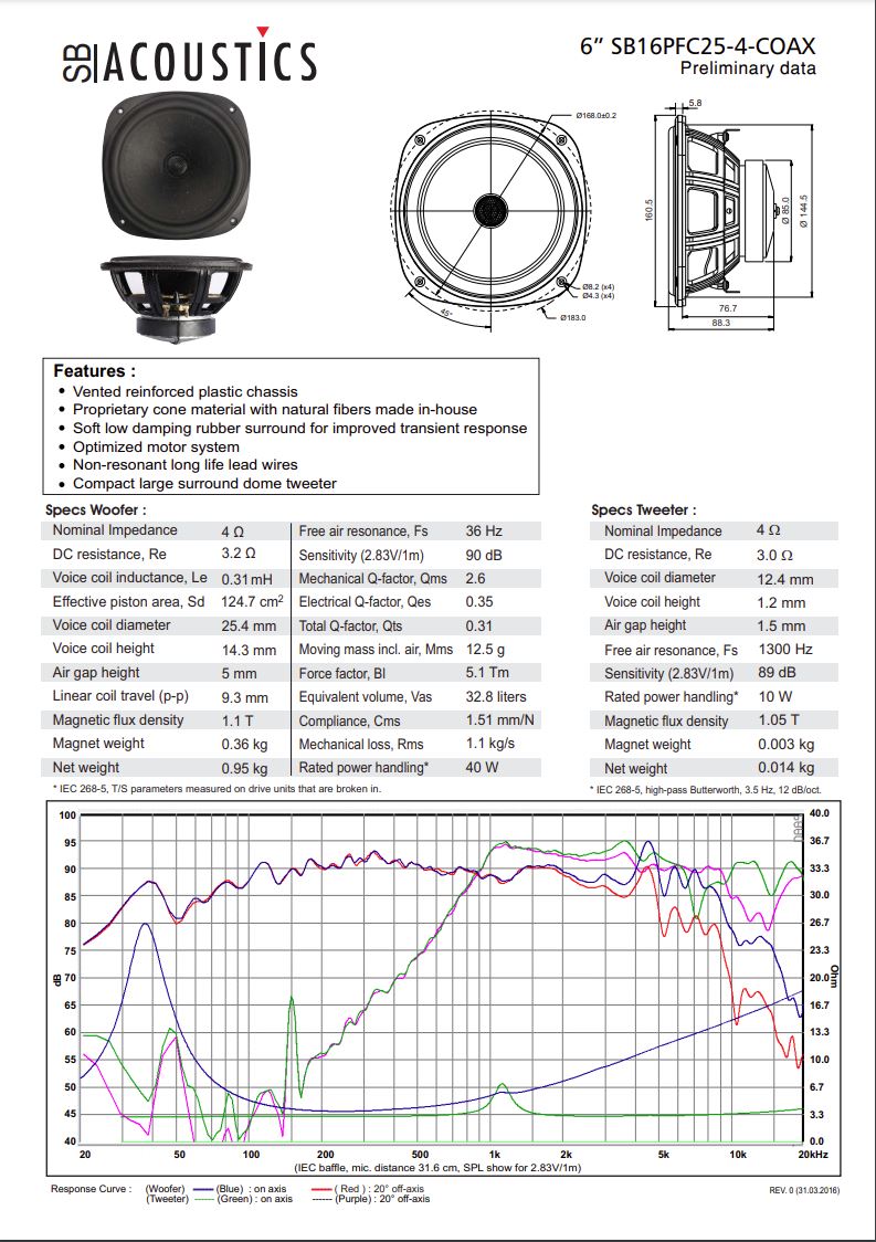

I would suggest coaxials intended for small boxes - Tang Band W6-2313 or 2314, KEF Uni-Q (can be bought separately new or used), SB Acoustics SB16PFC25 and so on.
