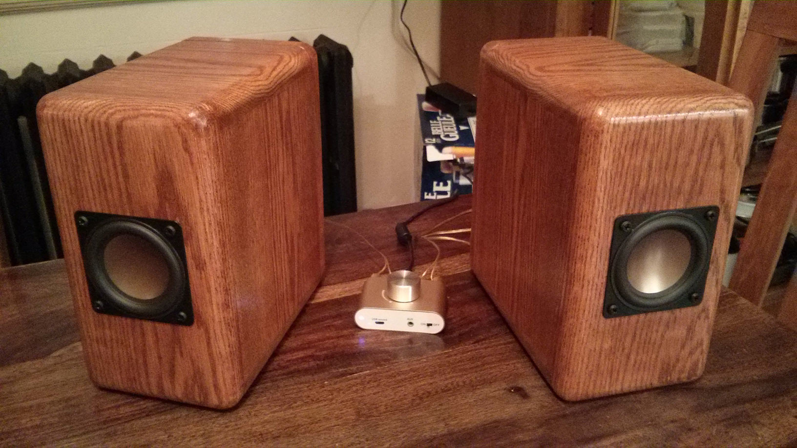

In the meantime, here is a picture of one of the two pairs of Zaph Hi-Vi I did some years ago for my daughters if anyone is interested. Built of solid maple. They are very satisfied with these! The sound is surprisingly good.
