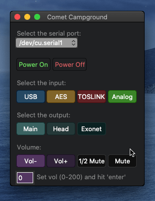

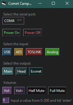

Turns out you can control the DAC via the serial port! Using a USB-to-serial adapter cable, I wrote an app that interfaces with Comet! Written in Python since it’s what I’m familiar with. It’s a simple button-based GUI app that currently allows you to select which COM port to use, power on/off, select input and output, mute/half-mute/unmute, increase/decrease volume, or enter a specific volume value. All through the desktop app!

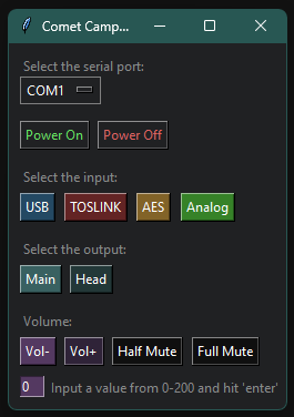

Finished the desktop app! 😀 It's more or less feature complete depending on the DAC firmware version (some don't have 'Mute' control available: to unmute, simply press one of the volume buttons).
The app is written in python and made stand-alone with 'pyinstaller'. No need to install anything, simply unzip the folder and open the 'CometCampground.exe' (I thought the name was fun). It should automatically choose the right COM port: If not, it can be clicked to show a list. To use it, you'll need this cable (non-affiliate link): https://www.amazon.com/dp/B07J3XS7DQ?psc=1&ref=ppx_yo2ov_dt_b_product_details

Thanks @Forane12 ! I hope they like it! Important update - that version of the app is borked: I didn't include the app icon in the distributable! After I did so, it triggered Windows Defender. Oof. So instead I kept it one simple executable file and signed it with a Windows Security certificate so it shouldn't trigger your antivirus. First run takes a second but after that it's quick.

Update: 4/6/2023
Waiting on more case parts. Order got pushed back a month 😕 In the meantime, Mac app is ready to test! Mac OS is... not my favorite haha.
