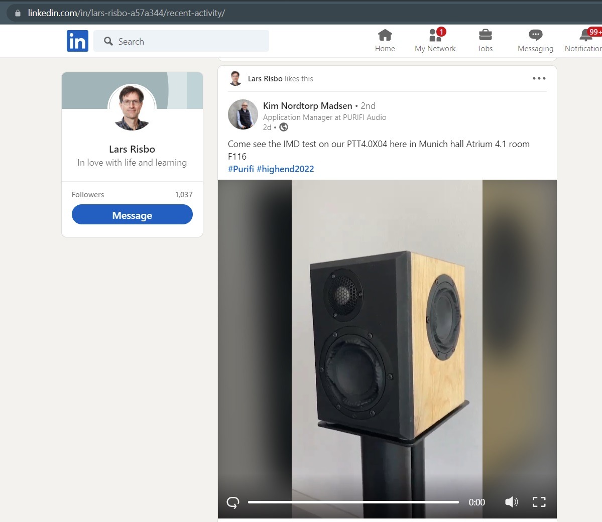

I have heard them and talked to @lrisbo it was great. Cheers Lars! You explained drivers to me in a way even I understood.At High End 2022 in Munich Purifi demo'ed spk8 a design using the PTT4.0W woofer and matching PRs. The application note should be posted soon. If you have Linkedin checkout this video and watch the drivers dance at Xmax.
They were doing an impressive test with a large 10Hz sine put over the music. The modulation was going on and off. There was no difference in the tone when drivers were going really hard. It was crazy impressive.
