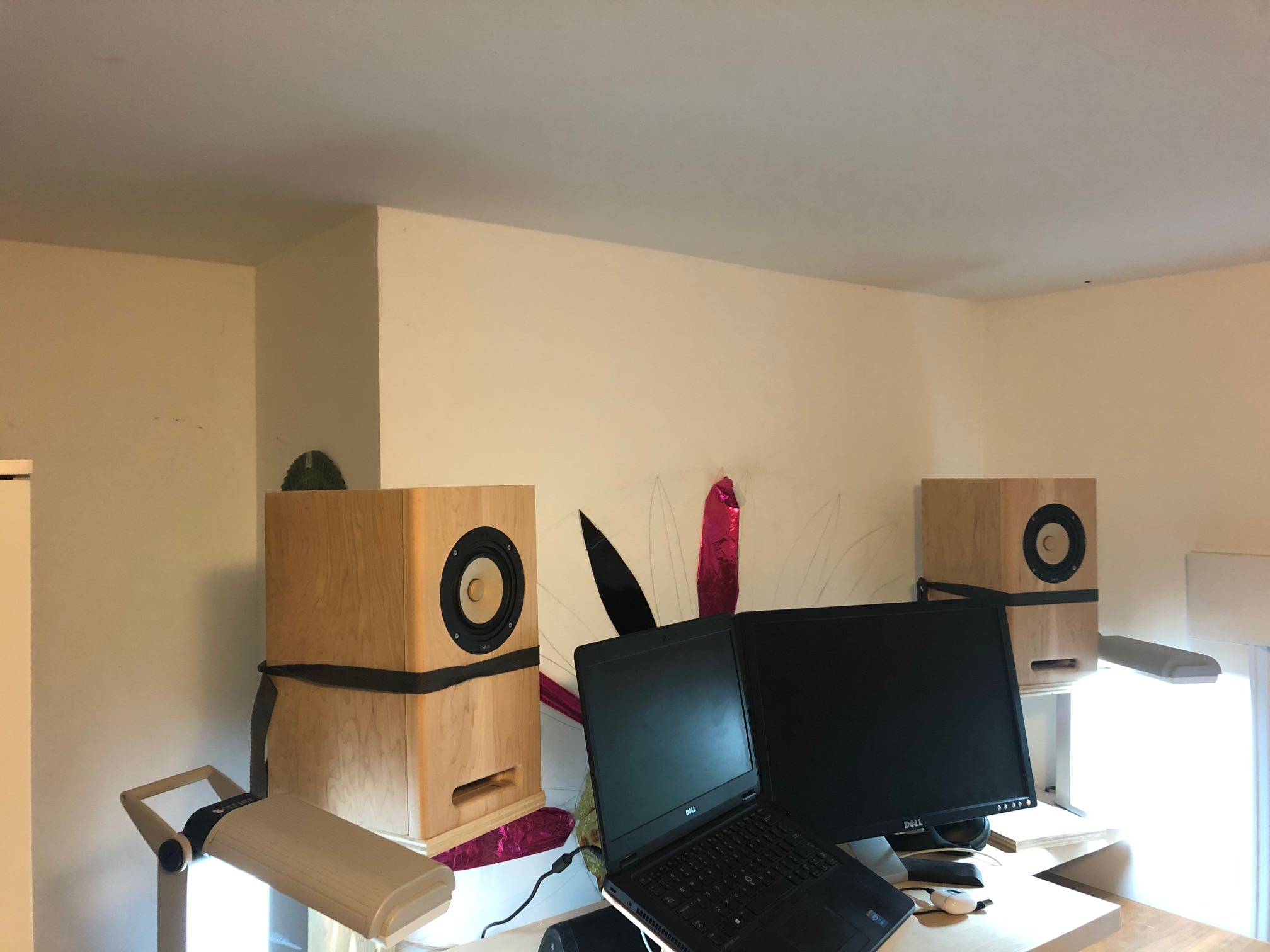

A quick update:
The drivers arrived. I've built the boxes. I decided to stick with the bass reflex design instead of the golden ratio version of the enclosure due to the smaller size.
I am still waiting on the damping material, so the boxes are empty and not sealed. Even so, the sound is quite nice. Looking forward to getting them sealed up. My first experience with a FR speaker. Also provides nice audio for all those video meetings! Not sure if I will stain the wood or leave them natural before applying a finish. When I get them done, I'll post another update.
