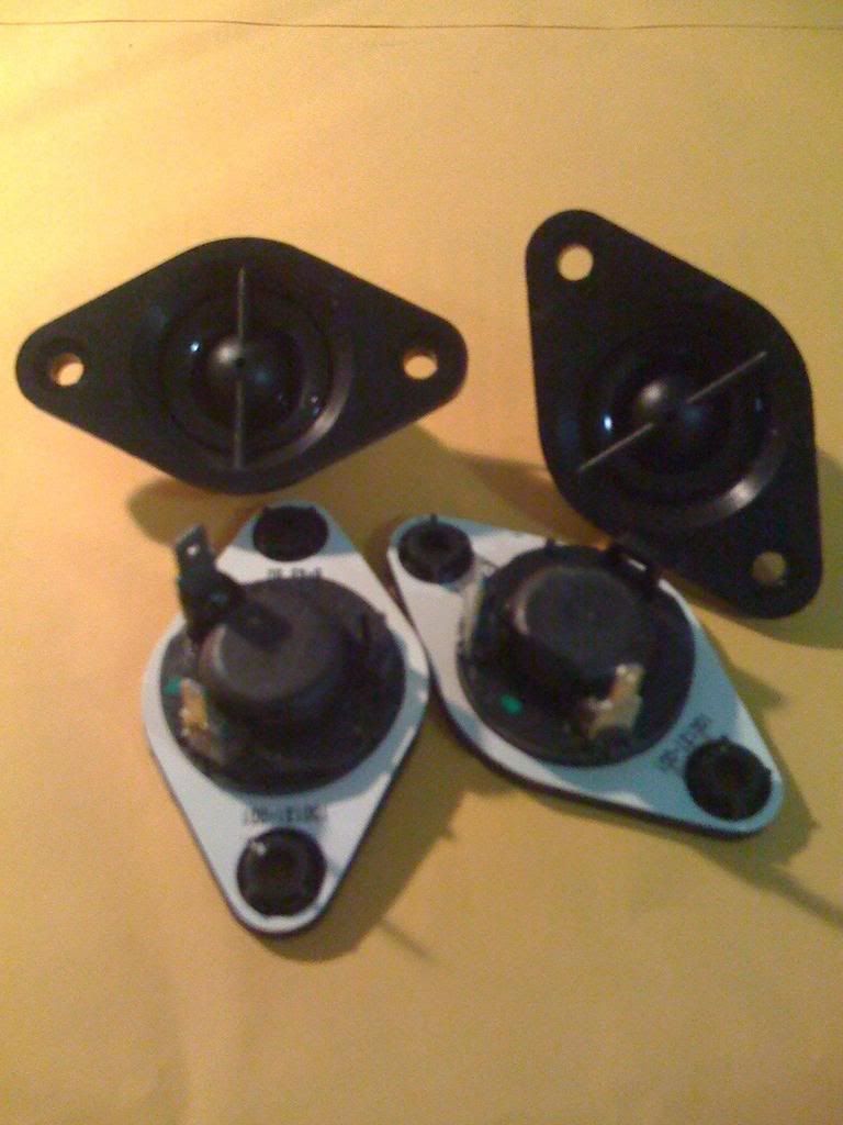

These just arrived.
Brisso57 dropped 'em in my mailbox for next to nothing!! I'm one step closer to my Desktop OB.
I love the kind folks of this forum

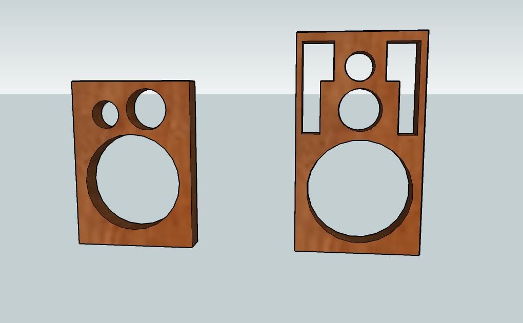

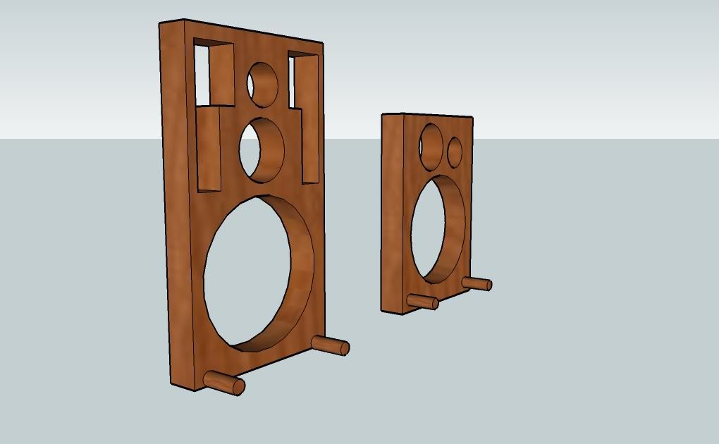

The baffles I'm considering are:
The one on left would save me some space, but the driver positioning would not conform to the OB rule of thumb of baffle = 2* cone dia. The one on the right conforms, but would be a bit larger.
Comments please!!

merajsalek,
in my opinion the left baffle is compromised because mid and tweeter are side by side - resulting in severe off-axis response dips in the x-over region.
The right baffle would not really conform to the baffle = 2* cone rule IMHO. The outer "framework" would allow some nice additional edge diffraction 😱
All in all I would question the rationale behind a 4way system for a desktop OB. But that´s just a personal view.
Rudolf
Rudolf
Hi Rudolf,
Thank you for your comments. I'd put the frames because I want [read GAF] a rectangular speaker on the desk to complement the decor. I intend to cover the baffle permanently in grill cloth - a la Hawthorne solo/duet.

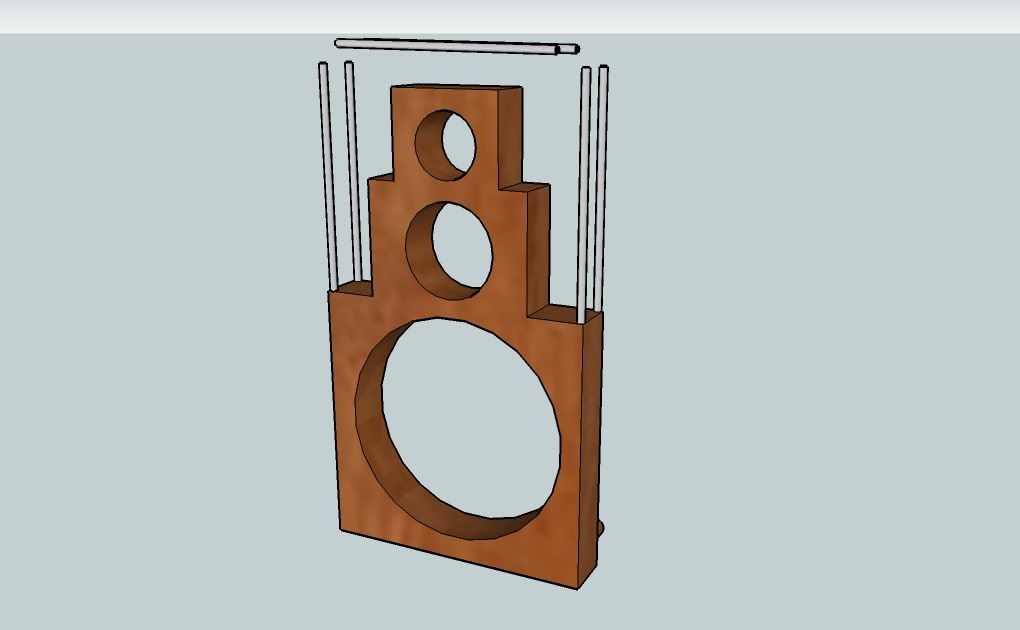

How about replacing the wooden frame with thin acrylic or metal tubing? My skills in Google Sketch is still sub-par, the floating tubes on the top are meant to be connected to the ones on the side...
The rational behind a 4-way Desktop OB was the size of my starving student wallet, the drivers I can afford pretty much decided it for me...

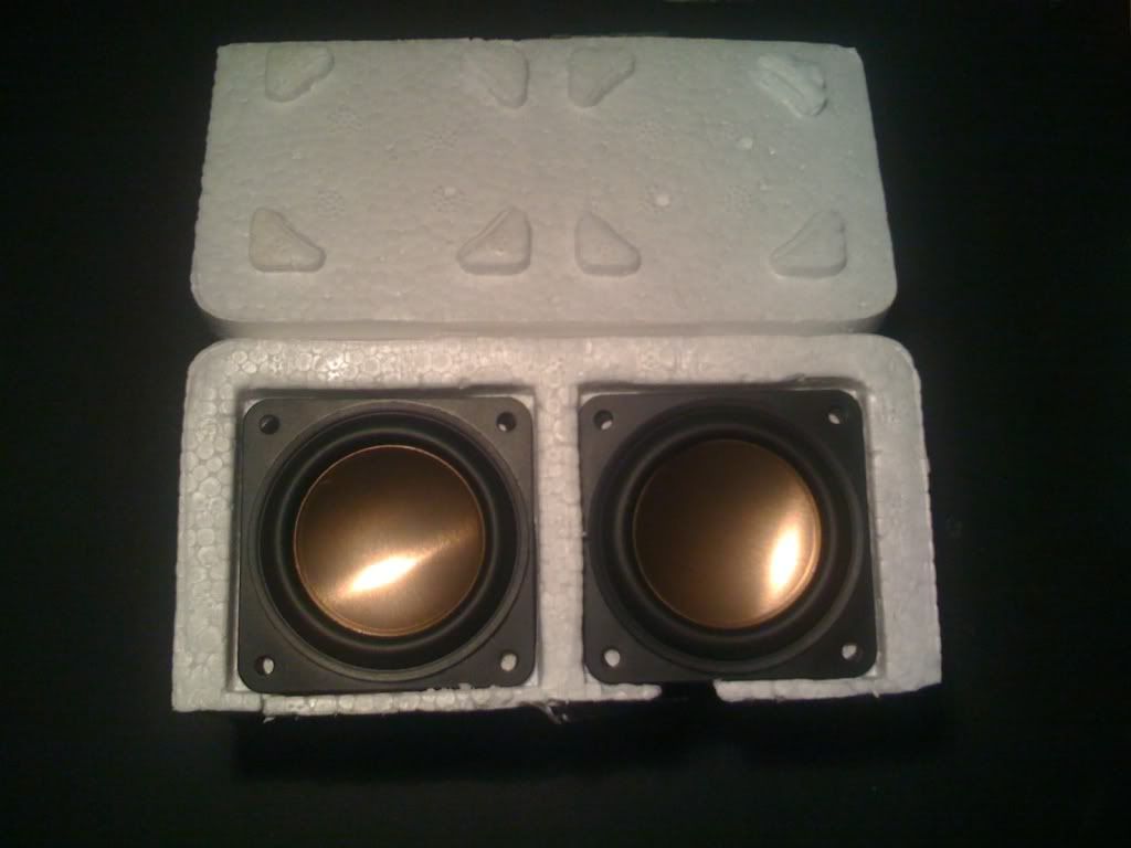

Hey Andi,
Did a very rudimentary listening test on the B2S's. Hooked em up to a 1875 GC and had a listen.... I'm happy with the B2S's so far, Dido sounded nice 🙂
I have a feeling they'd do quite well in the range I have in mind (1.5KHz-5KHz).
I'll be building a mock-up baffle to see (hear) how the drivers sound together and maybe take some measurements as well....
Hope to report back soon
The rational behind a 4-way Desktop OB was the size of my starving student wallet, the drivers I can afford pretty much decided it for me...![]()
Funny rationale behind that ... getting complicated because of shortage of funds. I will use that the next time my wife asks, why I can´t build speakers like anybody else does 😀
But joking apart - does one really have to follow the double cone diameter rule with a desktop speaker? You have got a fixed listening position in the nearfield with side wall reflections far away. You need only concern the front wall reflection IMHO, and that could be minimised by a proper toe-in of the baffles.
So I would use a full size baffle and push the drivers to the (inner) baffle edge until I get flat response on the listening axis.

Yes, I mean an arrangement like shown in your picture. If you need linearity only in one direction, you could linearize to that side. Change the mikrophone position in EDGE to the proper angle and move the drivers to the best position. That is probably to the inside edge of the baffle, but you could try the outside edge too. That way the speaker response to your listening position will behave like that of a narrow baffle (which you want), but perhaps without the steep EQ a real narrow baffle will request.
I was not aware that you are going full active. So the number of ways will be no severe problem indeed.
1.5-2 kHz looks life the critical point in any "narrow baffle dipole" concept. My midrange driver needs a certain baffle width to support 500 Hz at the low end. Almost every tweeter that will feel comfortable above 10 kHz will start from at least 2 kHz. So I have to compromise and let the midrange work into its beaming area a bit.
