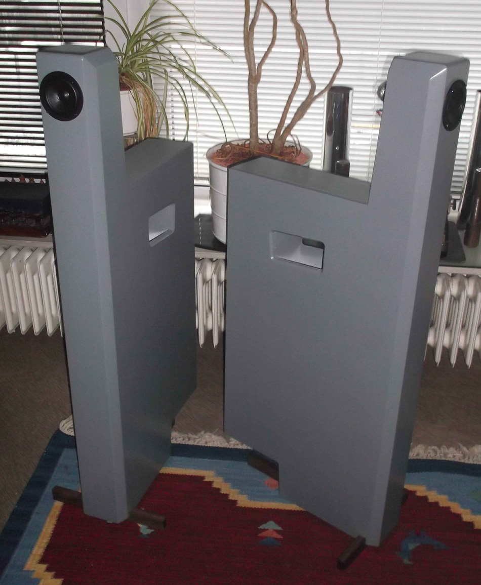

You can't go wrong with the 0.4x Karlsonator. Many happy builds with this one.
http://www.diyaudio.com/forums/full-range/239338-mini-karlsonator-0-53x-dual-tc9fds.html
Thank you for being the guinea pig build for the XKi with the FR83- sorry that did not work out. This one with the TC9 has been built with success at least a dozen times if not more. Folks unanimously praise how good it sounds.

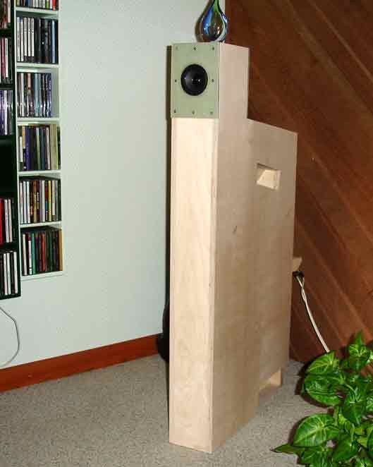

anyone build it from plywood?, also somewhat leery about the inexact science of front "curtain", meaning the exact measurement of how it should be made.
Look in the thread, probably more plywood than FC builds. The Karlson aperture is indeed dimensioned out in the drawings by Blaides.
Depending on your woodworking skills.
The mini karlsonators are very cute and would make nice presents.

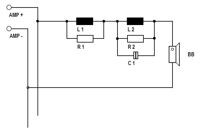

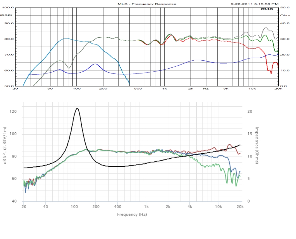

Does the TC9FD need a crossover? The first attachment is a crossover suggested by a German kit manufacturer. The second attachment are frequency response curves. The top curve is the kit manufacturer's measured response in their enclosure with their crossover. The bottom response curve is from Vifa's spec sheet.
The TC9FD is already inefficient. Why would I want to suck more out of it with a crossover that doesn't appear to offer anything?
You can use each fullrange driver without crossover BUT that doesn't mean that the resulting sound is pleasing 🙂
I don't have experience with the TC9FD but if you can tell me the source of the crossover picture i may can help you with the design goals of the designer.
Personally, I would not use a crossover with this driver. I tilt it to get the sound I like best. In the case of the TC9 I prefer it without any tilt. To my ears, adding a tweeter improves the sound of this driver.

Looks like the "crossover" is a filter that corrects for baffle step loss and includes a notch filter. Probably needed to sound it's best in the enclosure.
The translation is funny to read ��
The kit is designed for nearfield audio, so you will hear if the speaker are "shouting" at specific frequencies. Maybe thats the reason why they are using the filter for flattening the range between ~1.5kHz-4kHz. It is only some db in the upper midrange so probably for desktop use it was a bit too much...
It offers BSC, and yes, the driver sounds significantly better with the filter in place for fullrange applications without active EQ.
Don't get those two measurements confused... the one in the Vifa datasheet is measured on a standard IEC baffle, as one would expect for a datasheet measurement. The measurement provided in the German paper is measured in free space (presumably) mounted in the actual enclosure. Given how narrow the enclosure is, one would expect a 6dB drop in freespace for frequencies below about 3500Hz.
Here are my own measurements in an anechoic chamber, measured in free space with the BV filter in place:

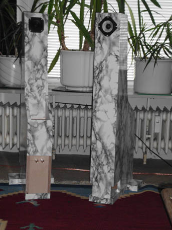

And here are a picture of the boxes as they were measured:
http://www.diyaudio.com/forums/clubs-events/223294-diy-ottawa-winter-2013-a-15.html#post3453876
http://www.diyaudio.com/forums/clubs-events/223294-diy-ottawa-winter-2013-a-21.html#post3467439

If you plan to run these full range without active EQ, then the filter is definitely recommended. If you have active EQ, it is not needed.
As for tweeters, they are definitely not needed with these drivers if you're listening on-axis. See the measurements which show response up to 18kHz on-axis. I prefer them slightly off axis, but I can't hear above 15kHz.
