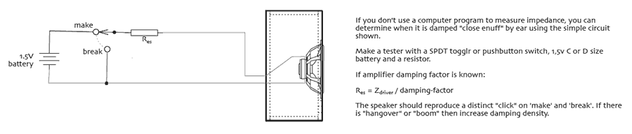

Any speaker alignment can work near/at a wall or in a corner, just need to critically damp them 'in situ’.

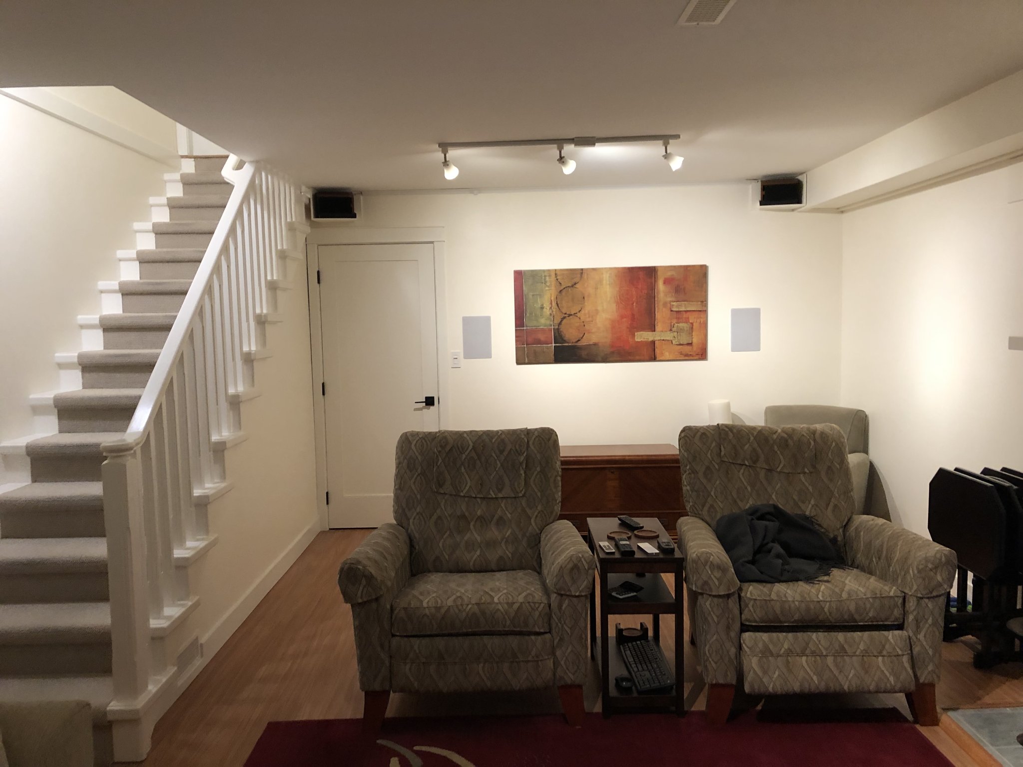

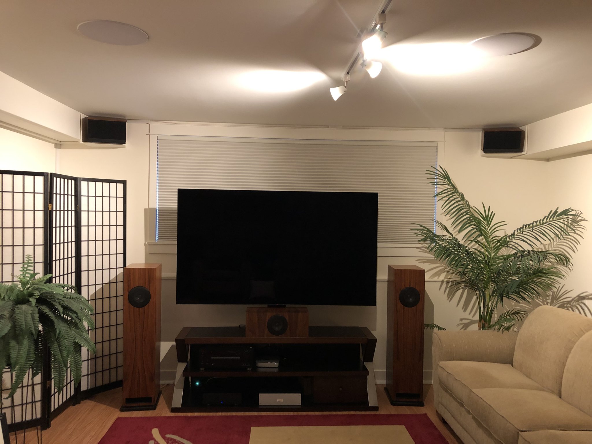

I wouldn’t exactly say ‘buried’ - it’s sitting on the top shelf of an open equipment rack. The only configuration that works in the ground level room has a wide picture window on the front wall, but a motorized pleated blackout curtain deals with light, and of course wall mounting any of the equipment is out of the question.
Room is approx 16’W x 26’ L x 8’H, main viewing position @ 12ft from screen.
Few of us have the luxury of an optimized dedicated room, so we make the best of what we have to work with*
Just finished installing a cheapie pair of Monoprice 6” 2-ways in the rear wall, which along with a miniDSP 2x4HD for time alignment and PEQ of dual subs achieves a nice little 7.2.4 rig. Enjoyed the hell out of the last couple of episodes of Apple TV+ Foundation S2. When Atmos is mixed well, the effects are very immersive.
* edit : picture of rear wall showing the staircase and passage way door exactly where you wouldn’t want them.
