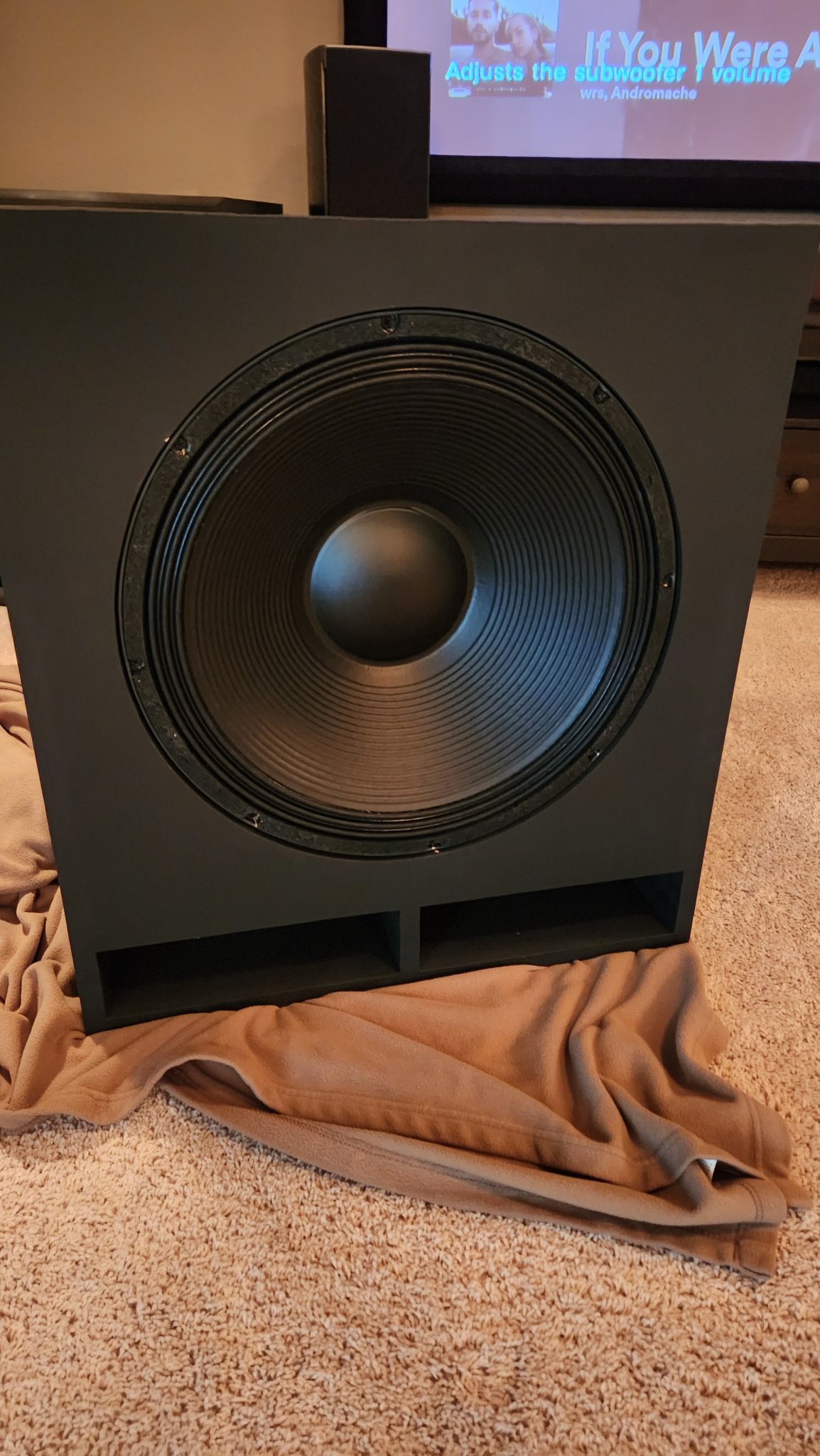

Hello. I recently build a subwoofer with 18in la voce. Thinking of using it for a party and do not want to risk damaging my speakers. Was wondering if there is a post showing how to build a simple and loud 2 way speaker. Since i do not have a big amplifier it should be efficient. Wanted to try a horn loaded tweeter mid and a big woofer arohnd 10". Any suggestions?

About the question on high pass. I have a receiver where i know i can highpass for stereo and i have an amp with sub output denon pma n600 which not sure if it has hp probably not.
Here is a photo of the sub i built.

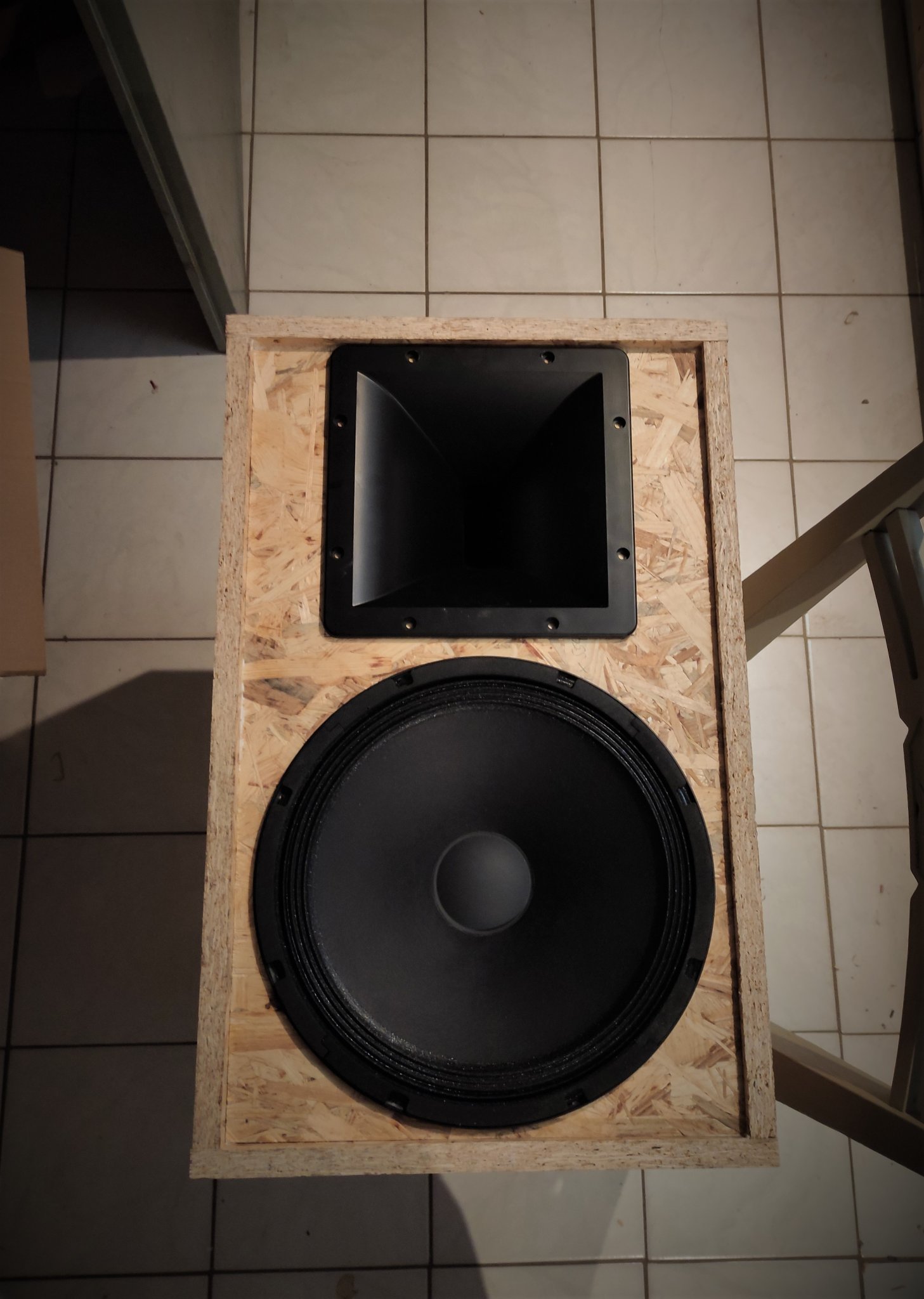

However, the Asathor was developed as a concept without a subwoofer. In combination with an 18" subwoofer, real tops would probably be much more suitable.
I have something in development at the moment with a Beyma 12CMV2 and a RCF CD350 on the SB Audience Horn 225, which is as good as finished. That costs about the same, should be able to play with high pass at least as loud and is much smaller.
