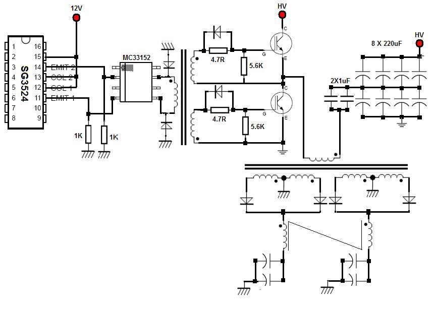

I have a problem with secondary side PSU.
1. How to supply a startup bias power to my PWM IC? I don't want to use 50hz small transformer.
2. Also this PSU have dual output 30V and 12V. How to compensating the feedback loop in dual output PSU? No optocoupler is needed.

You may wish to investigate how it is done in computer power supplies. AT style ones had a self oscillating primary side, over which the control circuit had to take control once it had some power in order to work. ATX style ones use a small auxiliary flyback converter as they have also to provide 5V standby power.
Check out Supertex and Siliconix... they have some interesting bootstrap supplies with PWM options. Supertex has cool high voltage DMOS fets that are handy as well.

Eva, I cannot use the gate driver in ATX PSU.
It will be use to drive IGBT (SGW15N06)
I think it is better to build a new gate drive transformer.
The core is EPCOS B64290-L45-X830
ALnh=4300
NP = 10
NS1 = 10
NS2 = 10
Please see attached picture. Will this work?

Get a SMPS based Cell phone charger...trace the circuit around the secondary of switching trf..most have centertapped secondary get power from the ends connect 1 amp fast rec diode bridge (or 4 x BA157) leave out the center tap ..have to replace the filter capacitor..this works very well gives out 12 to 16 volts loosely regulated o/p WITH ISOLATION.
